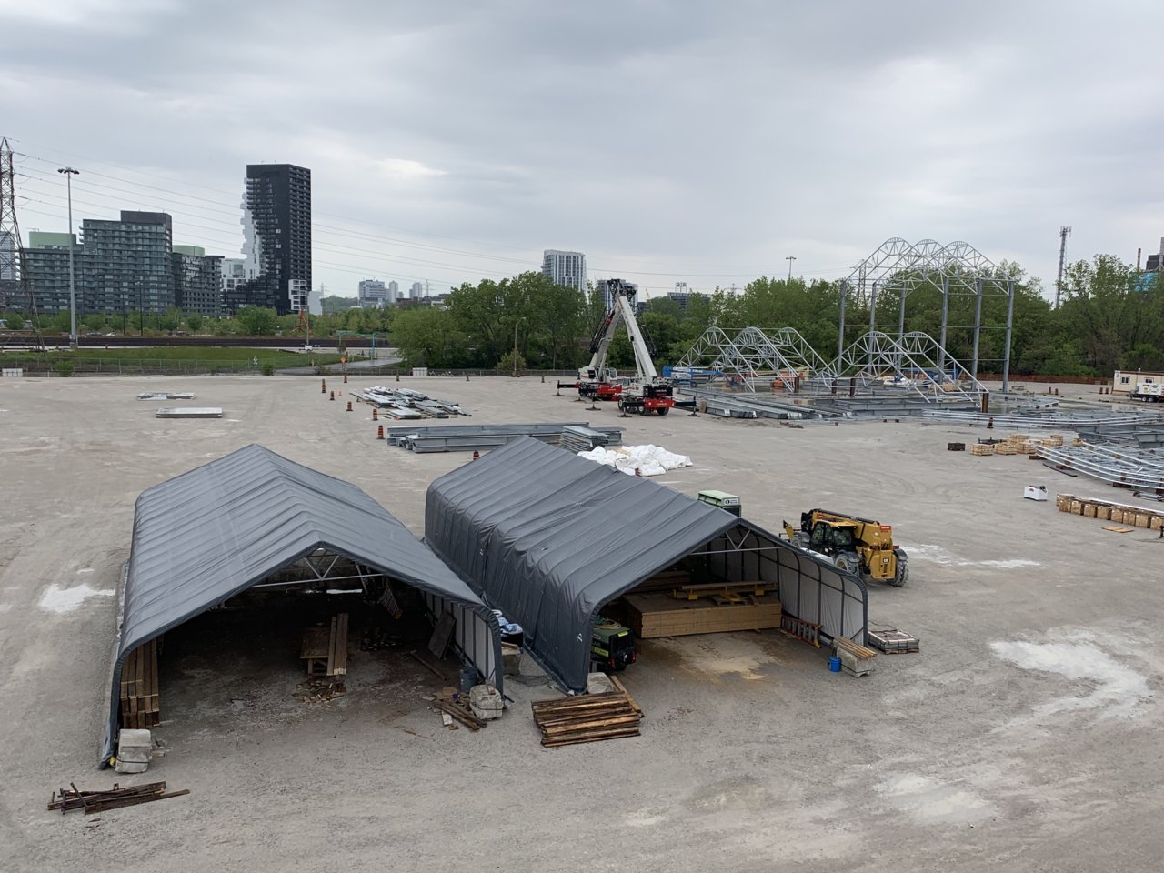

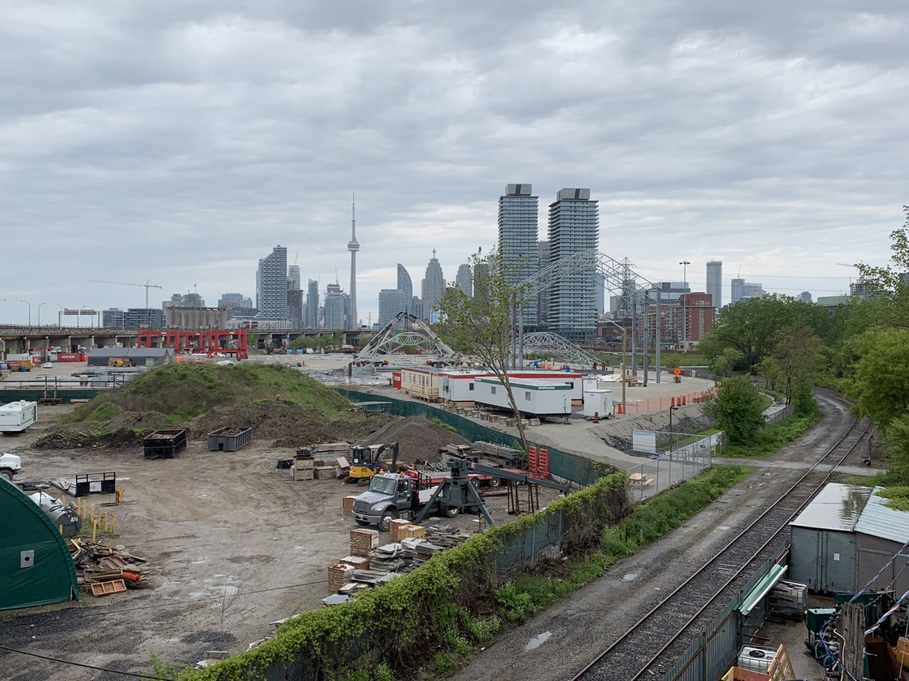

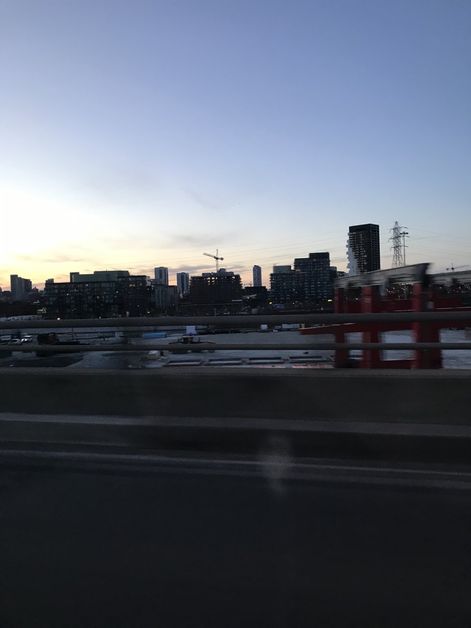

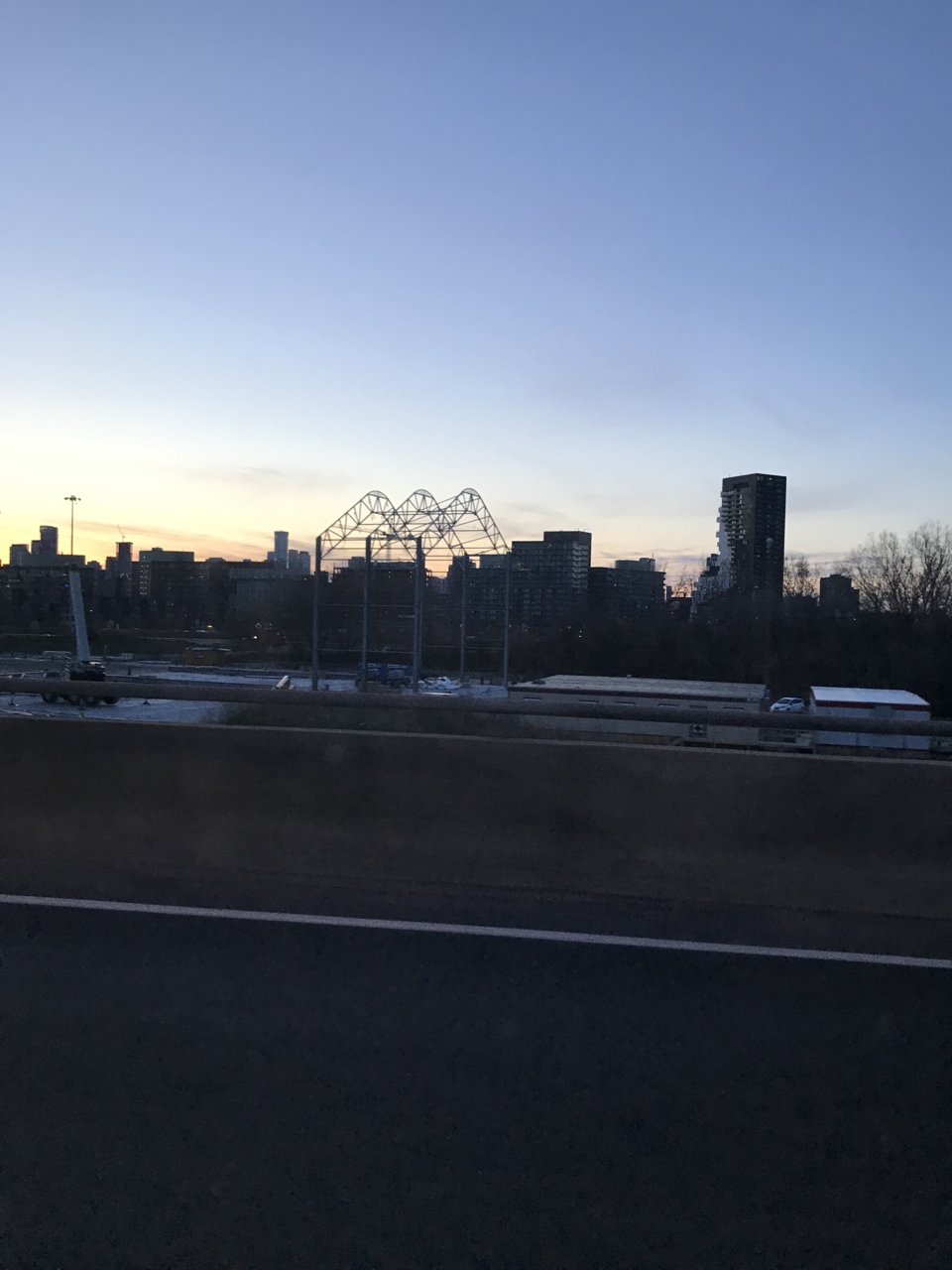

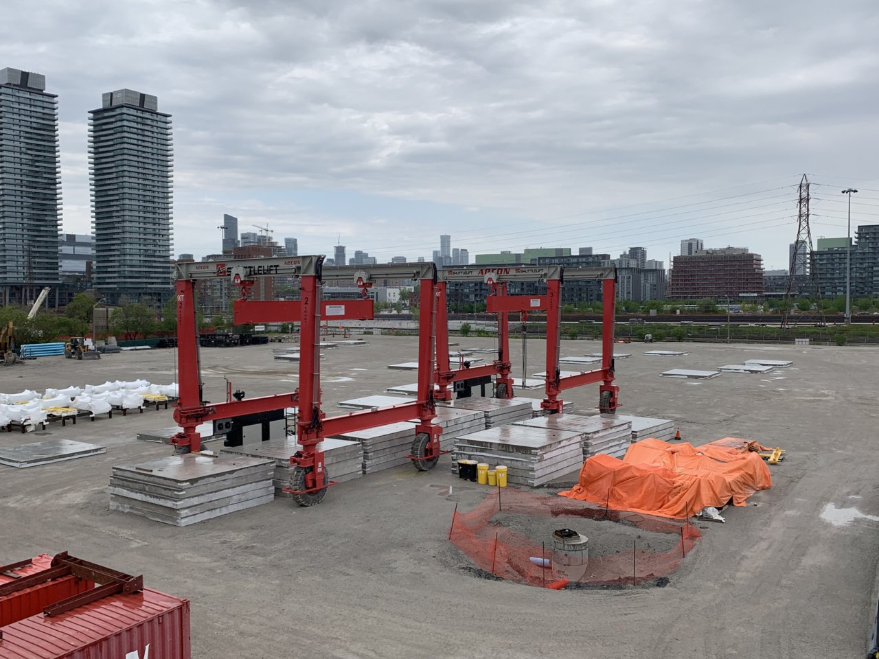

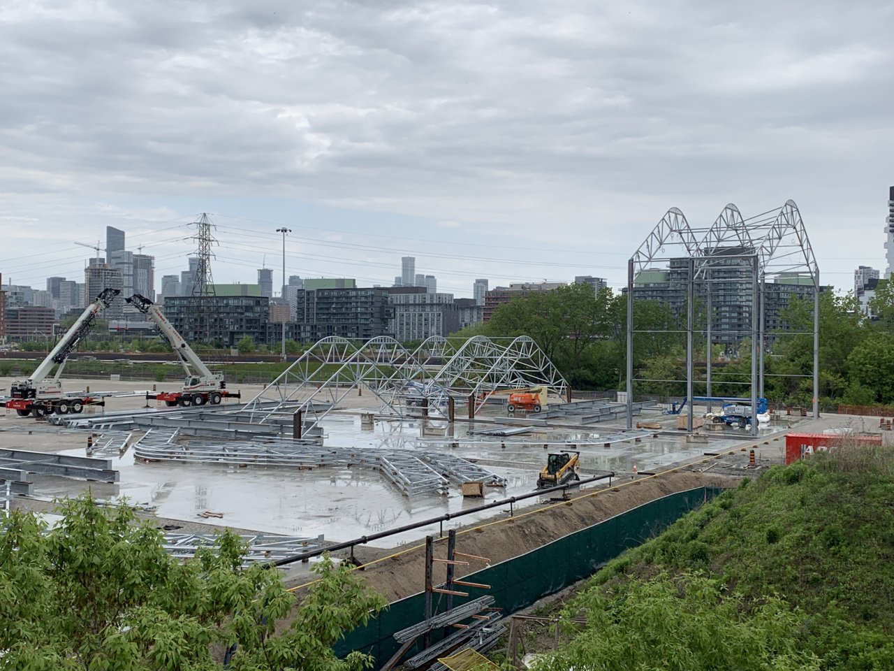

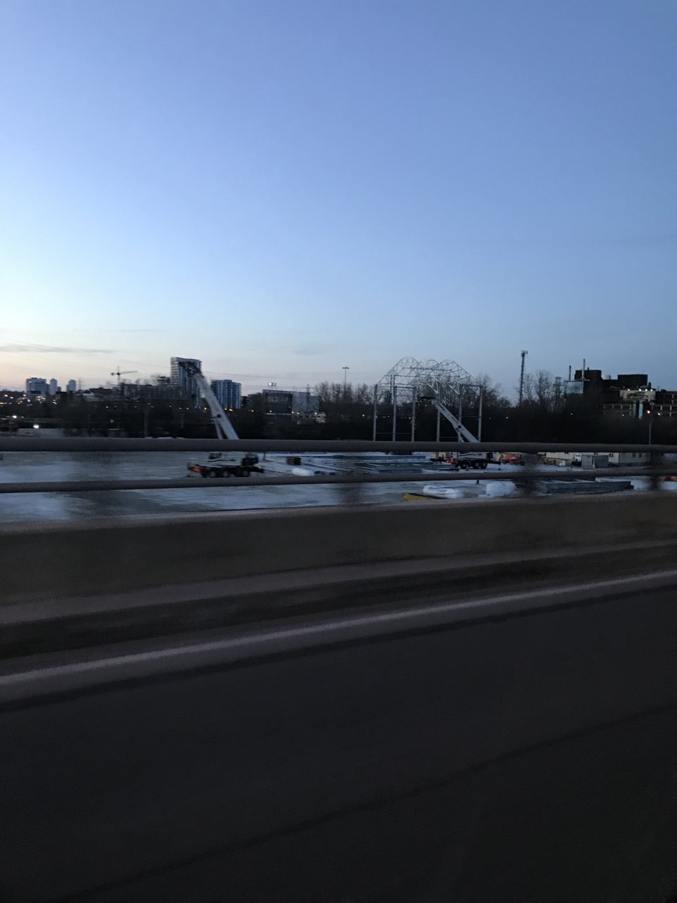

Update from today. Sorry, the pictures aren't great, I grabbed them last minute (I was a passenger in the car, don't worry). Looks like they're erecting a massive assembly hall or something like that.

The materials representing a truly horrendous waste of time, energy, money, and resources.
Wasn't it established already that the above works are for Enbridge line replacement, as opposed to Gardiner replacement?
Those slabs look more suited to Gardiner repairs than gas line replacement. The gas lines are just being trenched into the ground and backfilled. The Gardiner rehab requires prefab concrete panels to replace the decking.
The Gardiner replacement is still a while away. This is just the deck replacement for the portion that will remain in place (from west of Cherry Street) - similar to the work that occurred on the western portion a few years back.
The scope of work for Contract No. 18ECS-TI-01GE involves replacing the 1.1 kilometres of concrete deck and girders of the Expressway between Jarvis Street and Cherry Street, replacing the westbound off-ramp at Sherbourne Street and the eastbound on-ramp at Jarvis Street, rehabilitating the westbound off-ramp leading to Yonge, Bay and York Streets, and installing new street lighting along the Expressway and ramps. Construction is planned to commence in the Fall of 2018 and be completed by the end of 2020
I guess I could've also just gone to the previous page instead of trying to look up the details. This picture specifies its for the Gardiner.
Nah, your explanation is great and provided some much needed answers. I see this giant sarcophagus forming, and that it's simply to repair the existing expwy and has little to do with the rejigging is news to me. Will have to rectify what I've been telling people.
