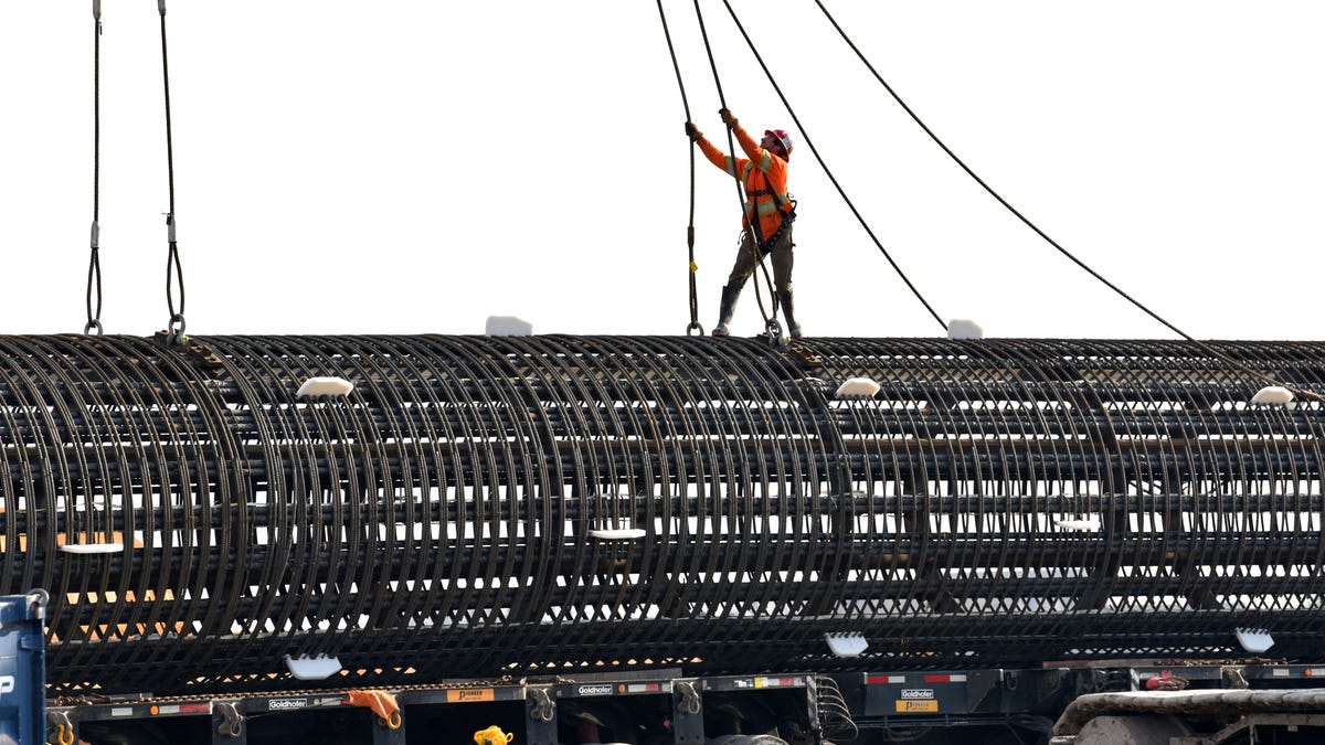

The overpass that will extend the 401 over the Ojibway Parkway to the Canadian Port of Entry.
Source: https://www.gordiehoweinternationalbridge.com/en/gallery?type=1#photos
That thing is so ridiculously over built.. There is 0 need for that to be a single span. Why not a small span over Ojibway Parkway, another small span over the railway, and embankments everywhere else?
Planning for the future. Surprised myself how long that bridge is.
Provision for widening the existing Ojibway Parkway 4 lanes to 6 lanes as well a future road beside the RR tracks on both sides of it.
It's probably because of the heavy freight traffic that will likely use the bridge. Might reduce maintenance costs by reducing the number of pins and other connections long term. Still a mystery to me though.
  • There will be a road going under the west span where the yellow crane is.
  • The west pier (where the blue bucket truck is) is roughly on the property line.
  • The soil is very compressible and there were big concerns that any settlement leading to dipping of the rail track would lead to litigation. Thus, no embankments (which add weight and cause settlement) where allowed anywhere near the railway right-of-way.
  • There are a tonne of underground gas and electric line under the Ojibway span, and a pier in the median of Ojibway was not allowed - which forced it to be that long.
Highway infrastructure here in Windsor needs to be overbuilt. We have tons of trucks passing through on the 401 every day. The Herb Gray Parkway (401 extension to the new bridge) infrastructure was super overbuilt so it would last a while with minimal need for repairs, as any significant repairs would involve slowing the bridge traffic down. They're also building newer infrastructure here in consideration to potential growth in both population and commerce.
