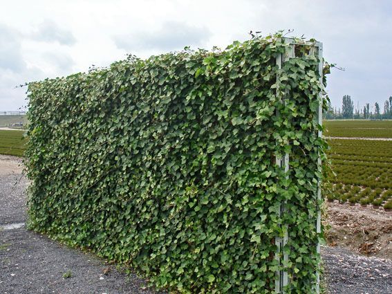

I agree that noise is a problem, but the valley is wide and state-of-the-art 20-foot sound walls can do a lot of good. There are places in the valley 50m+ away from the DVP where it isn't bad, and it can be improved a lot. Noise from Bayview can also be reduced with 4-foot walls. Queens park will never have noise walls. I grew up near the I-95 corridor in Palm Beach Gardens, in South Florida, and since substantial sound walls were added 20 years ago, it is a dramatic improvement for people living along, so I don't think we should give up here. It isn't lipstick on a pig.
If noise walls in the Don Valley are necessary, they should opt for something like this instead of the typical ugly ones.
