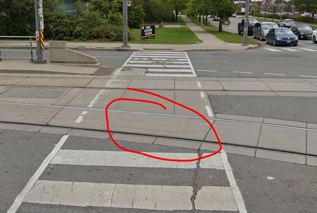

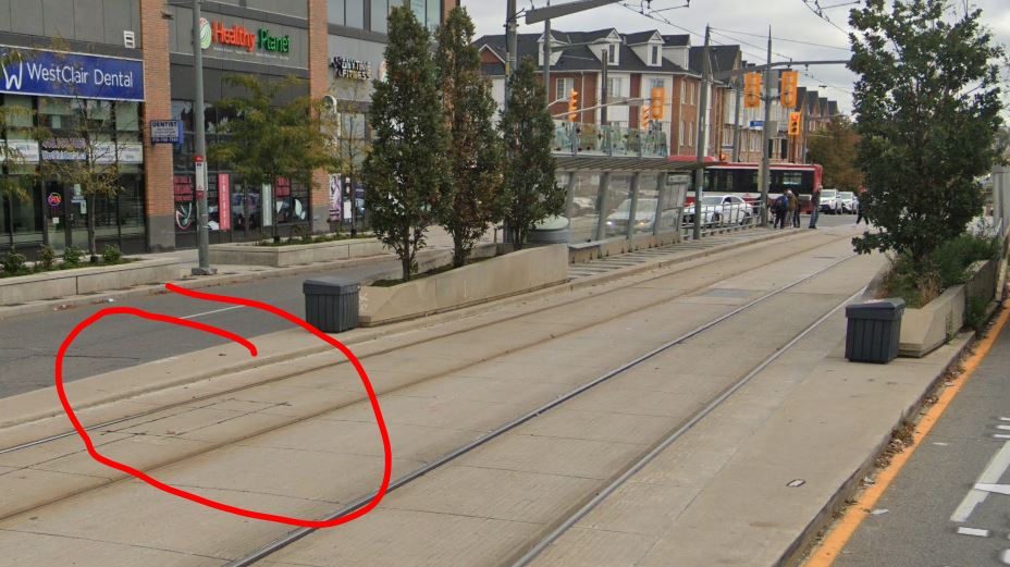

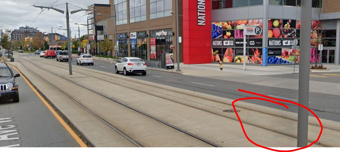

Streetcars are tracked using in-road detectors, and the signal timing is adjusted in an attempt to line the transit phase up with the streetcar's arrival. You can recognize streetcar detectors from the black rubber rectangle over them (though the blackness fades over time). Here are the streetcars detectors you can see at St Clair & Gunns via Streetview:
Westbound departing Keele St stop (200 m before stop line)
Westbound approaching Gunns (100 m before stop line) - this one's pretty hard to see
Westbound approaching Gunns (80 m before stop line)
Westbound at Gunns (just past stop line)
Eastbound approaching Gunns, just after crossing WB lanes at a stop sign (40 m before stop line)
Eastbound at Gunns just past the stop line

Glad to hear that that intersection is still working well. I've stood there and it's really satisfying to see the white light turn on exactly when the streetcar arrives, stay on for a few seconds, then the signal goes back to its normal program. I can't share the details of the signal programming, but I can point you toward some things which are publicly visible, which may help answer some of your questions.
