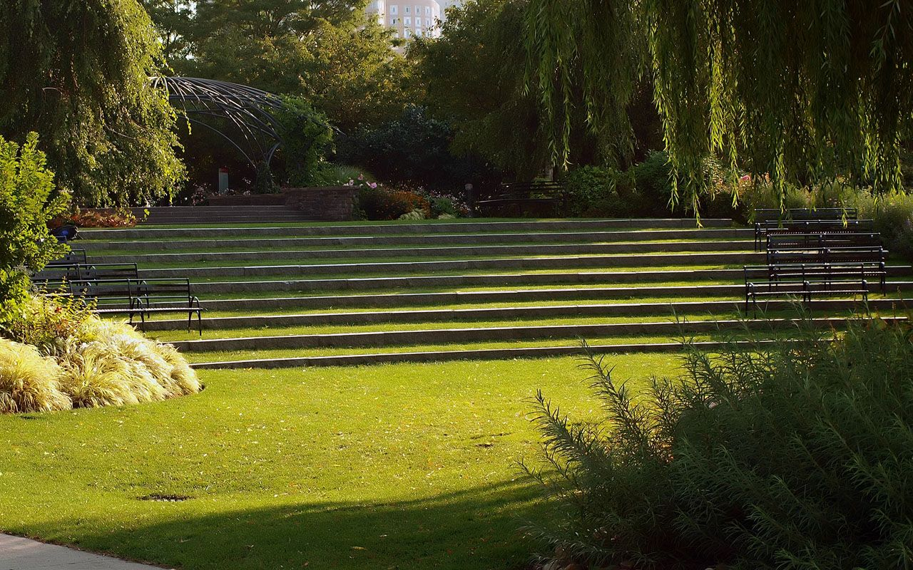

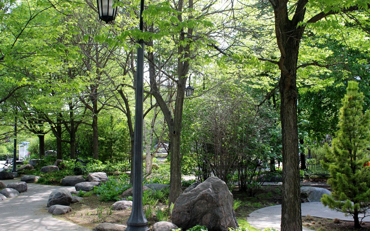

But these photos from the City of Toronto website (same link as above) show how the park feels in warm weather:
Notice the clear paths that direct your park experience.
The 4-seasons beauty, with a diverse colour palette.
And the amphitheater space that provides both a function and pleasant seating.

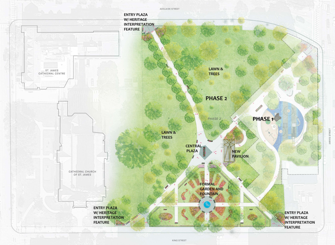

I'll take a look at St. James Park as a positive example of park design.
Lets start with a look at the plan from the City website:
Notice several key design choices that I've singled out before.
First, clear entrances and exits.
Second, clear, pathways.
Third, take note of the trajectory of the main paths.
They follow a basic desire line; some people are just cutting through the park to get to the other side. They would like to take the shortest possible route.
the paths here mostly follow that logic.
That's important, because it invites people to pass through the space, which unto itself creates desirable animation and perceived safety.
But it also means that people are less likely to trample vegetation/garden beds or even sod, if the paved path gets them where they want to go.
That said, while a path is great, its even better if it leads somewhere. As in 'Why am I going to come this park and stay more than 5 minutes?"
One can see that for families there is a children's playground; for those who crave arts/music, there is a pavilion space which can serve that need; for those in search of tranquility, beauty, or a nice place to read, one can find a formal garden.
Finally there's open lawn which can be used for anything from a picnic, to sunning one's self, to kids playing tag.
In other words, there's a 'there' there.

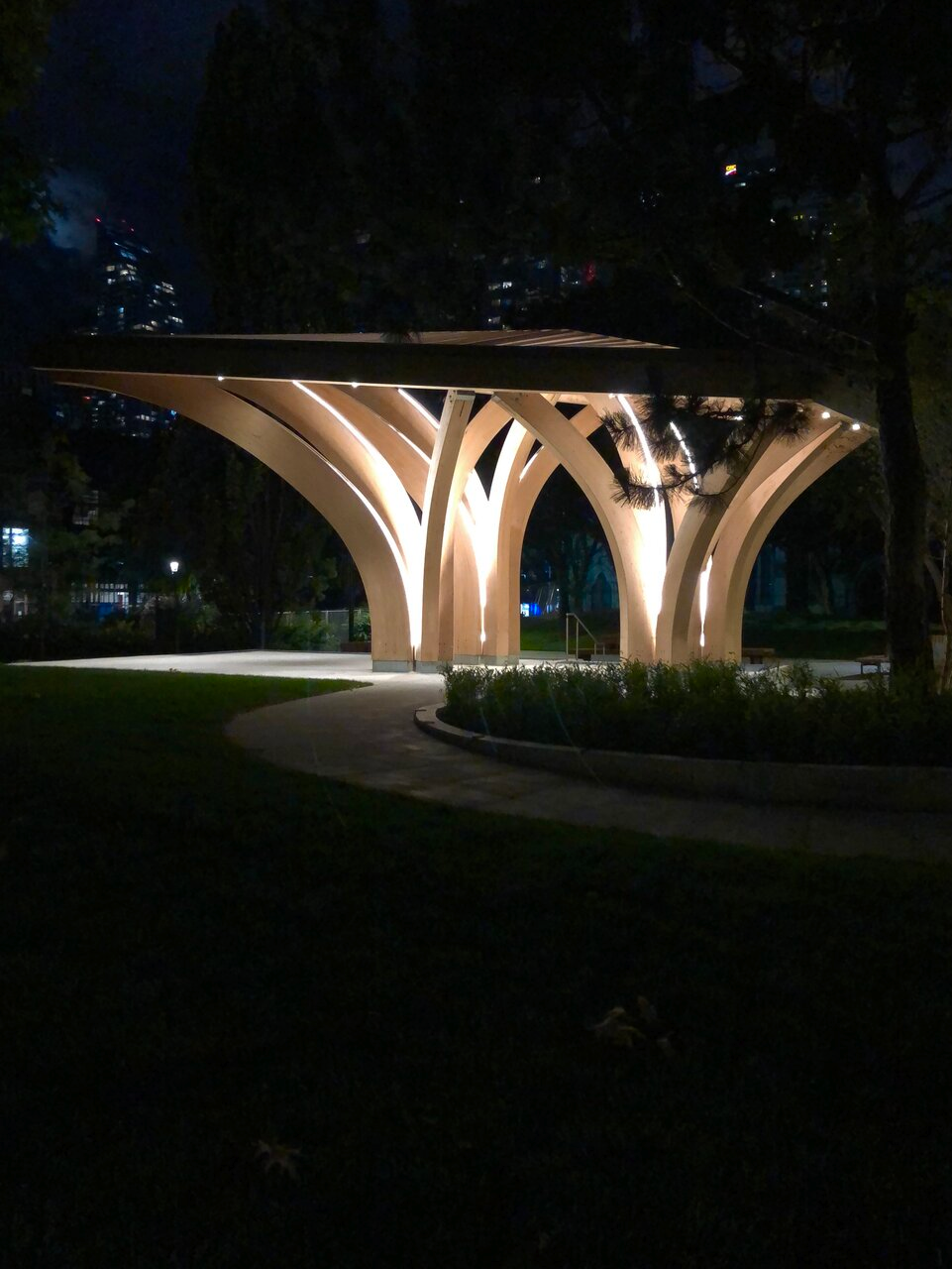

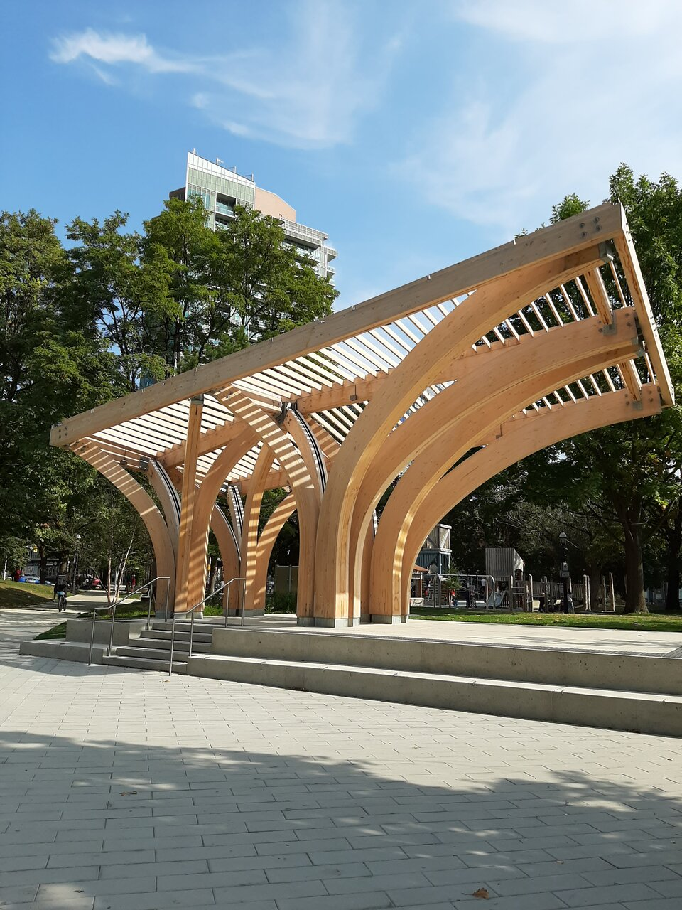

Here you see the pavillion. A dramatic, but functional piece, that creates a clear sense of place. This is somewhere you can tell someone to meet you. They won't have difficulty finding it, nor will they confuse it with any other spot in the park.
This photo below shows it at night; and credit goes to @condovo for this excellent illustration of good design. Park fixtures should generally appeal in both
the day and night, and in all seasons.

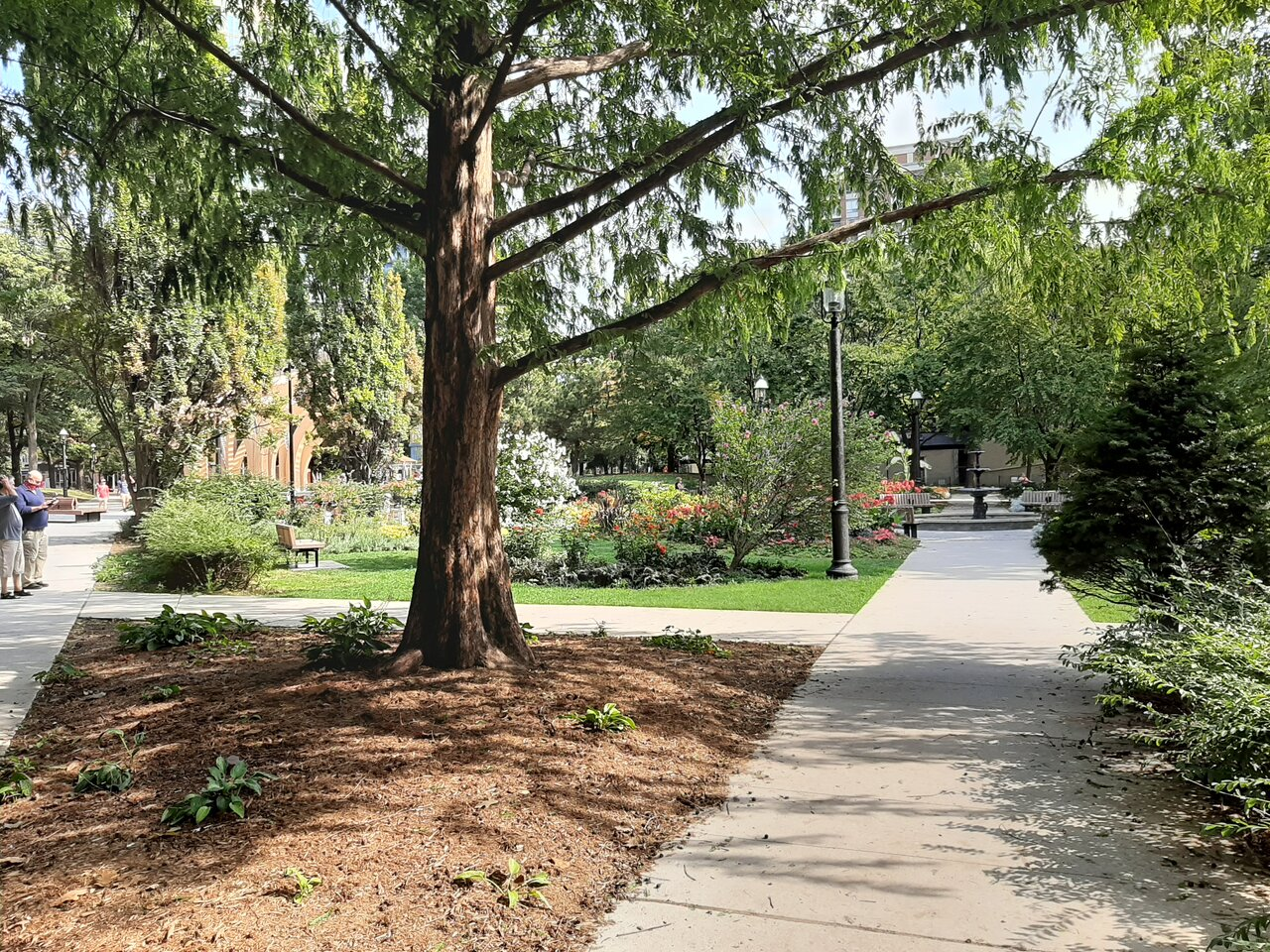

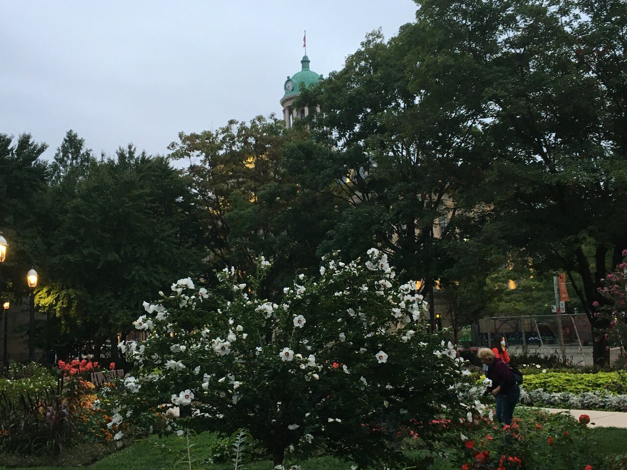

Back to another AlbertC photo to show the formal garden area, another clear sense of place, inviting, attractive, lots of seating, a central fountain...........and
this is important, paths that lead to it from every direction. A park design clearly saying 'please come here' and making it easy for you to do so.
In respect of the above, note the way in which this space is made to feel special through the choice of paving material.
How the pattern of the paving (circular) emulates the fountain, reinforcing as it were its importance.
Also the seats all face the fountain.
This might seem obvious, but in some of the problem-plagued designs we saw earlier, this sort of simple logic was not followed.
Here the designers asked and answered the question, why do you want to be here? To enjoy the water feature.
So lets maximize views of it; lets point people in the direction of that desirable view, but also not encumber access to the space by way of improper seating placement.

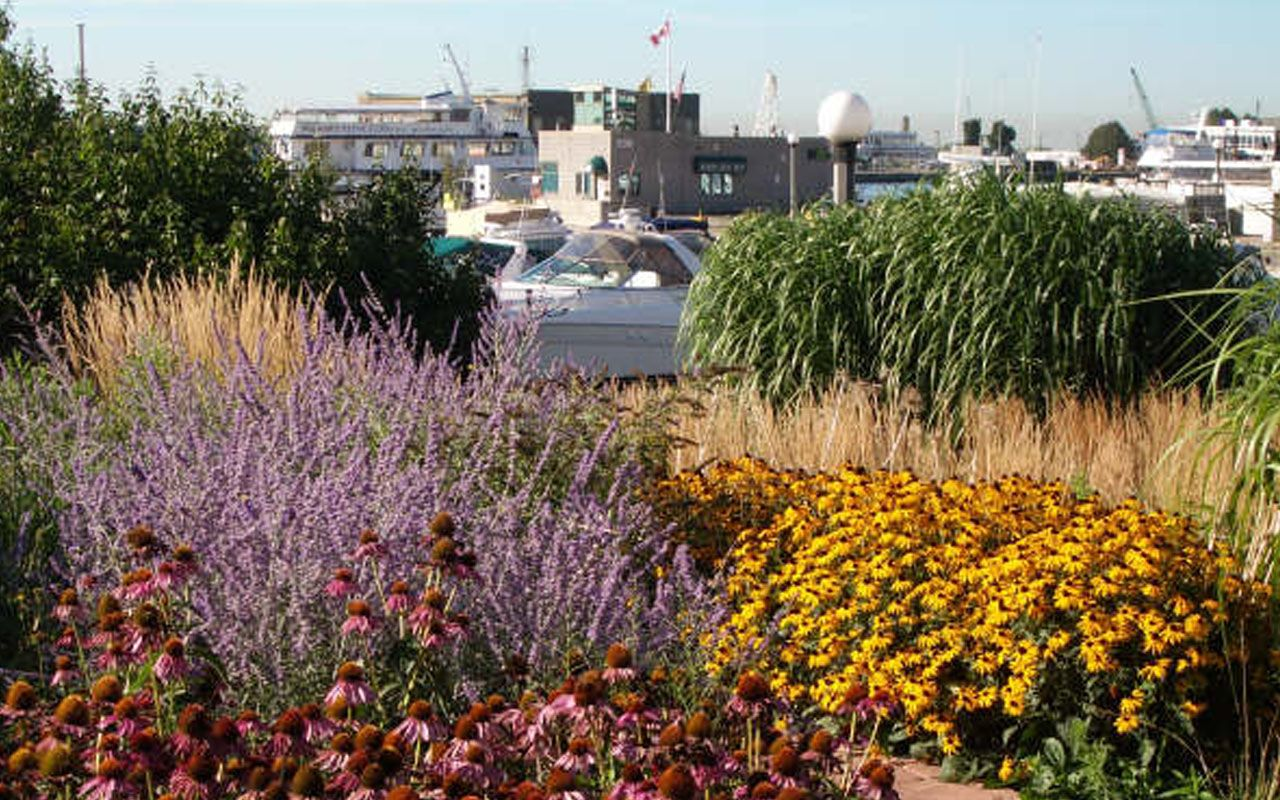

@Rascacielo shows us below through his photo, the importance of plant choice. Not just species, but size.
You have a plant that is a show-off, and its large enough that you can't miss it. While shorter flowers can be found in front of it, there's also a ring of grass to prevent the plant from being competed with, and to 'frame' it for the viewer.
What may not be as detectable here is the variety of plants, and how they serve to provide beauty across several seasons.
You have a mix of perennials, and annuals; many in bloom during summer, but others available to enjoy in early spring, and some in fall.

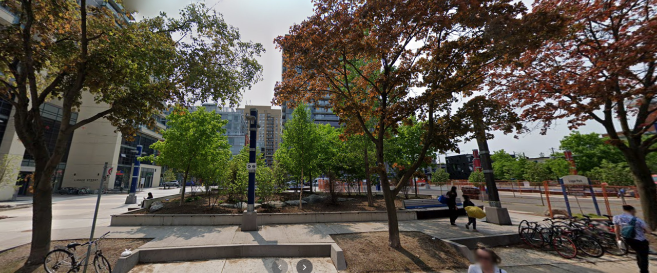

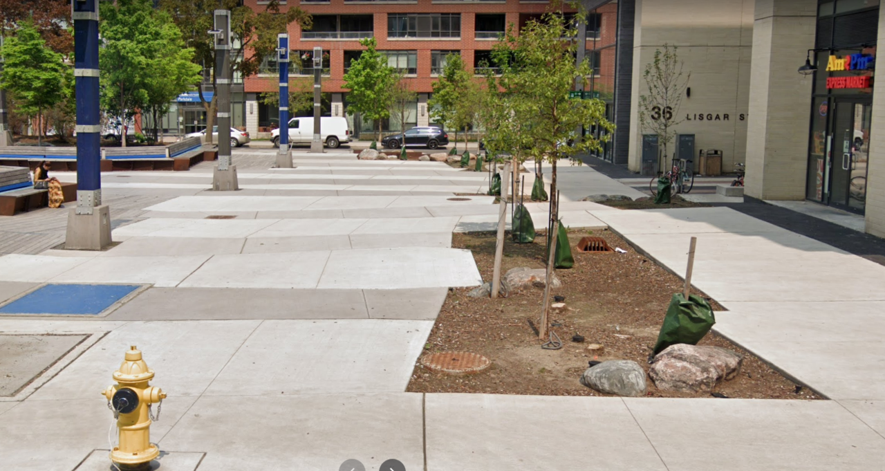

Now for Lisgar Park:
An overhead view heralds problems at the outset:
Admittedly the shadows here obscure some of the Park's features; but at first blush, one sees dead space; the playground is barely identifiable as such, it doesn't seem particularly showy in a good way; and that thing I always harp on.......
Where's the 'there'?
But perhaps we''ll find things aren't so bad on closer inspection.
Then again:

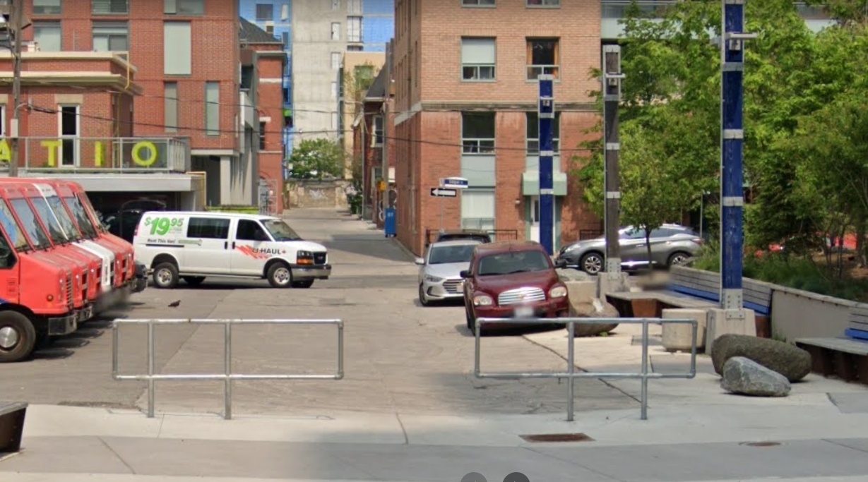

This is the northern edge of the park, facing a public lane.
I'm sure someone thought they were 'animating' a laneway...............but they were rather mistaken.
First, we observe 2 cars presumably illegally parked, blocking the way through and access to the benches.
If this lane were otherwise an appealing place to sit, I would personally prefer to do so w/o car exhaust in my face, or feeling I have to tuck in my feet lest they be run over!
IF one wanted to put seating here, that parking needed to be prevented.
The poles needed not to obstruct sightlines to the seats, or from them. The guard rails look utilitarian, the boulders are poorly thought out. Presumably they were meant to obstruct vehicles, there were far better ways to achieve that.

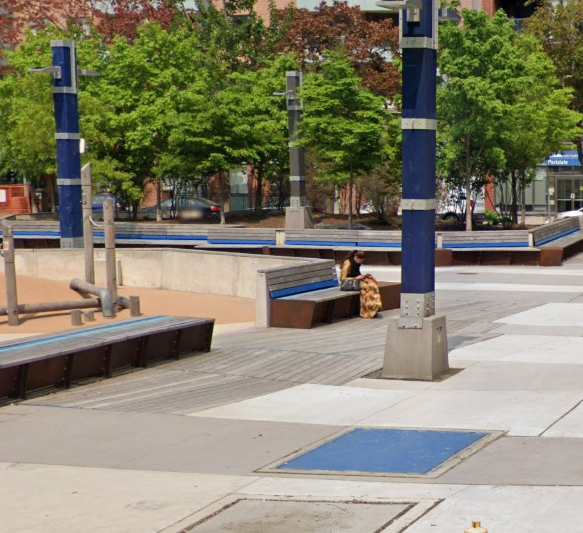

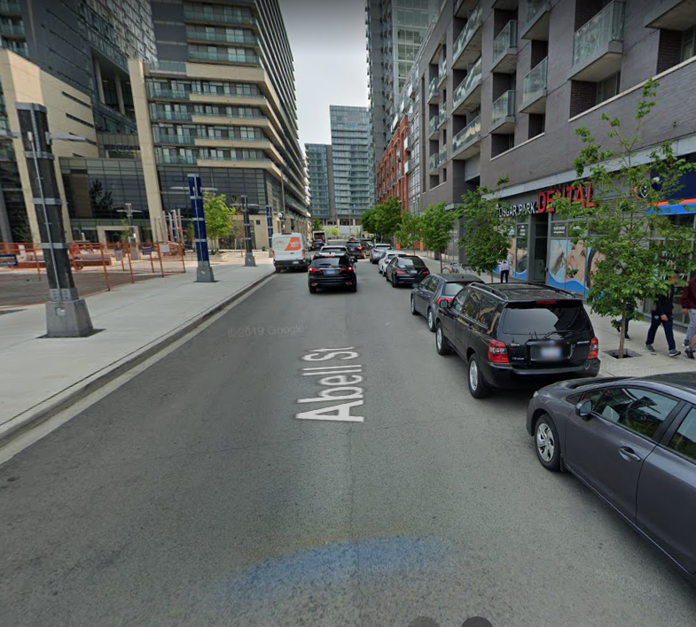

Lets wander down Abell Street:
Another one of these no so brilliant uses of gravel.
Nothing inviting about walking on it, looking at it, sitting around it, not very pleasant for your dog either; just an absurd material taking up far too much space here regardless.
A bit further down the street............this is what passes for a playground:
Two words: Why Bother?
Seriously, if a playground is desired, that's fine, but provide enough equipment, and enough scale to be interesting a to child for more than 20 seconds.
I don't know any self-respecting toddler that wouldn't be bored just looking at that slide.
If there's isn't enough room for proper equipment, then the park should be larger, or the playground should go somewhere else.
Not every park feature in every park need be best-in-class, but every last one should of a reasonable quality. This, is not that.

Also....a word about grading............there is every angle here in the pavement and wood surfaces except flat.
A better recipe for ankle-twisting would be hard to find..................unless you were familiar with June Callwood Park.

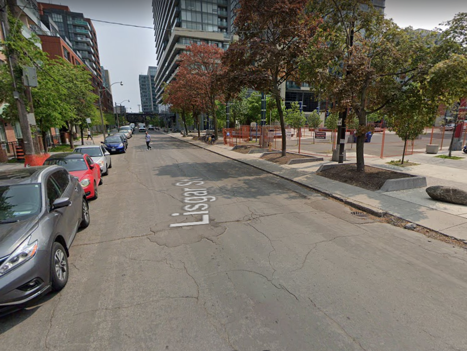

Now let's back track up Lisgar:
See what I mean........."What path to Abell?" The sightline is almost completely obstructed.
What on earth is with that mini-set of stairs? If you wanted to clearly convey that this was the entrance, I want those stairs to at least go from the light poll to the curb to the north.
Though in truth, those poles are both poorly thought out in design, and in placement.

What was done to integrate a small space with the neighbouring streets?
On Lisgar we see a street that is wider than it need be, with normal asphalt, a narrow sidewalk on each side.
Not well thought out.
Not really any better on Abell either:
At least there's room here, give or take the giant poles blocking the middle of the sidewalk.
But the space feels exceedingly bland, and poles aside, really doesn't play with the park at all.

Small parks cannot be all things to all people.
So pick what you want them to be; and do that well.
If a dog-run is more important than a playground, do that well, while providing an adjacent outdoor community room.
If high-minded design is the priority, then give me WOW.
If the playground is the priority, then give me no less than 4 pieces of equipment, and make them of sufficient scale that a 6 year old would enjoy them.
If you can do more than one, great! If you can't, drop the extras.
But get the basics right.
If you can't even execute a straight path across the park with any aplomb.................
As to the gravel, this has been a surprisingly common choice across many parks.
Largely attributable to 2 design firms.
That will be a point of discussion in a future post.

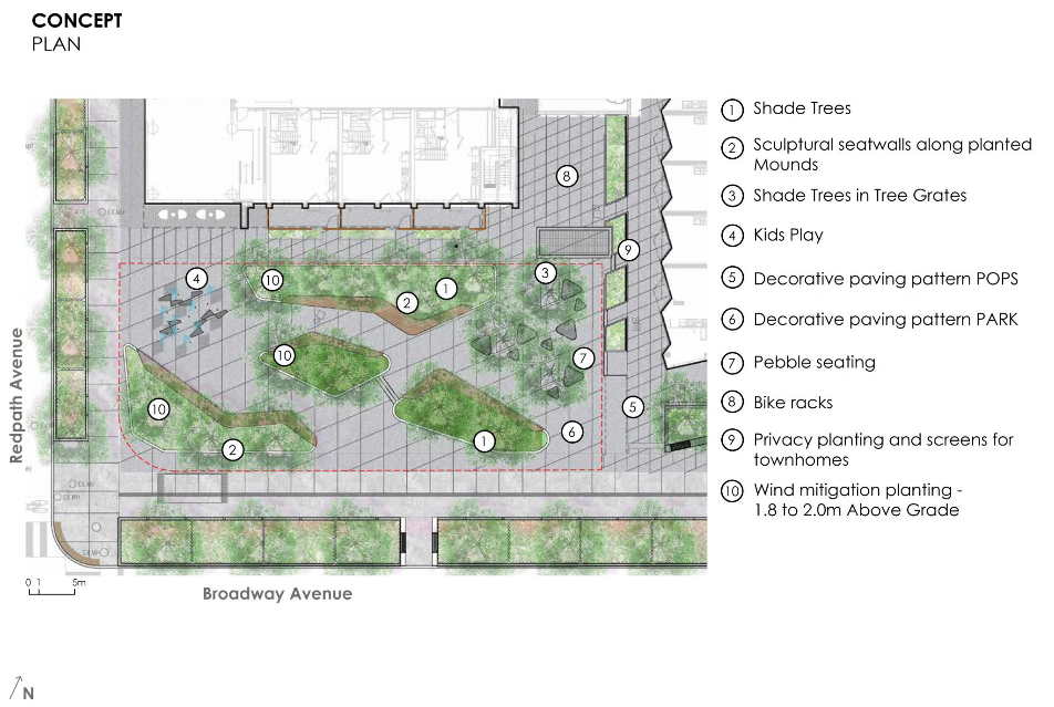

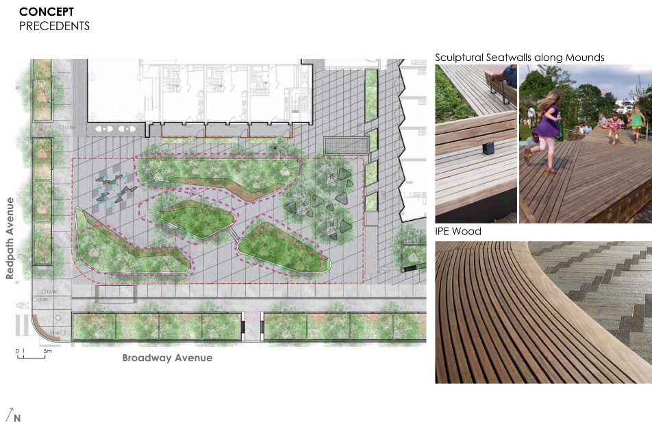

Now for something slightly different........lets look at a proposed park that hasn't been built yet, which is still under consultation, and whose preliminary concept is problematic.
This is the new proposed park at the corner of Broadway and Redpath in the Yonge/Eglinton area.
Project page here:
Lets look at the plans:
Additional renders at the link above.

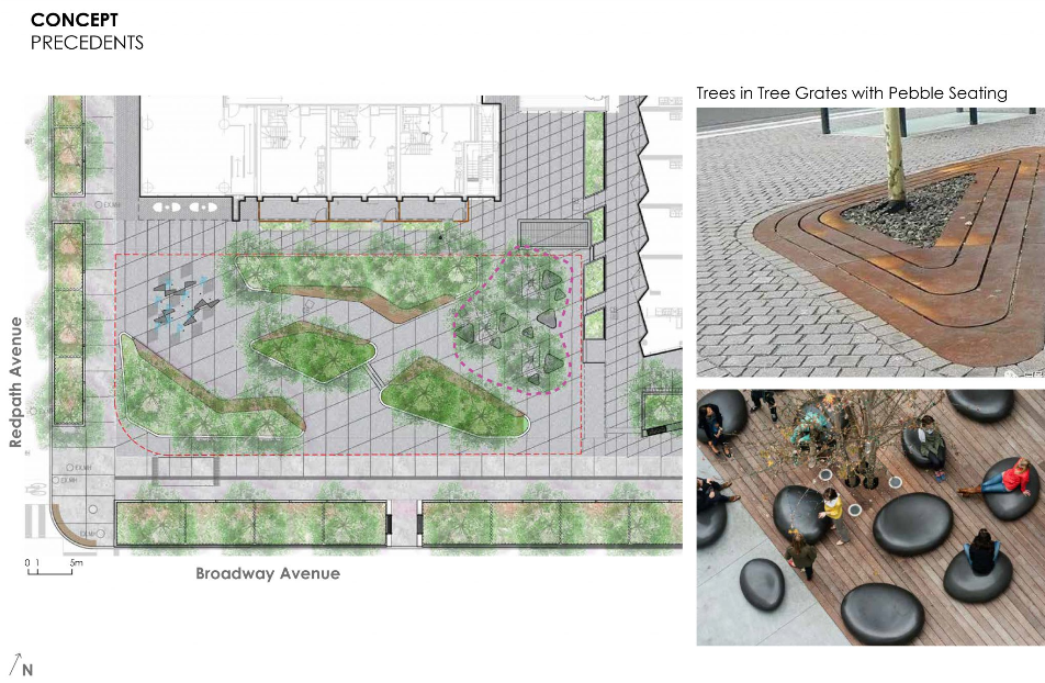

So.....what do I think is wrong here:
Lets go back to that first plan:
Problem one: The park turns its back on the corner of the Redpath and Broadway intersection! Absolutely not!
The park design here should feature 2 paths meeting in a T-shape, one coming in from the corner, and then the desire-line short cut path from Broadway to Redpath sort of in place here.
This need not increase the amount of hard surface over all; the current layout proposal splits the desire-line path into two with median islands. That is not only unnecessary, but wasteful of precious space. Its a small park.
Use space wisely!
Problem two: 'Playing Mounds'. They are small, incumbered by a seatwall on one side and unlikely to draw any interest from kids. But if they do; they're too small to take the wear and tear; and on behalf of adults everywhere, when I take a seat on a bench, I don't really want a 6 year old climbing all over the place right behind my back.
Problem three: The Waterplay. I have no problem with the idea per se; though given the small space it might make more sense as fountain/art piece than a play area.
However, its positioning within the proposed space is poor, either way.
Its arguably the central feature of the park, but its positioned on one extreme side of the space. Not only is it bad form to put the 'draw' to the space at the edge; but the water feature as placed would seem to form a barrier to a usable pathway, virtually blocking the entrance at one side. If someone wants to cut through the park, that doesn't mean they want to get wet. The feature should be centrally located in the space with ample dry path running around it; and/or it should be off-centre to the rear (south of the space) so that its a draw, but not in the way.
Problem four: Seating. As mentioned before, seating that turns its back on a very small play area for young children is just peculiar. But that aside, not one seat clearly faces the street/park entrances.
The seats in the middle could, but they are visually obstructed by the landscaping layout. That's really quite uninviting. Also this 'pebble seating' doesn't look remotely appealing, and represents over-programming of a small space too.
With all that said; for those of you that live nearby and find something here to comment on...........
The survey for this park consultation is still open and can be found here:

As for my nighttime pic in St. James Park, it's worth mentioning that my old iPhone camera greatly exaggerated the brightness of the canopy lighting. In real life, it's quite subdued, almost dim. It looks great in person, not obnoxious as shown here. lol
