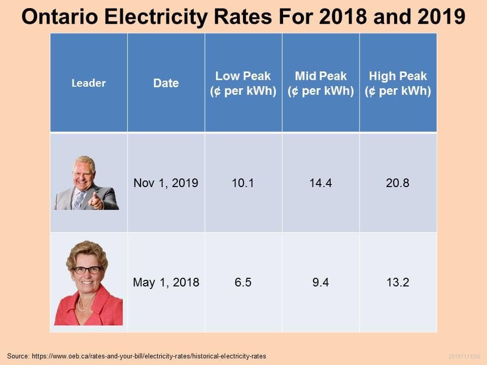

Time shift pricing has also been a bust; this could work, in some measure, with larger differences between peak and off-peak. However, once again we have problems, as example many tenants still use laundry rooms which have fixed hours and fixed capacity, and as such you can't necessarily shift that use to early Sat. Morning or late Friday night.
They haven't yet changed to time-of-day metering with natural gas. So if the laundry rooms use natural gas for the clothes dryers, less electricity would be used.
Is this even a consideration? I'm not sure the issues are same. Electricity TOU pricing is used as a way to manage generation with load (produced energy can't be stored). Baseline generation is adjusted by bring other sources on/off line as required. With gas, it's in the pipes of a large continent-wide integrated network. Volume surpluses are stored or used for LNG production. Also, meter change-out, even if a TOU residential gas meter exists, would be much more costly and disruptive than to few minutes it takes to pop in a TOU electricity meter.
