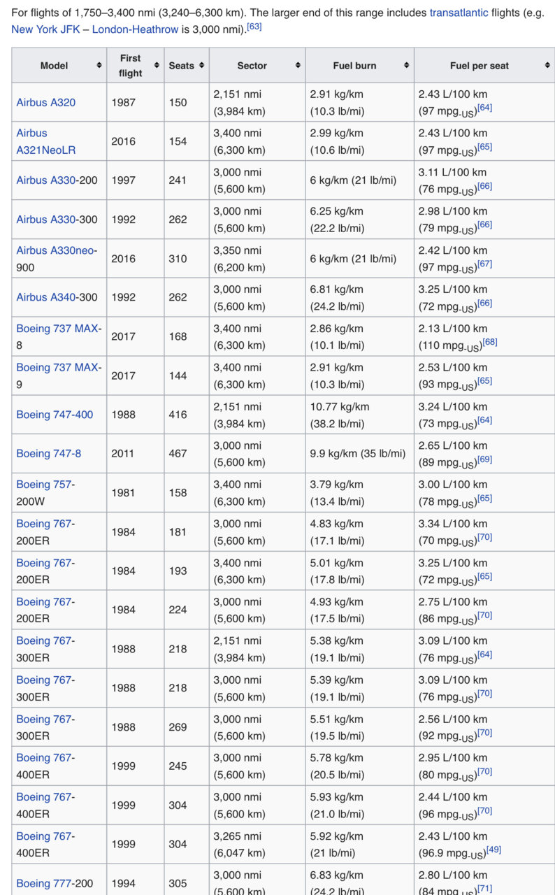

this is what you call a teachable moment, don’t waste it, and don’t feel bad, a lot has changed in the last 15 years When it comes to jet fuel consumption.
yes I do drive a EV since October 2011, one of the very first chevy volts. I have also written extensively On the subject as well:
And here are current numbers for aircraft used on most regional routes:
west jet 737fleet is usually a bit better than the Q400 but I use that example to remove any doubt.
here is a snap shot of some key numbers.
