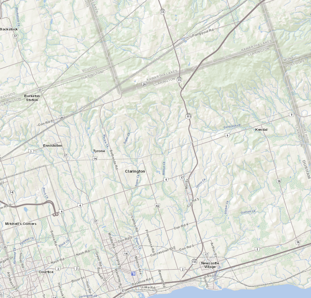

A new track connecting the two CP lines would be about 12 km long, and there isn't much in the way to make that new track particularly costly. And then, Whitby / Oshawa / Bowmnaville / Peterborough could share the same rail service.

That's an interesting idea. I make the distance a little longer - from the northmost point of the curve in Bowmanville to the west end of Pontypool is 18 km, but that's still not a huge amount to build, especially when you figure that the alternative might require a similar amount of new trackbuilding along the Belleville Sub from Pickering west to Leaside. Connecting the havelock line to LSE might delay or eliminate that need.
What's more of an issue is - there is an awful lot of wetland in there, lots of creeks. And a very significant rise in elevation particularly as one climbs the ridge from Leskard north. That would be a rise of 122m in five miles as the crow flies, or about 1.5% grade end to end.
But (digressing a bit) it raises an interesting question - are there rail routes outside the Toronto core that might still be buildable, especially if the land were set aside and the corridors enshrined in Official Plans, and which ones might be worth building? If we don't plan them now, we will be in bad shape in 20 years when there may be new subdivisions in the way. While personally I'm not a fantasy map kind of guy, perhaps we need a fantasy rail corridor thread,
I suspect we will need the North Toronto Corridor sooner than we think. The question is what it will cost to shift CP or gain shared access to that corridor. The (shelved) Bypass plan could be instrumental to both that idea and getting RER on the Milton line. Expensive, but eventually there may be no option. Union Station and LSE/LSW can only expand so much.

That definitely is an interesting idea. Service patterns for Bowmanville would likely be pretty similar to the service patterns for Peterborough too, so combining those onto one service would make sense.
^I would be curious about the potential demand along the CP Belleville Sub, at least as far as Whitby. It has the potential to syphon off a lot of demand from LSE, in the same way that the Milton line is popular despite LSW being not so far away. Even as a peak only line, it would probably have a lot better business case than the Peterborough line, for similar cost. On a gut level, that's a better use of money than GO to Peterborough.
Taunton is already a very congested street, but a GO line terminating with a station near Brock or Church might convince a lot of people to drive west to get on there, as opposed to south to LSE.
Stations in Scarborough on the south side of the CP yard might be useful also.
I'd vote for this plan over any Peterborough plan.
