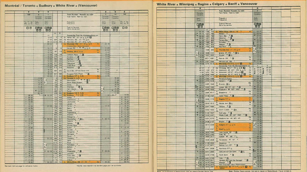

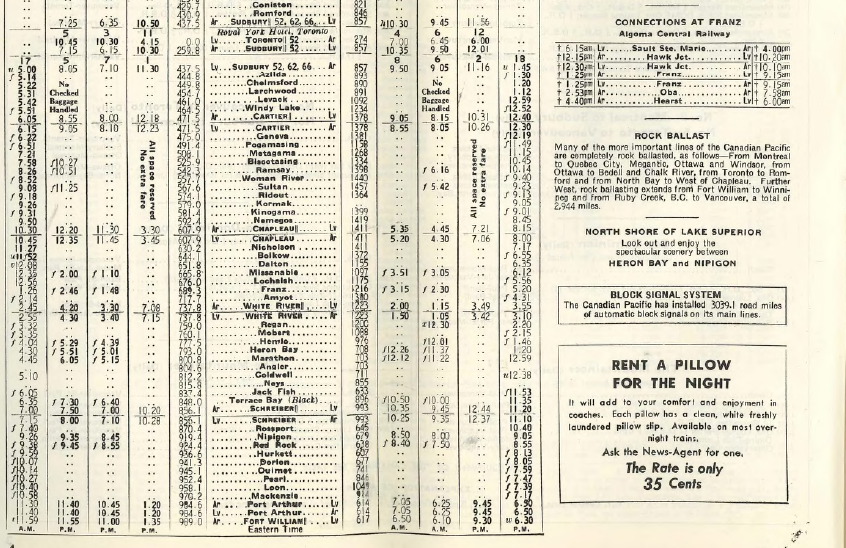

I imagine the Sudbury-White River run began after the VIA Canadian moved off CP.
You'd be surprised:
The train dates back to April 1956, when CP cut its Montreal-Vancouver milk run train (Train 17 and 18, total travel time: approximately 120 hours in September 1955) east of Sudbury and west of Fort William (Thunder Bay), operating 3 times weekly instead of daily:
190327
Source: CP April 1956 timetable

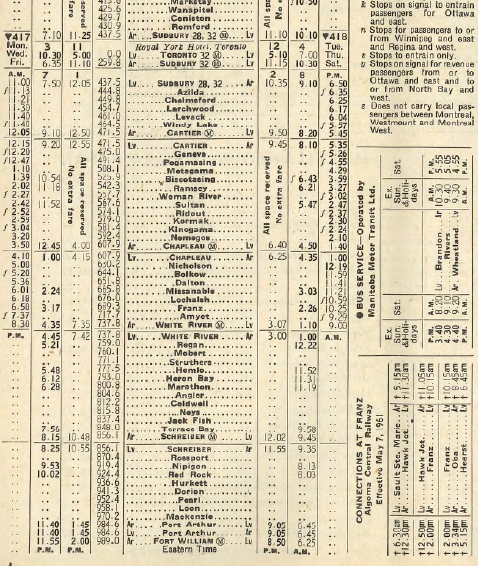

The train was subsequently renumbered to 417/418 and in April 1961 cut to Sudbury-White River:
190328
Source: CP April 1961 timetable

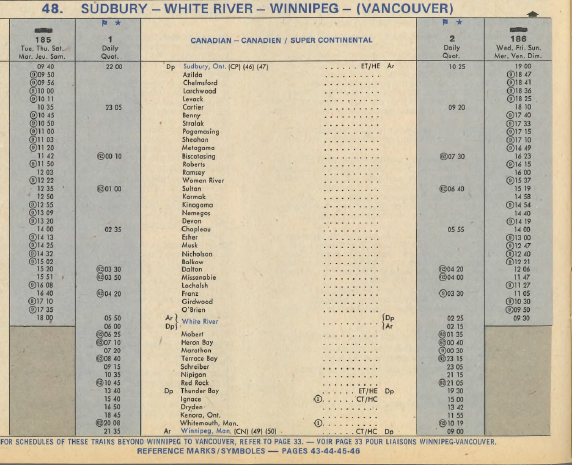

The service was grandfathered by VIA Rail and renumbered twice in 1979 (first to 317/318 and then to 185/186):
190329
Source: VIA Rail 1979-10-28 timetable
Trains 185/186 briefly disappeared a few times between 1980 and 1985 (mostly during winter, when the Canadian was deemed a sufficient transportation offer for local needs), but both services were offered year-round for the final five years leading to the 1990-01-15 cuts (with trains 185/186 being the only surviving services on CP routes):
190330
Source: VIA Rail 1989-04-30 timetable
