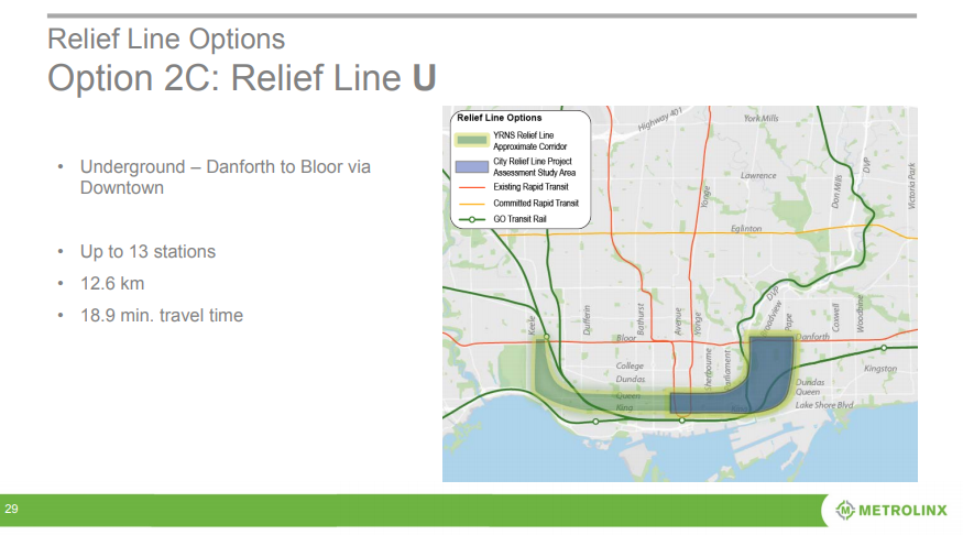

The last western relief line route I've seen officially considered would go west on Queen/King, up through Roncesvalles and hit Bloor at Dundas (see pg 29 of linked report). Is this your third option?
http://www.metrolinx.com/en/docs/pdf/board_agenda/20150625/2015-06-25_Yonge_Relief_Network_Study.pdf
