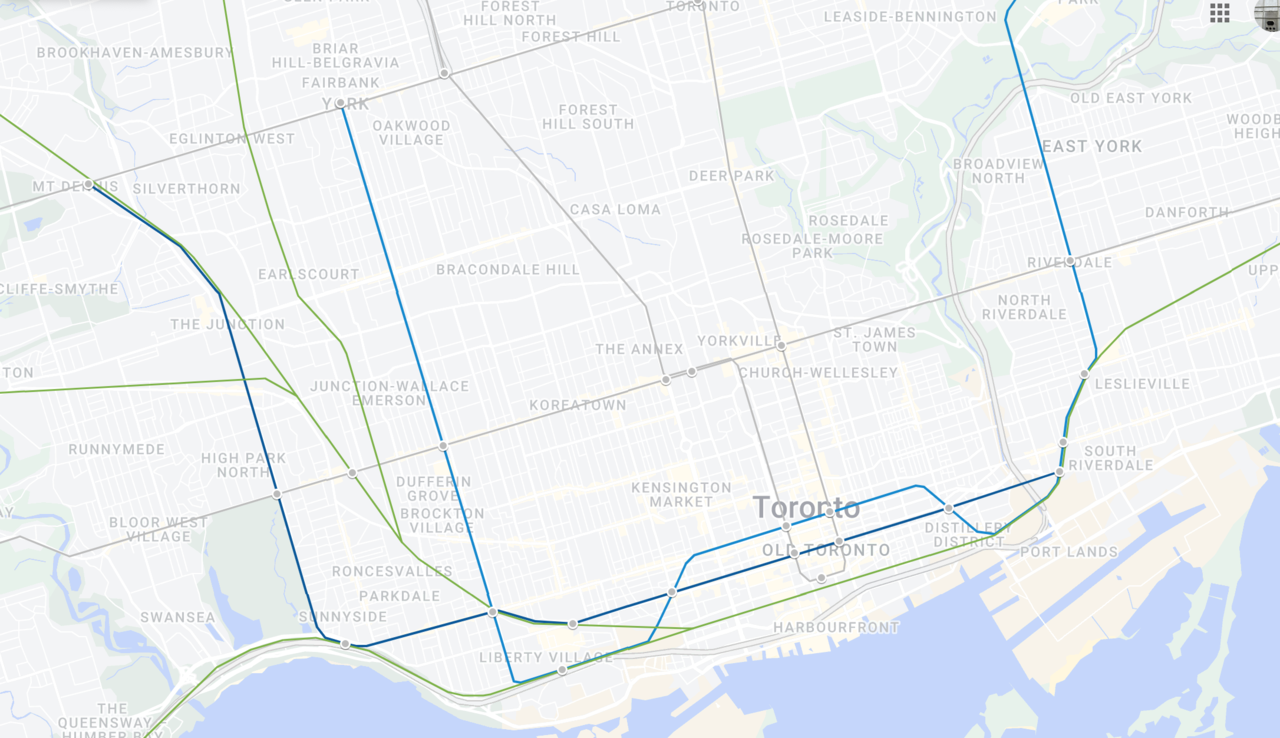

Line should be entirely elavated on Jane.
I like this idea a lot, but have some concerns.
I agree the Ontario Line West extension should head north on Dufferin, although I think terminating at Fairbank (Dufferin & Eglinton) probably makes more sense. That would be roughly 7.6 km long from Exhibition. My concern would be that if there's a need to eventually relieve the Ontario Line with another metro line then you've used the two most logical routes on one line (Dufferin & Jane). If a second light metro line is eventually needed Jane is the perfect route for that. Then this future metro line (OL2) would run under King or Wellington or Front through the core.
If Eglinton was built with high-floor platforms, you could interline the OL to Mount Dennis and take the rail corridor to Jane. Alas, not an option. Perhaps there is a better way to cover the 3 potential western routings (Dufferin, Roncy, and southern Etobicoke-427). Pick whichever one can go furthest for the OL, and use a seperate LRT line for the other two- underground where needed, realistically south of Bloor.
I hope we don't build any additional low-floor lines. I'm kind of hoping the REM / HART / Ontario Line will be the start of the trend of North American cities building automated light metro. We do seem to follow trends here, for a long time it was LRT everywhere for every purpose!
