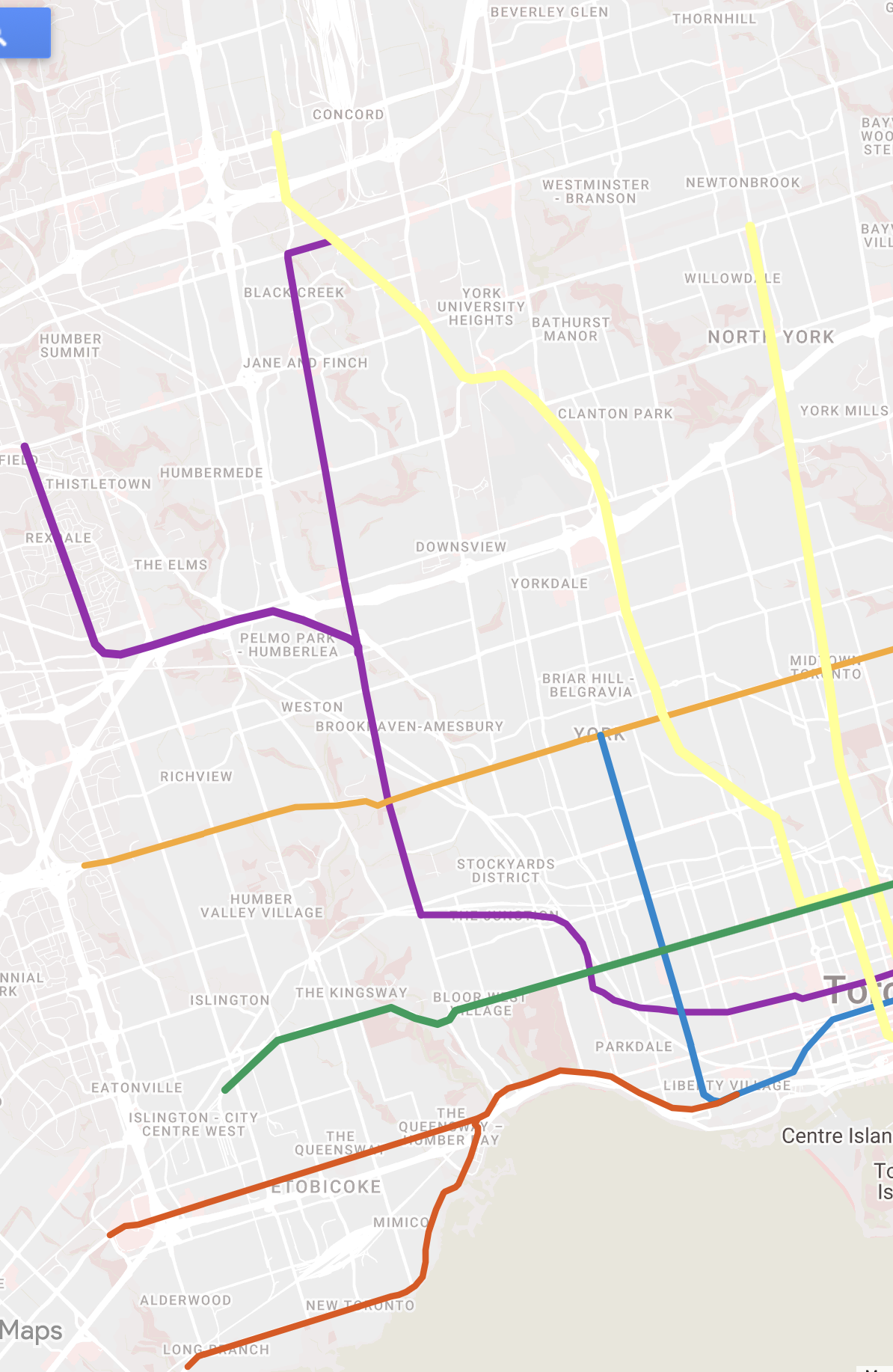

I think you an I largely see eye-to-eye on this. At least in terms of what we're trying to accomplish.
I made this map a few months back, when I was trying to figure out what direction we should take western Toronto transit.
I must admit that I really do prefer your idea of routing the new Downtown line along Dundas, north on Dufferin and then towards the northwest corner of the city. It would leave Dufferin between Exhibition and Dundas without rapid transit, but this idea does feel more viable.
Do keep in mind, though, that routing would necessitate extraordinarily high capacity. This route would be doing triple duty as a Dundas Subway, a Dufferin Subway and a Jane/Etobicoke Subway. Each of those segments on their own would be very well used, let alone when they're combined into one line.
The subway line on Dufferin alone could produce 15 to 20k pphpd. Rapid transit along Jane or towards Rexdale could easily add another 15k pphpd. The Dundas portion of the line would also see a very large number of boardings, as eastbound streetcar riders may prefer the new subway line to get downtown. The ridership would be scary high. These trains would resemble Elizabeth Line's 200 metre trains, more than our 140 metre Rockets or 100 metre Ontario Line trains.
It's enough to make me question whether or not concentrating so much ridership into one line is wise. The downstream impacts would have to be carefully considered. Eg, could the Downtown Yonge Line handle potentially tens of thousands of transfers from the Dundas Line per hour. Those commuters on the Dundas Line would need to transfer to Line 1 if they were going to destinations south of Queen.

@TigerMaster: I like your map, it is another viable configuration of rapid transit lines in the western half of the city.
However, I do not expect the ridership of the single diagonal line to be that dramatically high:
Dufferin's local demand is not that high by the subway standards. That demand only looks huge because it is currently served by buses and those buses have to run at a crazy frequency. But if you go to the pphpd counts: say a bus (70 nominal load) every 1 min (60 per hour), would be just 4,200 pphpd, peanuts for any rail line. A better transit would bring higher ridership, but I don't see it going to more than 7,000 pphpd or so.
Same goes for any other local segment, say Jane north, or Kipling north in Etobicoke. TTC has no transit line that isn't downtown-bound and clocks anywhere close to 10,000 pphpd; Eglinton will be first such line, and even then the current forecasts are under 8,000 pphpd for the first couple of decades.
Now, the downtown segment will be the main driver of ridership, working in the same manner as Yonge / Spadina / Bloor / Danforth. A busy downtown section where lots of riders want to go, plus long outer sections working as collectors. The total ridership will be very decent, but I don't see it dramatically higher than for the existing lines. It should beat the Spadina branch, but probably not Yonge.
If an exceptionally high latent demand for that diagonal line existed today, most of those riders would be taking the Spadina line or Bloor line, and overwhelm those; something we do not observe. Of course, there is an induced demand and the impact of population growth, it won't be just the same riders redistributed between more lines. But, given that 2 lines serving the north-western segment are doing OK today, I don't think 3 lines will have troubles meeting the demand in the next 20-30 years.
A lot of good ideas on your map! I could also see a OL extension that is a combination of the blue and purple lines on your map. Something that turns at the Galleria development and stops in the junction and a future stockyards re-development. Could be a good compromise if a second line isn't in the cards.
