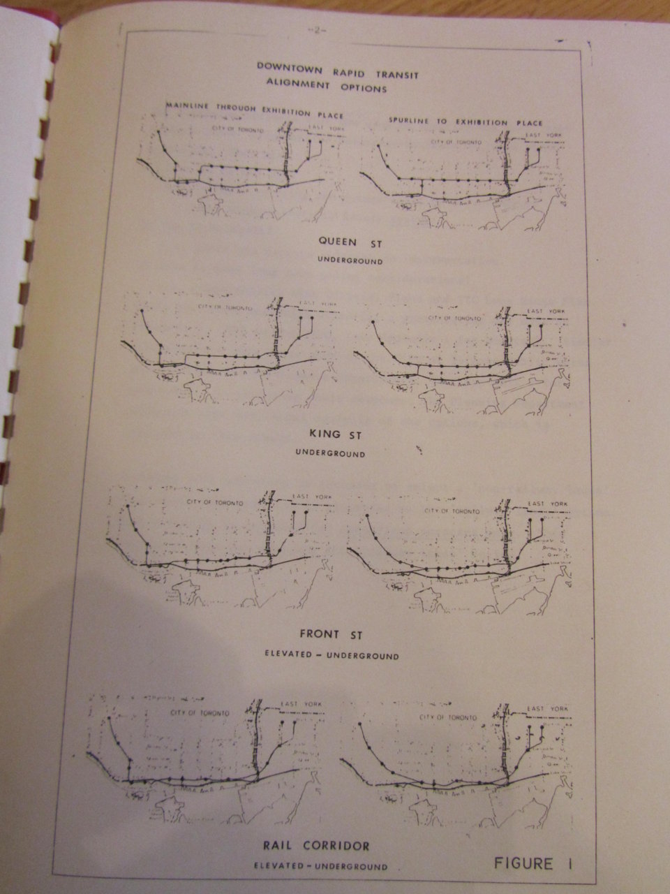

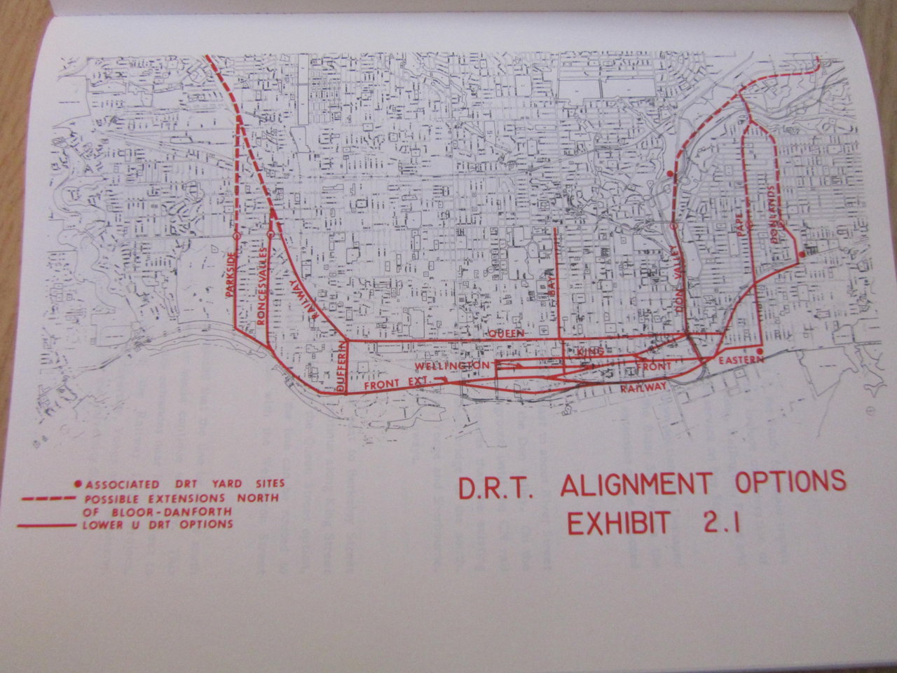

I'm not a fan of splitting threads up, but to be fair the RL West has been in Toronto's official plan for awhile now, ditto for the regional transportation plan. It's generally terminated at Dundas West, but like the 1985 DRL and Queen Subways of decades past a western terminus was never finalized - hence these discussions. Maybe it won't be built, but it's not exactly a "fantasy".
edit: and have posted these numerous times before, but if anyone hasn't seen them and wants to get a couple ideas have a look. These are a couple of early (1984-85) RL alignments for the west end. Take note that in the earlier one all lines serve Exhibition, either as a beeline or a spur. The spur is something I think has legs, and I'd like to see on the east side into the Lower Don Lands. Basically an inverted U bookending the E-W waterfront, perhaps as a separate service using shorter trains but on the same trunk.
Personal opinion, I like veering NW along Weston, Black Creek, Albion, maybe some Scarlett. Provides good coverage. But I do like branching, and the Queensway ideas are pretty neat. Lots of interesting stuff happening on that corridor, so perhaps both via branching? Though that's getting fairly fantastical.
