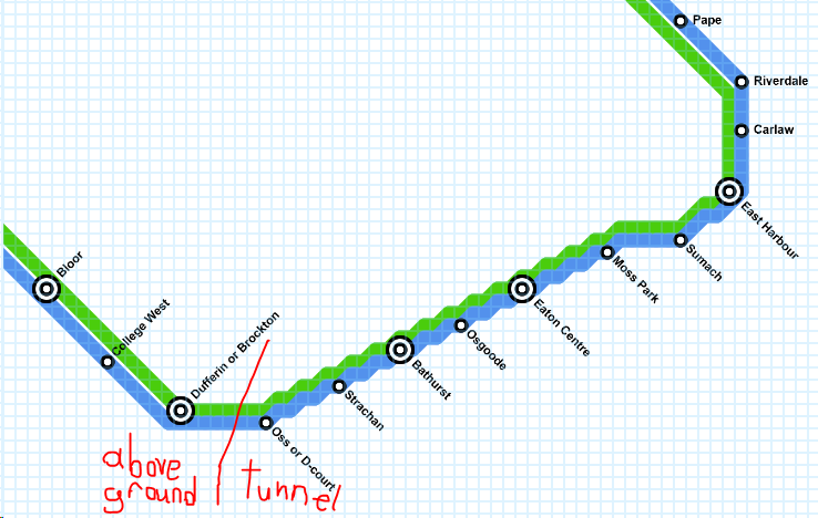

To better illustrate my point, here's a quick and dirty sketch of what I think the Relief Line could look like. Blue is local service, green is GO. GO trains would completely bypass every station with a smaller icon at a minimum, only Eaton Centre, East Harbour, and one station west of Strachan are really necessary for GO.
Running both services through this corridor is almost like two tunnels for the price of one. Keeping local service and GO service completely segregated is a huge part of why transit in Toronto is a joke.
You're missing Spadina, which is significant because Spadina/Queen would be the more suitable intersection for the GO/DRL interchange station as it's busier than Bathurst.
