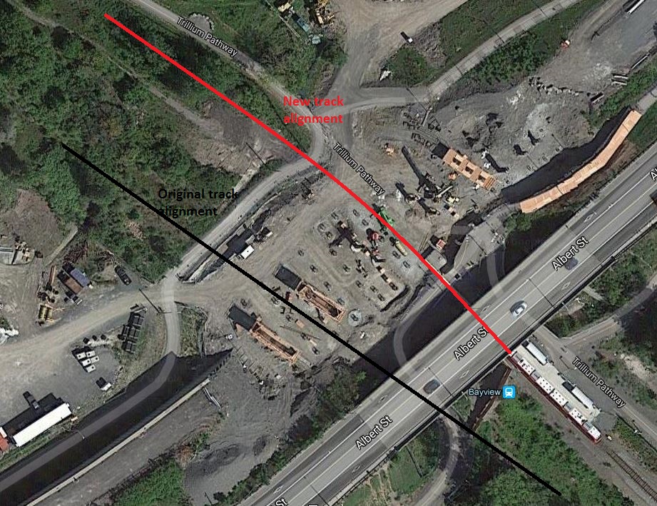

Here is a satellite image during the construction of the Bayview LRT station. The black line indicates where the original alignment of the tracks were. The red line shows the new track alignment. The new track alignment goes INTO and THROUGH the station and will be able to reconnect to the POW Bridge. You can actually see the O-Train sitting on the tracks in the temporary station just South of the construction. As you can see for yourself, the construction of the station has not created a permanent blockade of the rail line despite what MOOSE and others are trying to claim, nor is there any requirement to build tunnels or underpasses to bypass the station.

Charles,
A few questions:
1. Have you taken a look at the elevations at this site? To run the new track from the O-Train's existing platform to the bridge, do you prefer to run the track downhill towards the bridge, or to lower the platform a few meters and retrofit the new station?
2. Can you explain why the new Bayview Station was not designed to keep the original track layout? Was there some advantage to creating the new layout that puts the platform at the top of the artificial embankment?
3. Can you confirm that the new clearances under the OLRT and Albert St. overpasses meet the requirements of Transport Canada's "Standards Respecting
Railway Clearances
4. Do you suggest that since a work-around is somehow physically possible by some as yet un-designed, un-resourced, un-scheduled project, that the original track line is not "permanently" blockaded?

I would like to revisit the issue of the Bayview Station. Many folks here have made the statement that the line has been "permanently" blocked thus preventing access to the POW bridge. This is an incorrect interpretation of the facts on the ground. The line has simply been realigned slightly to the east and there remains the full potential to continue northwards to the POW bridge.

On a related side note. If you were to look at satellite images rather than the google map (or actually come and have a look for yourself), you will see that the line from the POW bridge was not actually physically connected to the O-train line prior to the recent construction anyway. What may appear to be a switch a few hundred meters to the south doesn't actually exist.
Yes, that switch was removed by the City of Ottawa in 2009. You'll find the details at paragraph 12 here:
https://www.letsgomoose.ca/wp-conte...2012_Prince_of_Wales_Bridge_25oct2012dPDF.pdf
That request for enforcement from Moose to the federal regulator is from 2012. Interestingly, the current 3-Year Plan from the City of Ottawa to the federal regulator still refers to the switch, which has been missing for eight years.

Joseph,
I am not about to enter into details in areas where I am not an authority, specifically technical specifications and requirements. However, as a general observer, here are my thoughts. Having walked the area, I do not see any significant difference in elevation between the original track alignment and the new realigned tracks so I don't see the issue with changes in elevation. To suggest that the platform needs to be dropped "several meters" appears to me to be blatant exaggeration. I can't imagine that all of the folks who were involved in the design of the station (licensed professionals), knowing full well the intent to continue on to the POW Bridge in the future, would have created a design that was incompatible with that intent.
Perhaps there is something in the word "permanent" that I don't understand. The fact that there is a rail line being built through the station seems to indicate quite clearly that there is intent to maintain the ability to utilize the bridge in the future. I believe that the City of Ottawa's response which I have linked to above speaks for itself in that regard.
Interesting that you state the bridge is too low (which it may well be, I'm no expert), yet your solution is to build an underpass under the same roadway and assuming the bridge is the high point in that roadway, any underpass through the embankment at the end of the bridge would either be a lower height or would require a drop in elevation for the tracks in my mind.

@Charles,
The spur from the main Ellwood Sub leading up to the Bayview platform was created with a grade, and leaves just 14' or so of clearance above the O-Train, to the underside of the Albert Street bridge. This is not enough height for regular-sized North American style freight or passenger trains.
Full-sized trains had previously been passing for years under the Albert Street bridge via the original track, indeed all the ballast for the new O-Train track in the last 1990s came by train from Quebec across the Prince of Wales Bridge. Here are a couple of photos:
http://churcher.crcml.org/circle/POWbridge02.jpg
http://churcher.crcml.org/circle/POWbridge01.jpg
As for the definition of "permanent", it would appear that in your use of the word, if you demolish your house without a demolition permit, you could argue to the municipality that the house is not permanently gone, because you have every intention of rebuilding it.
