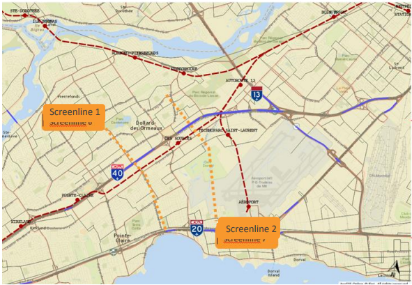

Oh, one more detail you may have missed. The route to the airport has changed.
They won't be doing a circuit around to come in from the south. Instead they are going to give up on the station under the US terminal and build a brand new station under the parking lot. A bit of a waste, but it means they are coming straight through, and more importantly means there's nothing stopping them from adding an extension later on southwards towards Dorval Rail station.
That's a great way to connect with VIA rail trains coming from QC ottawa and toronto(making it possible for them to easily fly out), but also greatly improving transit options for everyone living along the south edge of the island.

I thought that servicing the west island was already part of their mandate, which is why there were proposals like this:
Continuing to Dorval would be very useful! Especially if the Train de L'Ouest proposal ever is done. Even with the REM, I think that there is excellent value for money in improving the Vaudreil-Hudson line.
