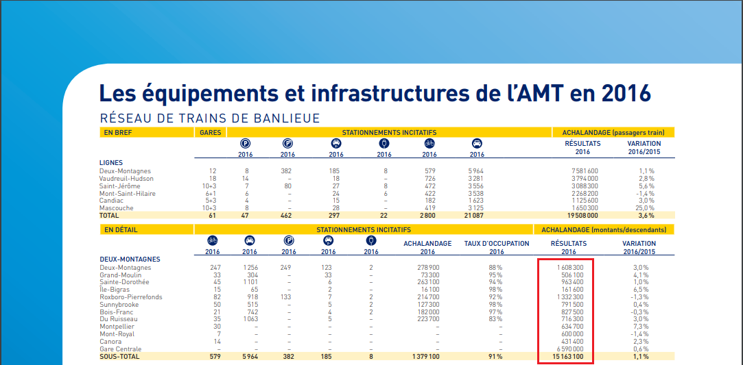

Thank you for making me aware that these figures are actually provided on the following page of the 2016 Annual Report, including the number of passengers boarding/detraining the Deux-Montagnes line at Gare Centrale (6,590,000):
Table 1: 2016 ridership figures provided by the AMT for each station of the Deux-Montagnes line
194695
Source: AMT Annual Report 2016 (p. 44)

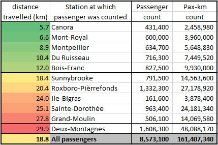

We can now divide the passengers of the Deux-Montagnes line into 2 distinctive groups:
  1. Passengers travelling between Gare Centrale and any other stations
  2. Passengers travelling between any two stations other than Gare Centrale
Thanks to above table, we know the size of group 1 (the 6,590,000 passengers counted at Gare Centrale), which means that the balance to the Deux-Montagnes total ridership must be the size of group 2 (7,581,600 minus 6,590,000 equals 991,400).
If we now take the passenger figures of all stations other than Gare Centrale and pretend that all these passengers travel to Gare Centrale, we indeed get an average distance of 18.8 km:
Table 2: Passenger and passenger mile count of all passengers counted at stations other than Gare Centrale (and assuming they all fall into Group 1)
194743
Source: compiled with figures from Table 1
Obviously, the total of above passengers is overstating the known number of Group 1 passengers, as it has to match the passenger count at Gare Centrale. Therefore, we have to remove 991,400 trips (or 1,982,800 passenger counts) from above table. In absence of an origin-destination matrix with the exact passenger counts for every possible O-D pair, we will have to arbitrarily remove 1,982,800 passenger counts from above table. However, even though it's impossible to determine the exact passenger-km count for Group 1 passengers to calculate the average trip length, it is easy to define the upper and lower bounds for the latter, as we can remove the passengers from either end of the line:

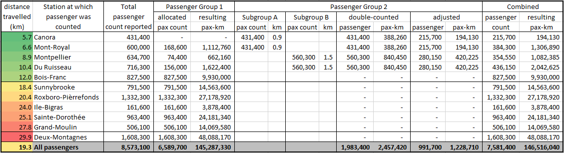

For the upper-bound of the average trip length, we have to add up the passenger counts starting with the station nearest to Gare Centrale until we've reached the passenger count for Group 2 (i.e. 1,982,800). Then we have to figure out how to remove that number from the 2,382,400 passengers which were counted at either Canora, Mont-Royal, Montpellier and Du Ruisseau, while minimizing the number of passenger miles: as it just happens, the first two stations (Canora and Mont-Royal) happen to have the shortest spacing between any 2 stations along the line (0.9 km), while the next two stations (Montpellier and Du Ruisseau) are not much further apart (1.5 km), which means that our 991,700 Group 2 trips will be the 431,400 passengers counted at Canora (assumed to travel between Canora and Mont-Royal as "Subgroup A"), while the balance will be assumed to be trips between Montpellier and Du Ruisseau (as "Subgroup B"). This results in an upper-bound average trip length of 19.3 km on the Deux-Montagnes line, derived from a passenger-mileage figure of 146.5 million:
Table 3: Calculation of the upper-bound for the average trip length on the Deux-Montagnes line (in 2016)
194750
Adapted from: Table 2
Note: Above tables excludes the passenger counts at Gare Centrale, which are a double-count of the passenger count of Passenger Group 1, while the passenger counts for Group 2 are adjusted (by dividing them by 2), in order to avoid a double count.

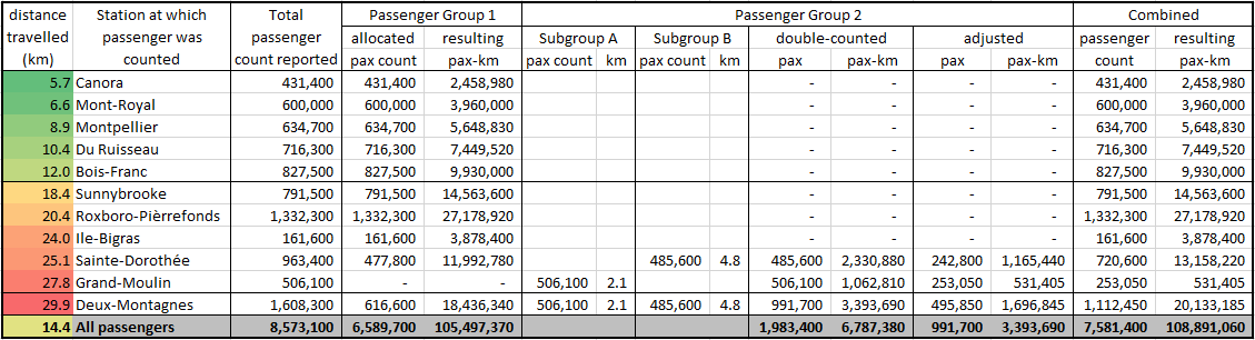

Conversely, for the lower-bound of the average trip length, we have to add up the passenger counts starting with the station furthest away from Gare Centrale until we've reached the passenger count for Group 2 (i.e. 1,982,800). However, even though Grand-Moulin and Deux-Montagnes already share more than 2 million passenger counts between them, we also have to include Sainte-Dorothée as there are not more than 506,100 trips which can be removed from Grand-Moulin. Therefore, we have to figure out how to remove 1,982,200 passenger counts from the 3,077,800 passengers which were counted at these three stations, while maximizing the number of passenger miles: we therefore treat the 506,100 trips counted at Grand-Moulin as "Subgroup A" trips between Grand-Moulin and Deux-Montagnes and the balance as "Subgroup B" trips between Sainte-Dorothée and Deux-Montagnes. This results in a lower-bound average trip length of 14.4 km on the Deux-Montagnes line, derived from a passenger-mileage figure of 108.9 million:
Table 4: Calculation of the lower-bound for the average trip length on the Deux-Montagnes line (in 2016)
194752

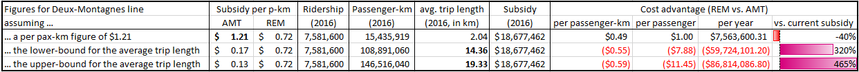

Given that I travelled between Grand-Moulin and Mont-Royal at least once in 2016, we know that both, the upper and the lower bounds, do not accurately reflect the actual average trip length. However, we do know that the actual figure has to be between these values and with the upper-bound being only just over one-third (34.6%) higher than the lower-bound, we have a good idea of where that figure actually lies. If we update Table 7 of my previous post, the current operating subsidy per passenger-km figure is neither $0.44 or $0.26, but rather $0.13-$0.17:
Table 5: Financial effect of the various per passenger-km subsidy figures on the REM's relative cost-effectiveness
194753
Adapted from: Table 7 of my previous post with the average trip length figures from Tables 3 and 4 in this post
One should note that the REM's $0.72 figure is a marginal figure, whereas the AMT's operating subsidy of $0.13-$0.17 is an average figure, which means that attracting one additional rider travelling the Deux-Montagnes line end-to-end will increase the REM's operating subsidy by $21.23, whereas it is probably only a few cents (i.e. whatever marginal costs transporting an additional ~100 kg over 29.9 km causes) with the AMT. Let that sink for a moment...
