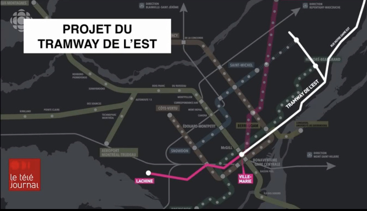

Here's a map of the new transit line (again REM or LRT will be decided next year by the CDPQi). The white lines are the first phase of the new "pink line" project, the remainder of the pink line will be an extension of the first phase. From gabmtl on mtlurb

It's only two branches East? The REM phase 1 is also three branches West and one South though.
You said the white lines are are the first phase of the new "pink line" project ... with the remainder (the two pink legs) being later. That would give you four legs, looking at that figure.
Population density is much higher in the eastern half of the island
I know ... but more legs gives you less frequent service. If all service runs through, then you have more frequent service where there's one left, in the west.
Ah, I can see the confusion now. The East part of the original pink line is not in scope, the QC government has refused to finance or study the diagonal branch because of costs. It would in theory be replace by the two other branches in white.
The "Tramway de l'Est" (which could be a LRT or REM, we don't know yet) and the diagonal pink line are two separate projects. It's the western branch of the pink line that they decided to merge with the Tramway de l'Est.
The city of Montreal is conducting separate studies to determine if the diagonal line is justified, and what the cost would be. The mayor is hoping that these studies will eventually convince the government to proceed with the diagonal line too.
Not sure why it's called Pink line then ... those two white tram branches have been studied before ... and the west branch seems to be aspirational.
Who's financing/building the Lachine tramway? CDPQi? Is that what the QC government is now promising to finance now that MTL is giving out $800 million to the Quebec City tramway? I'm confused.
Not known until next year. And yes it's what the QC government is promising.
