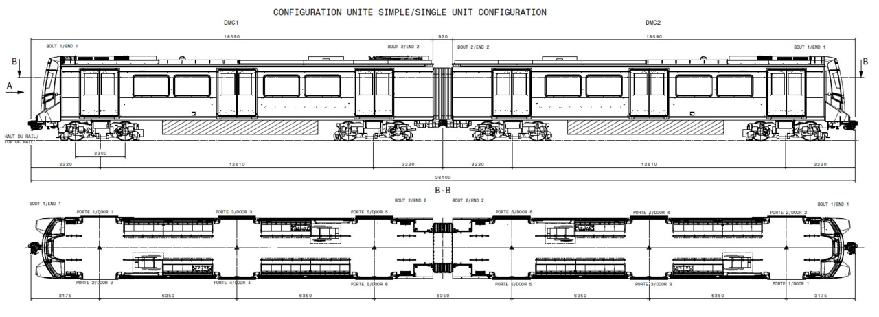

As an aside, it's interesting to compare the reported dimensions, capacity, and seating of the REM rolling stock to the newest Toronto subway TR cars.
The REM rolling stock uses 2.95-metre wide cars that are 19.05 metres long. They will run in 4-car consists (two pairs) giving a 76.2-metre long train. Each train has 128 seats.
The TTC TR trains use 3.12-metre wide cars that are 23.19 metres long. They run in either 4-car consists (Line 4) giving a 92.8-metre long train with 256 seats or a 6-car consist (Line 1) giving a 139.1-metre long train with 392 seats.
For capacity let's compare the shorter 4-car Line 4 TTC trains.
With a peak capacity of 600, the REM has 2.67 riders/m² compared to 2.57 riders/m² on the 740-passenger TTC train. However with 128 seats compared to 256 seats, only 21% are seated on the REM compared to 35% on the TTC.
With a crush capacity of 780, the REM has 3.47 riders/m² compared to 3.28 riders/m² on the 950-passenger TTC train¹.
The additional capacity per square metre of the REM trains seems reasonable, as they got a lot less seats per square metre (0.57/m² on the REM compared to 0.87/m² on the TTC TR).
Here's the REM floor plan for a 2-car pair:
189948
¹ Based on the Bombardier numbers of 165 standing in a A (cab) car, and 182 standing in a B/C car, and the TTC numbers of 60 seats in a cab car and 68 in the other cars. This would give a crush capacity of 1450 for a Line 1 train. Actual capacity might be slightly higher as Bombardier reports 64 seats in cab car, while TTC reports 60; presumably the number of standees is higher with 4 less seats).
