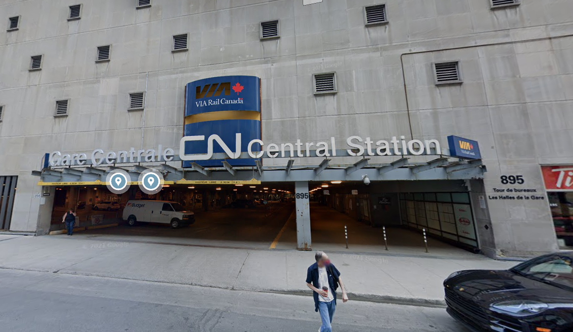

Hmm I always call it Gare Centrale versus Central Station. I wouldn't even be able to tell you why.
Well they should all stop somewhere under all circumstances. And that's likely Central Station (which is still called Central Station in English).
It usually is out of respect for the local population and their language that I try to use local names and spellings wherever practical. Granted, French speaking people tend to be particularly ignorant of that rule (Londres, Columbie-Britanique, CTT [for Commission des Transports de Toronto] and Vladimir Poutine, anyone?), but to me as a germano- and anglophone living in Montréal, I generally use French names, as I treat English names here only as courtesy translations for tourists. I of course understand “Central Station”, but I would never use that name myself to describe VIA’s Montreal downtown station.

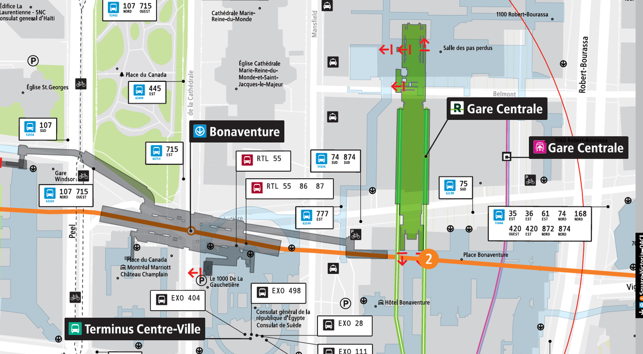

Transferring to the Metro isn't as simple. You have to stumble your way though the maze kinda like Union Station trains to subway.
Union Station to the subway is pretty easy if you know the station. You just come out in the Bay concourse and go down the escalator, through the doors, and voila - the subway.
Even knowing the layout in Montreal won't help you get to the subway fast. Though if they ever (or have they?) open the direct connection from the REM platforms to Place Bonaventure, then that would be at least less maze-like - but still a bit of a walk. But will that connection work for everyone in the station, or those on the REM platform - are there fare-gates in the way? Gosh, on the STM (MTC! :)) it shows they've opened it. Does that mean there's finally wheelchair access between Metro Bonaventure and Central Station?
In retrospect, they'd have been better off building Metro Bonaventure where Place Bonaventure is.
I'd guess the idea was to connect to both Central Station and Windsor Station. Ironically it's a much better connection to Windsor.
There always was: through a tiny unmarked elevator into the Mariott hotel.
Agreed.
I doubt there was any consideration of intercity rail and its stations when the Métro de Montréal was conceived and built…

Calling Central station a direct connection to the Green Line is pushing it. Also, Union Station has no direct connection to Line 2.
Everything was fine with Gare Centrale and Windsor Station. The two cardinal sins were closing Windsor Station (and building Centre Bell over its platform tracks) and sacrificing the Mont-Royal tunnel for the REM.
Bonaventure was much better situation, with a straight line connection to the CN track at St. Henri and the Turcot yards, and access to the bridge to the south shore. And a short walk to Windsor station. The tunnel could have curved into Bonaventure.
The one that's been there since ... well at least the 1970s, I think it was from the 1960s. And I used it in the 1980s. Well yes, I guess it gets you to the street and nothing more (unless something has changed).
That tunnel right to in front of the entrance to Windsor station was certainly planned. Why there wasn't better access to Central I don't know. And up into Place Bonaventure, and then back around up and up and down into the passage, and up into Central was just bizarre - couldn't they have simply connected directly into the same spot? Back in the day, I simply jay-walked across the street to the same location. And still a trek.
