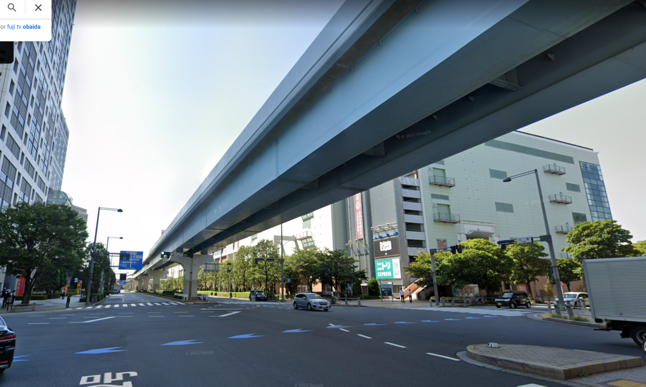

Not sure how resilient they are. But not sure the fact that they use single piers is inherently bad.
They those pier spans in Tokyo.
The Yurikamome line: (Google)
Tokyo Monorail:
