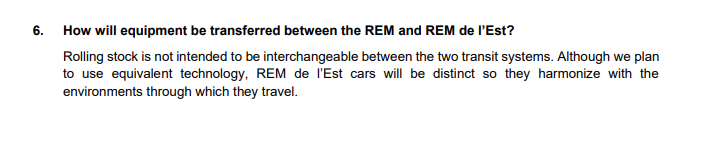

Thats actually not true, the two systems will not be compatible
Well I use the term "compatible" loosely here. I know that they won't actually be connected, and technically since REM Est will have 40m long cars, you wouldn't be able to through run in most circumstances, but my point was that it is the exact same technology and very similar build standards. Theoretically if you would connect the tracks up and update the automation, you could would be able to run trains through if you did something about the different platform lengths.

Ye, there is genuinely no way in hell they're doing 3rd rail. They have outright said they will be using the same rolling stock as REM A, which is pantograph.
I doubt they'll use third rail. But why are you claiming they have said they'll be using the same rolling stock, when it's been pointed out already that they've said no such thing.
(if I'm wrong, provide a link please)
