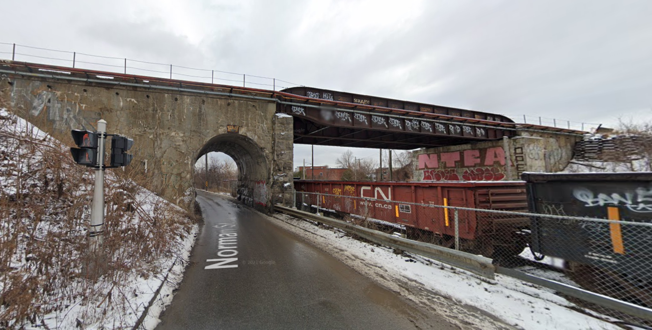

Would be cool though, to see VIA trains stopping at Parc station. and along by the Port. Hmm, I wonder if there's a way to get the VIA service onto the CP line at Montreal West, instead of the CN line through the yard. Topography there would be difficult where the CP and CN lines cross near Norman Street.
