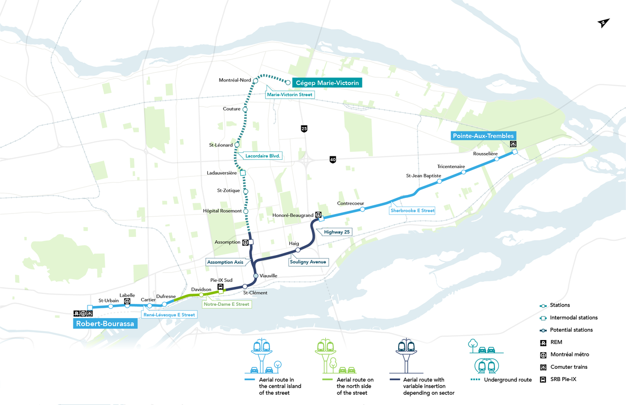

The updated map:
This seems a ... backward way of planning new rapid transit - turning up with a suspiciously fixed proposal with route, station locations, where to build elevated/underground etc.

ironically the entire Montreal-North section will be underground. No luck for the downtown part.

Has a real Toronto vibe to it. Elevated Ontario Line through the downtown east, buried LRT and subways in the suburbs.
At least the real downtown part of the OL is underground.
Honestly, they should switch to using Citidas LRTs and have the Montreal-North section as dedicated ROW LRT, as that area was originally envisioned, and use the savings for a tunnel downtown. The only reason they are tunneling there is because they cant elevate, but thats a sorry excuse to tunnel. Theres not the density there for the cost of tunneling.

The real problem with REM de l'Est is really that it doesn't integrate with any of the mass transit network downtown, not even the original REM. It simply doesn't make sense... It also doesn't serve any underserved areas until it reaches the end of the Green or the Blue metro lines, which is the very ends of the REM project. The idea is good, but it won't have a big impact on the rest of Greater Montreal. It's also impossible to extend at the Robert-Bourassa station, which means we'll have to live with a dead end downtown forever... Talk about streetscape... Not to mention that stations downtown are not optimally located to have any meaningful impact... I don't know of many people from Pointe-aux-Trembles or Montreal-North who want to go to René-Lévesque/Saint-Laurent (which is an empty intersection next to Chinatown at the moment)...
However, this is not the Caisse's fault. They're allowed to not be willing to participate in a tunnelling project downtown. It's their money and they do have to mitigate their exposure to risk. It's the government that should put it's pants on and pay for this and instead decided to hide behind the Caisse's silly technical arguments...

I feel like people are grossly overexaggerating the transfer distances downtown. RB is 130m away from Centrale. While its not the most ideal transfer distance, its definitely manageable. Its just slightly longer than the transfer at Spadina Station in Toronto, and quite a bit shorter than many of the downtown interchange stations in cities like Moscow and London.

It's not about distance. It's about integration, not only with transit, but also with RÉSO and the rest of downtown. What makes downtown Montreal pretty great as a matter of efficiency is that everything is connected, whether it's the shopping malls, the métro stations, theaters or large office buildings. The REM B project doesn't catch on to that, and I feel like it's a mistake.
"Labelle" station for example, is a 200m walk from Berri-UQAM, one block east of Berri St. No connection is proposed, apart from walking outside. What if that station was located 2-3 blocks west, and connected with UQAM and the CHUM megahospital, which are themselves connected via RÉSO to 2 subway stations (Berri-UQAM and Champs-de-Mars), wouldn't that make more sense?
"Saint-Urbain" station is planned to be located at the corner of René-Lévesque and Saint-Laurent (which is actually 3 blocks east of Saint-Urbain). There's nothing at this intersection. It's the entrance to Chinatown and a hotel... What if it was located 2-3 blocks west as well, right between Complexe Desjardins and Complexe Guy-Favreau? It could have connections to RÉSO, the convention centre, the largest federal government building in Montreal, Place-des-Arts and a shopping mall. Wouldn't that make more sense?
And finally, Robert-Bourassa... It would make a lot more sense if they built that station further west, even one block would suffice. The only reason why they can't do that is because René-Lévesque is actually a bridge, and it's not designed to carry the weight of an elevated guideway. So because of that, we'll end up with a terminal station (with no possibility of extending it west) that is not optimally located (the most traffic generating areas of downtown are just 2 blocks west of there), and will not be able to provide any sort of good connections to other transit lines or office towers except for Place-Ville-Marie.
As I said, I'm not really against this project, I just think it's poorly planned and rushed for no reasons. The provincial government needs to be willing to invest and ensure that the needs of the East end are well served, because the Caisse certainly won't be thinking about that (it's not their mandate anyway)

Keep in mind that CDPQi has not released the detailed design specs yet, in terms of how the stations will be laid out. The final plan may very well change from what you are seeing today, possibly with additional stations and even an underground alignment for downtown. This has been the case with REM-A as well - they made significant changes post public consultation.
