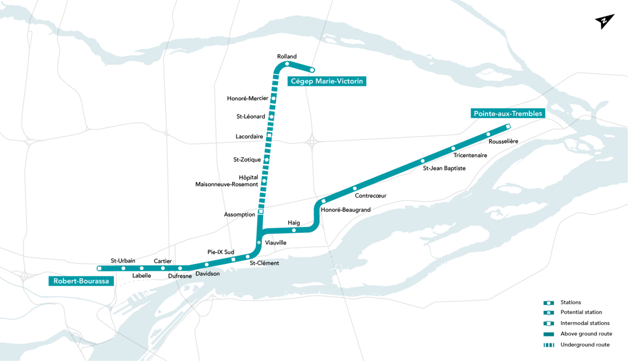

REM East: Fully Automated, 2-car 40m trains, branched in suburbs, ~30% underground, rest is elevated, 2-minute headway, replaced a tram plan.

Hang on - REM East is 30% underground? Somehow I'd missed that. Where?
Only a branch of the Canada line goes the the airport so the frequencies there are lower from what I understand. Rem is underground through downtown and under mount royale, though it uses existing tunnels not new ones

The connection to Trudeau airport is in the west, as it the tunnel to TMR. The discussion was about the proposed not-under-construction REM line to the east, that doesn't connect to the line currently being built. Which is the 30% of that that is underground?
missed the east part woops
The... north ig, segment of rem east is largely underground.
