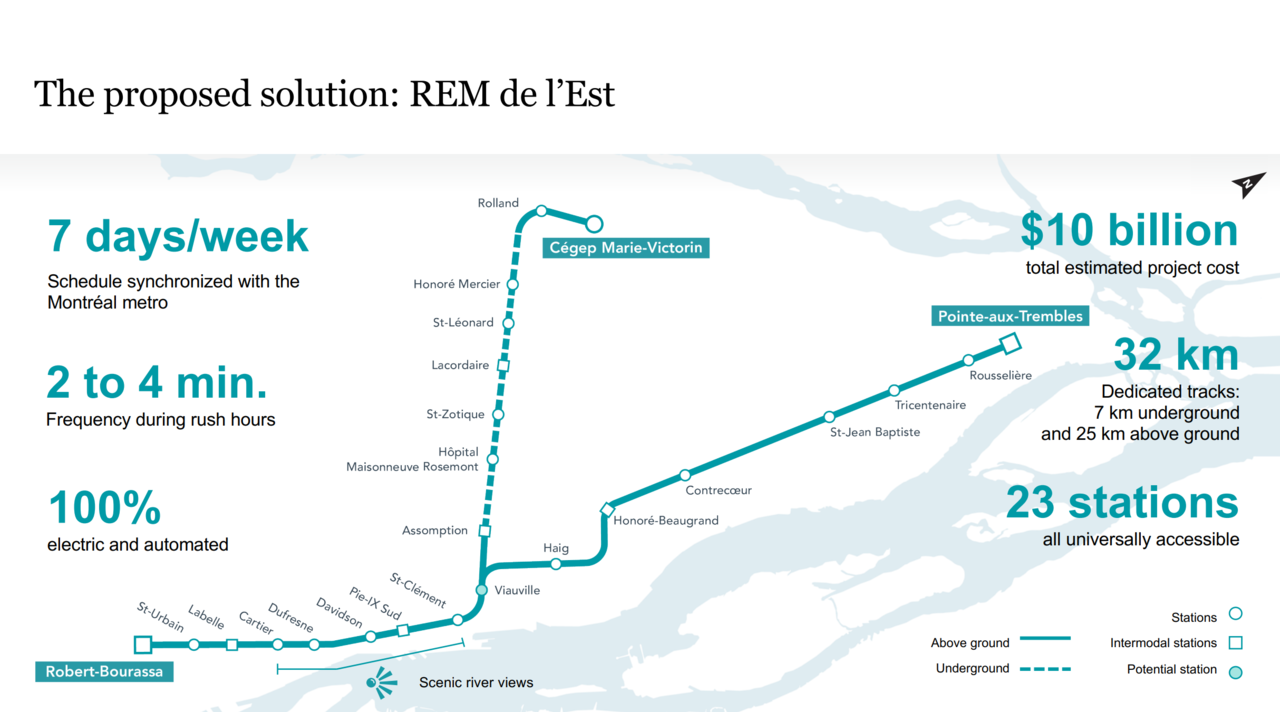

No idea how they're planning to get by with 40m trains, unless the frequency approaches that of the Canada Line. I very much doubt the REM de l'Est will have that kind of frequency, though it's theoretically possible.
The technical brief already said that the trains will come every 2 min in the central section and 4 min in the branches. That is Canada Line frequencies. Elevated and ground-based stations can be expanded relatively easily if it comes to that. So At least one of the branches can be expanded without heavy costs. (Look at the London DLR) But I am hoping that the underground stations will be built with longer trains in mind.

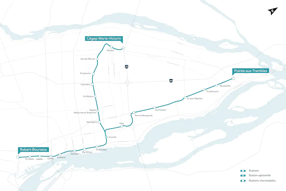

The northern terminus of the Montreal North branch is unclear. They say at Cegep Marie-Victorin, but the figure makes it look like just west of the Anjou Exo station. But they don't show an intermodal connection.
The driving route from Cegep Marie-Victorin to Central Station is interesting. Does anyone really drive that way (south on the 25, west on the Metropolitan, and then down Decarie and the Ville Marie) ? I suppose it's the only expressway route - but I take the 25, Souligny, Dickson and Notre Dame - or possibly St. Laurent and Park from the Met. I don't think whoever did graphic has driven down Decarie and between the 15s very often!

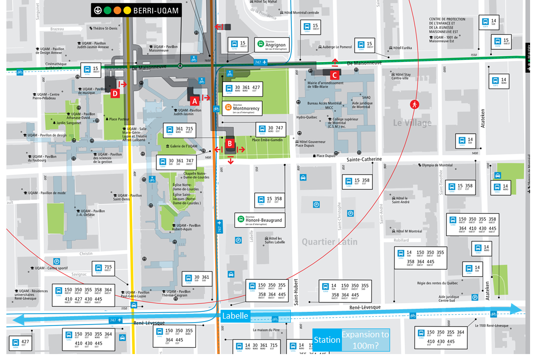

I would not bet on them adding anew station to the Metro. The images in the technical brief clearly shows the whole downtown segment is elevated. Berri-UQAM's closest entrance on Berri is a good 200m away from Rene Levesque/Labelle. It probably will be an elevated pathway of some sort. Or maybe a pathway to the closest underground path. (The university?) It is still possible to create an underground passage under the road. I have seen it done for Riyadh Metro. But Is very disruptive can add costs that the elevated alignment was meant to avoid. So I wonder what they will choose.
Given the station name, Labelle Station will probably is about here:
Canada Line at peak is only every 3 minutes, with 6 minutes on the branches. Dropping as low as 10 minutes, with every 20 minutes on the branches off-peak. So they could still, in theory, double their capacity if they obtain more vehicles (though going from every 120 seconds to every 90 seconds never seems as easy as they make out in reality). And this is after 10-years of operations, they've already added additional vehicles already.
If they are planning every 2 minutes at peak, for day 1, I'd be very, very concerned about long-term capacity. That doesn't give them much room to grow, compared to starting out at every 5-6 minutes

I would have thought they wouldn't add one either. But at the same time, they clearly say in that document that there are transfers to the Blue, Orange, and Green lines. But otherwise, Orange would only be at Berri (or Place-des-Armes/St. Urbain I suppose - probably a similar walk). They explicitly didn't say Yellow, which is also at Berri (though a longer walk once you are inside ... but I'd have thought they'd have mentioned it, if the intention was to only transfer to Orange at Berri.
At the same time, adding undergroundMetro stations doesn't seem to be part of their business model. Has there ever been a discussion of adding one here before - the tracks look amazingly straight now I look at them, north of de la Gauchtierre. And it's surely very shallow, given how shallow it is at both Berri and especially at Champ-de-Mars.
There's certainly been talking about adding a Bonsecours station at St. Antoine/St. Denis/Bonsecours - but the Yellow line is so very deep and sloped there, that it would be very expensive.

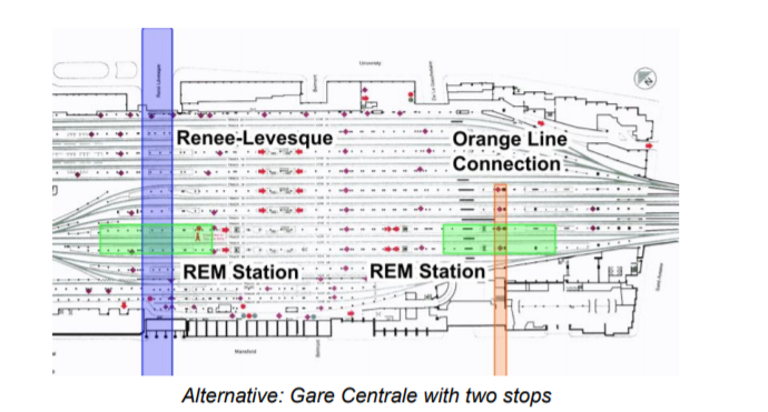

The connection from Central to the terminus should be pretty simple. Hopefully the final station is underground, but I"m sure they could have some long escalators from elevated as well, if they are willing to sacrifice road lanes.
A bigger issue is the connection to the Metro at the terminus. Their figure makes it look like Central and Bonaventure are a single station. In reality, parts of Central are as close to Square-Victoria, and honestly, the slighter walk from McGill to Central seems simpler, as it's so much shallower than Bonaventure. I find the excellent STM downtown map (see below) very good at showing the relative locations of things.

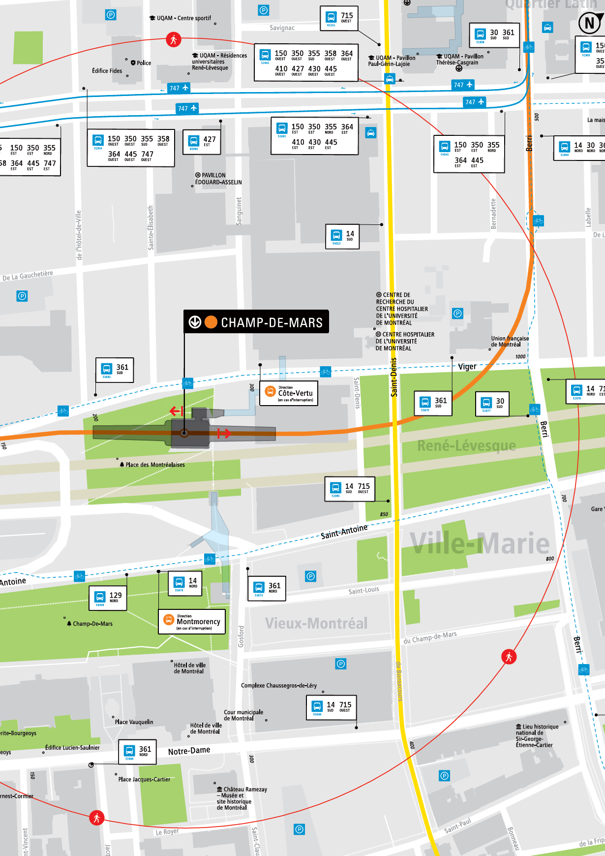

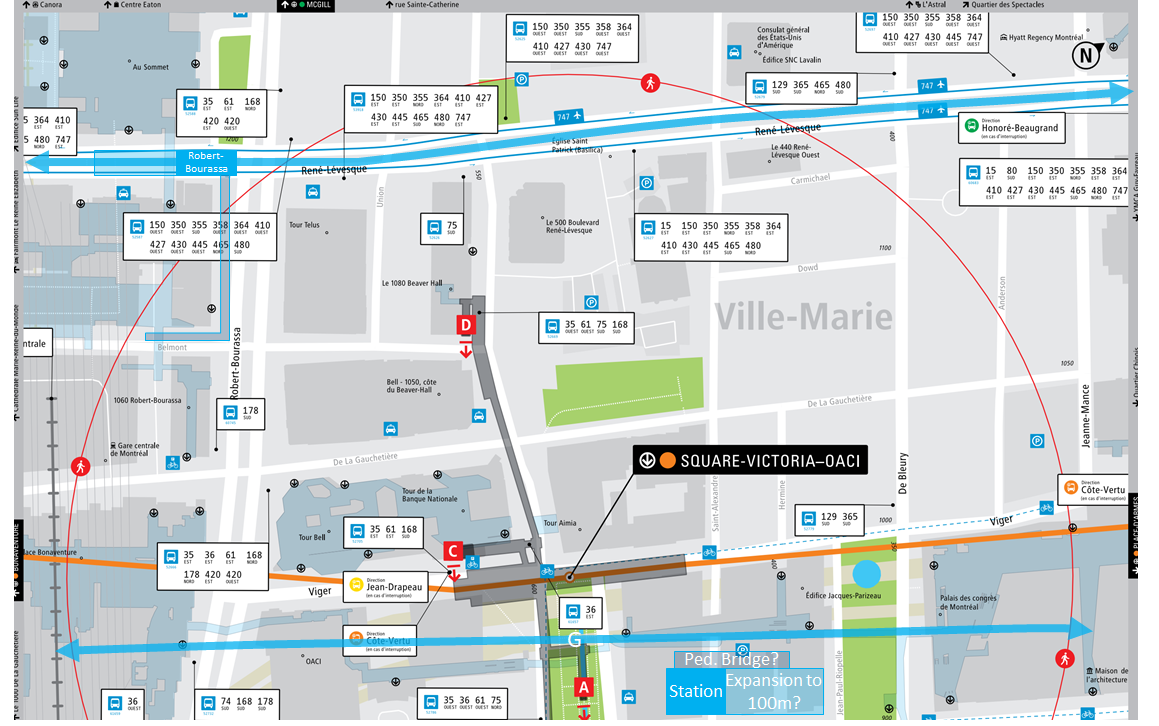

René-Lévesque is not directly served by the metro for a good reason: it's too far from the metro stations. The closest official metro exits are at Beaver Hall (part of Square Victoria station) or at Windsor station (which is part of Bonaventure station). The REM running in that right of way doesn't solve that issue. That's why I think the better way to provide connections downtown is through the RESO.
The "Labelle" station should be located 2 blocks west at the intersection with Saint-Denis, where it could provide a connection to the CHUM super hospital on its south side (itself connected to the Champs-de-Mars orange line station) and UQAM just north of the station (connected to Berri-UQAM and the orange, green and yellow lines).
The "Saint-Urbain" station could easily connect to the Complexe Desjardins shopping mall to the north (connected to Place-des-Arts green line metro) and the Guy-Favreau complex and the Montreal convention centre to the south (both are connected to the Place d'Armes orange line metro station).
Finally the "Robert-Bourassa" stop can have a connection to Central station (where it's not so complicated to reach the REM Gare Centrale stop and further south the Bonaventure orange line metro) and Place Ville-Marie (connected to the green line McGill station further north). Also, the Beaver Hall exit of Square Victoria metro is not too too far from there, so that could also be a possibility.

I've seen some documents showing the layout of Grand-Centrale REM station, and from what I can tell they're making the connection to Bonaventure station quite quick and convenient.
