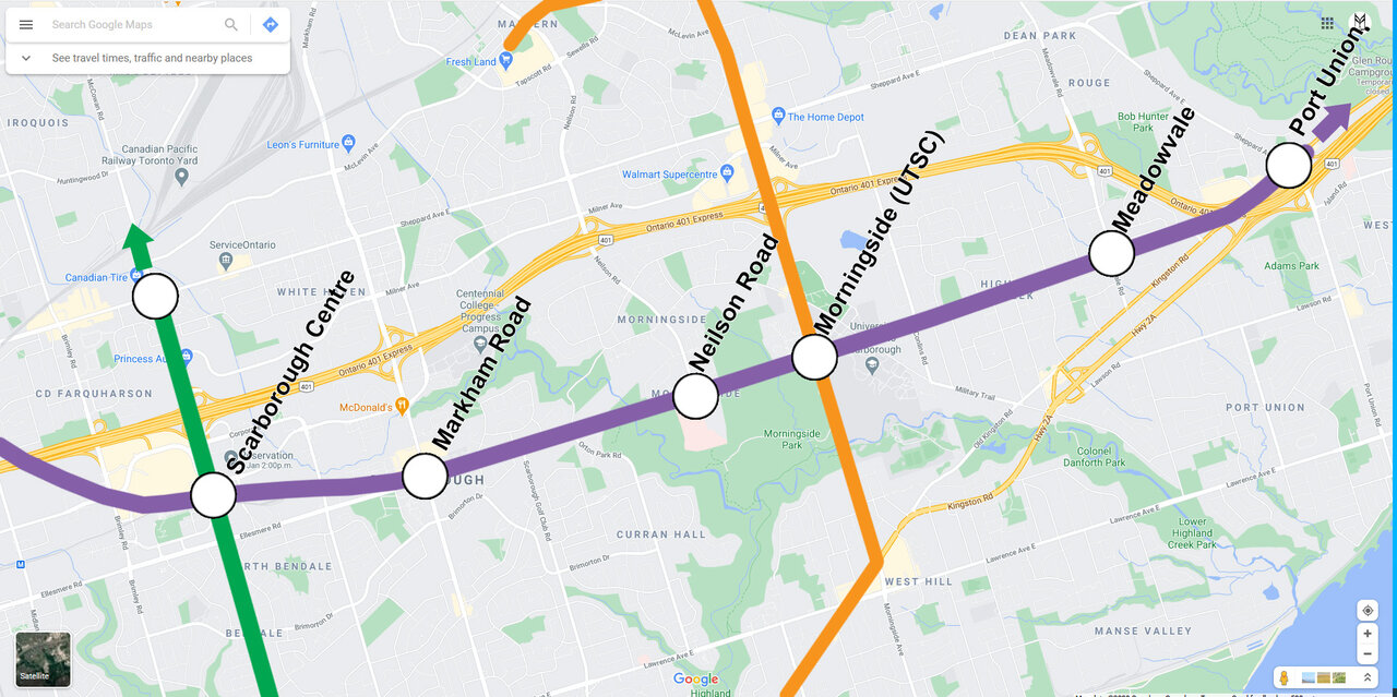

If you wanted to make the case for extending the Sheppard Line east past STC then it could look something like this. Obviously we should focus on getting the line to STC first but I believe STC and Ellesmere offer better expansion potential.
Hmm.. I don't think Ellesmere/Kingston will ever need a subway. The current proposal for a BRT on Ellesmere will be much better and efficient.

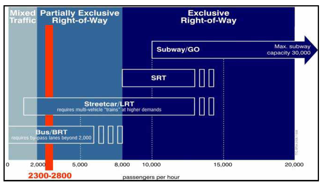

Even at peak they are only scheduling trains every 10 minutes for the Dorval and West Island branches. That's 3,600 passengers an hour. No where near heavy rail territory. Ultimate capacity is 10 trains an hour. 7,200 passengers an hour for both Dorval and West Island. Still light rail capacity.
They officially call it LRT. It's on the low end of LRT capacity for 2 of the 3 branches.
And that's for the REM lines with the longer trains. For the new east-west line with the 40-metre trains, assuming they use the same vehicles, Ultimate capacity is 300 passengers per train with 20 trains an hour. That's 6,000 passengers an hour.
If they use the narrow vehicles like they use on most of the Skytrain lines in Vancouver, then that's 175 passengers per train and an ultimate capacity of 3,500 passengers per hour.
At the end of the day - light rail is a bad term that has too many meanings to people!
I've seen it as a function of capacity.
I've seen it as a function of vehicle type.
I've seen it as a function of grade separation.
I've seen it as a function of Google translate translating light metro/light train/tram as "light rail".
I've seen it as a function of the media calling anything that doesn't look like the aluminum subway trains in Toronto and NYC as light rail.
I've seen it as a function of branding.
I've seen it as a function of 'it's what we call everything else here'.
I've seen it as a function of 'it worked in Portland!'
I've seen it as a function of 'it's not a monorail, but not a subway, and not a diesel train, so I guess we call it light rail'.
Can we not just accept that these things don't have a standard definition that everyone agrees on? and that's it's highly contextual to the time/place/language it's being used within?
That's why its a lazy term for people to be using for REM (or any other project) which is by all accounts not LRT or even really light in a traditional sense
