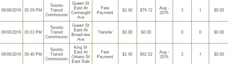

Except that they have made sure that you can't quickly take the same route twice. I certainly saw this during the school year, when my wife would take 2-3 trips every AM shuttling kids back and forth.
Can you provide them again with a screencap of the transaction summary?
Read up the thread. Or here's a new one.
First trip was on 503 East to Queen/Broadview. Second was a transfer to a 504 north up to Gerrard/Broadview. But at Gerrard/Broadview, I got on a eastbound 506, but instead of a free transfer, I got dinged for a new trip beginning at Queen/Connaught.

I might think you took the 501 again (both on Queen St!). If you found out right away, the reloading machine would show what route presto says you took last (I know it tells you about your last bus routes. Not sure about streetcars). I really don't like how that doesn't appear on the website. It would be some much easier to figure out what the transfer didn't work.
