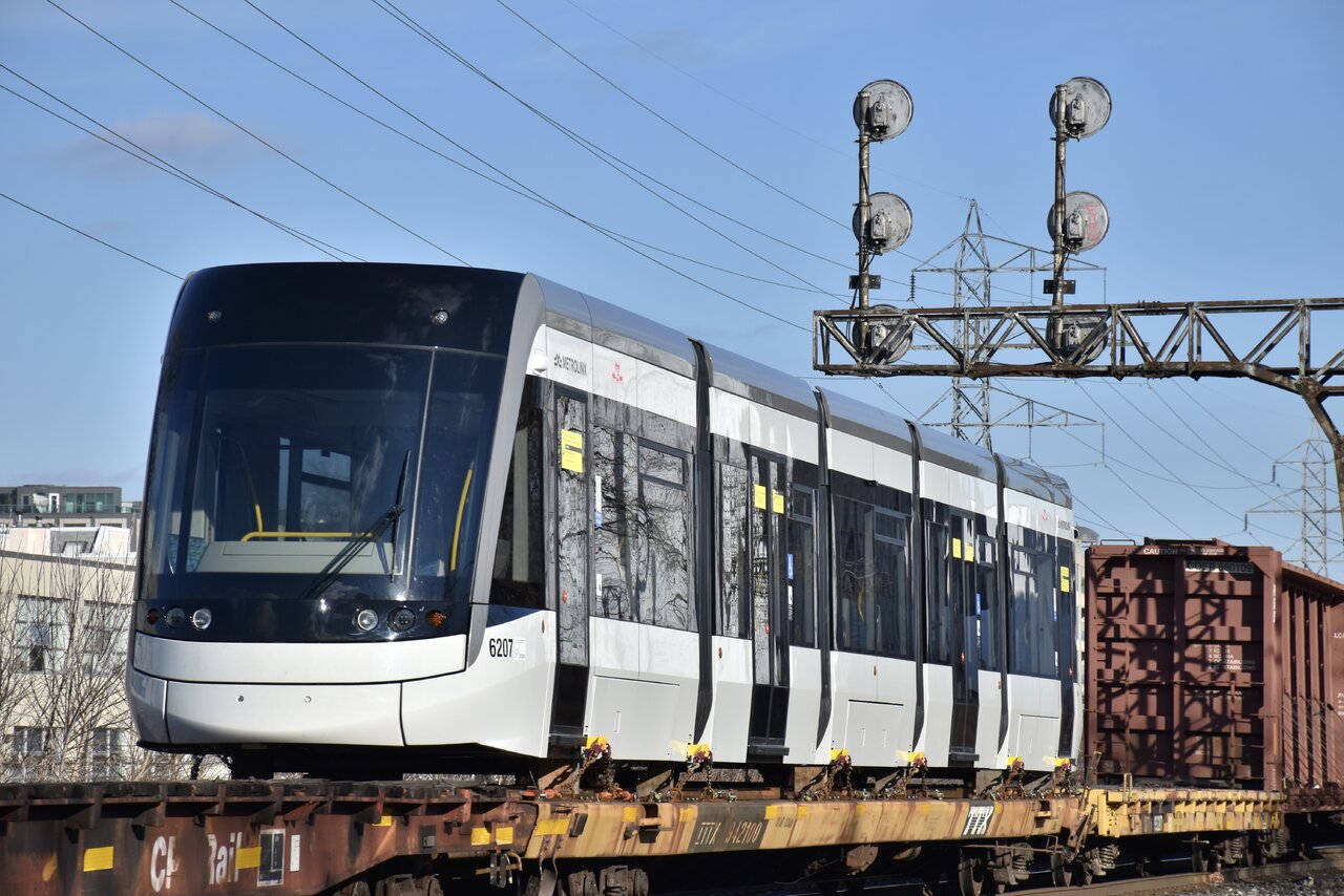

I caught car 6207 on CP today. I assume that it’s headed to Thunder Bay.
The Alstom cars might be new to Canada, but are in service in other parts of the world.
As for stuff like cab heating problems and stuff, that is likely a result of not doing enough cold weather testing.

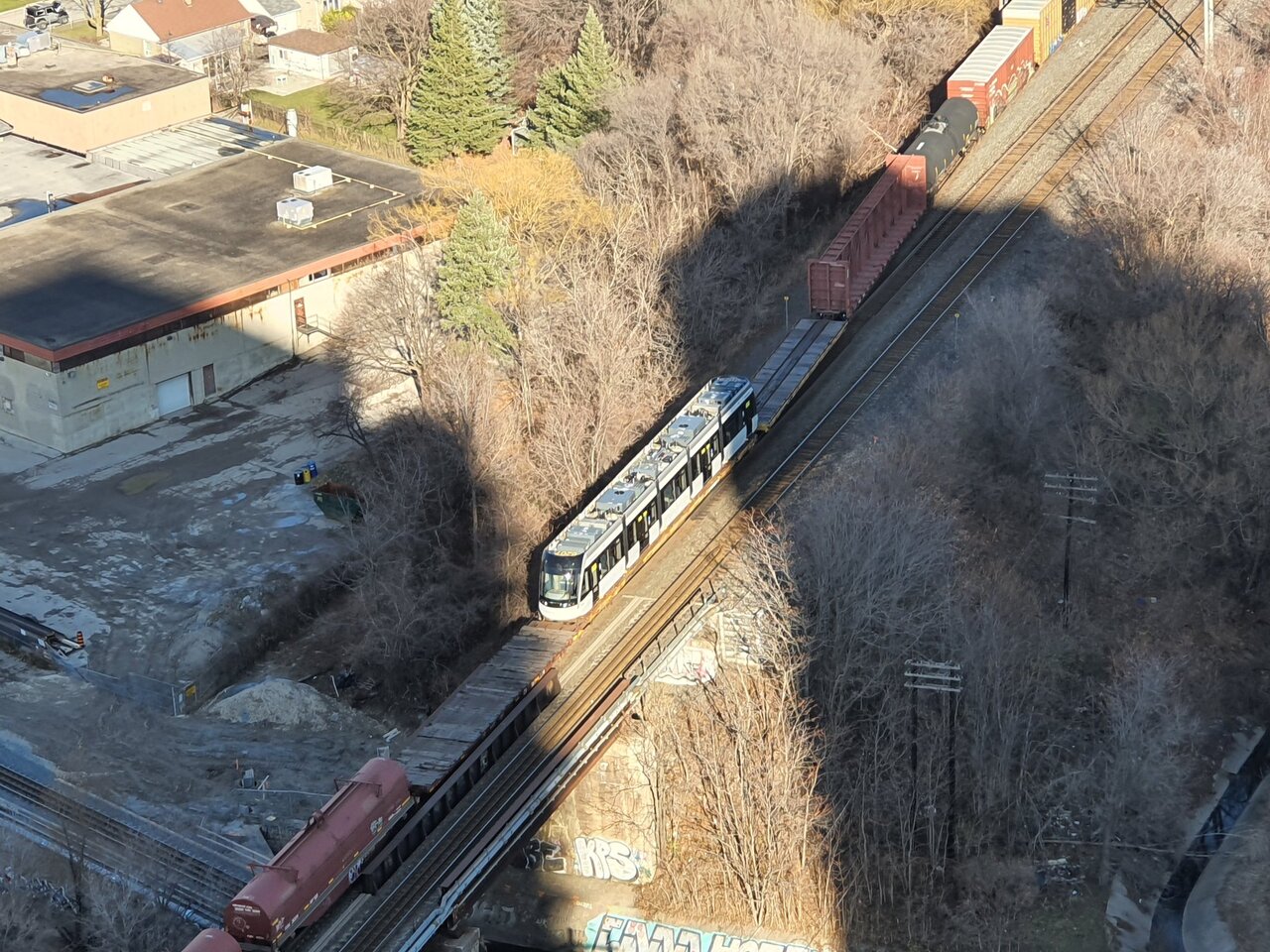

^ I'm trying think of where that is without going on Google Maps cc @Reecemartin
Looks like Scarborough (near the middle of Sheppard, Midland, Highway 401, and Kennedy)
The railway line with the LRV is on a CP Midtown corridor, the railway line on the lower-left corner is the Stouffville Line, and the creek on the lower-right corner is a branch of Highland Creek.
^ Interesting. I would have assumed the CN to CP handover would happen at the CP Lambton Yard (as part of the regular CN-CP transfer?) but I guess some kind of inspection happens at the MSF siding? @smallspy @crs1026

^ The MSF spur runs off CP’s Mactier Sub. It just happens that the connecting track between CP’s Mactier Sub and the ML Weston Sub is within sight of the MSF.
The transfer run from CN at Mac Yard to CP at Lambton comes down the Weston Sub, through the connecting track, and continues down the Mactier Sub into Lambton Yard. If an LRV were to be delivered via CN (as the TTC cars coming back from repairs in Quebec do, also the initial delivery of Crosstown cars from Kingston being shipped to Thunder Bay for finishing work) CN would bring it to Lambton. CP would then have to deliver the car to the MSF.
As for 6207, it is reportedly heading for Thunder Bay. So a CP terminal assignment will pick it up at the MSF, as shown in the picture, take it to Lambton, and perhaps on to Agincourt, to be marshalled into a CP train for Thunder Bay. There is no CN presence in that movement.
My guess would be Avani 1 in Metrogate. If not that, perhaps Selene? It's a fantastic view of two corridors you've got there, @Reecemartin!
