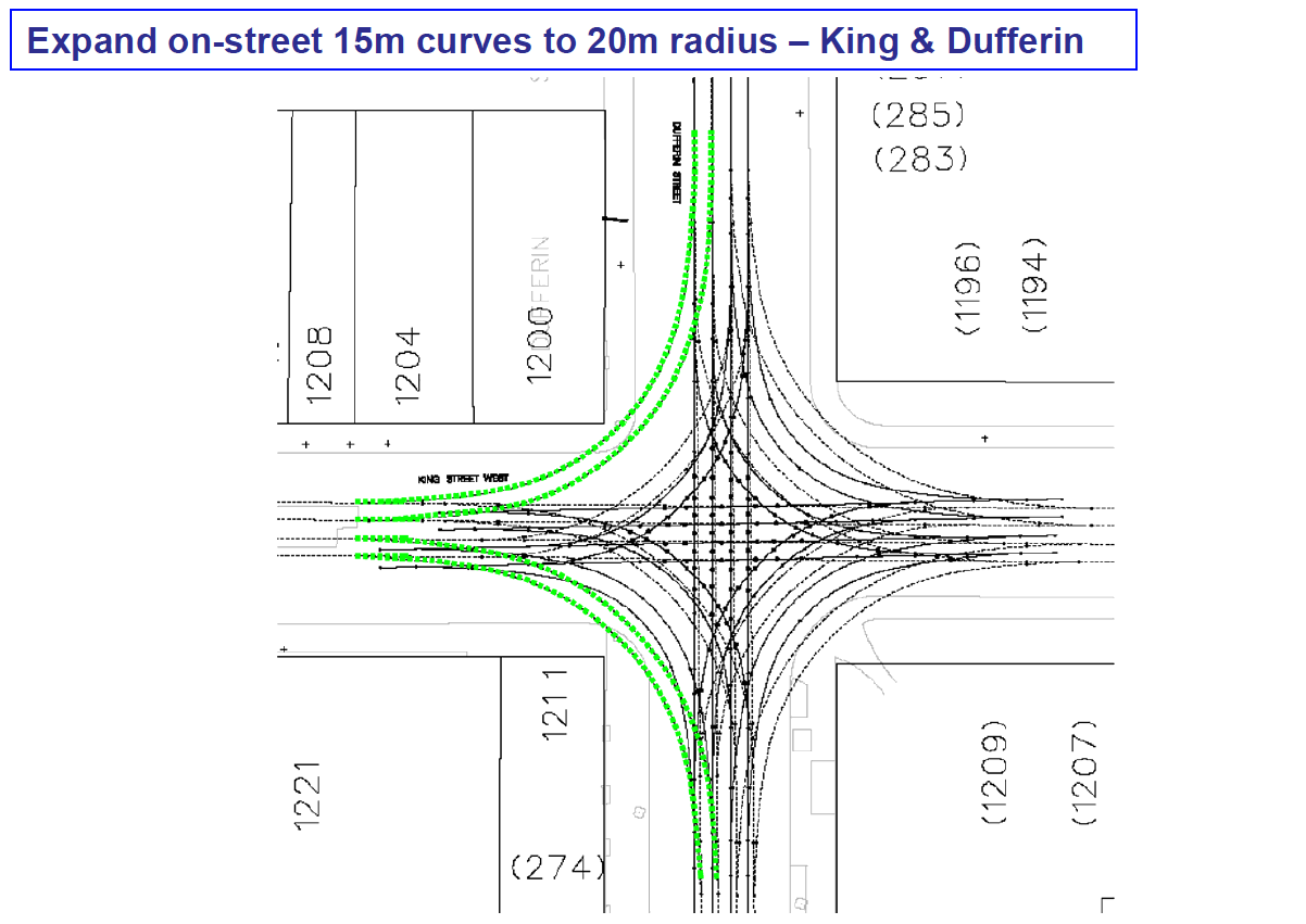

Indeed. Widening curves would in most cases require elimination of sidewalks at intersections and in a few cases even eat into the buildings themselves. There is a profile of a rebuilt King & Dufferin to a 20m radius on page 18. NOTE, 25m radius is LRV standard, so even at 20m radius it would still require some vehicle customization.
Here's the image in question:
174022
