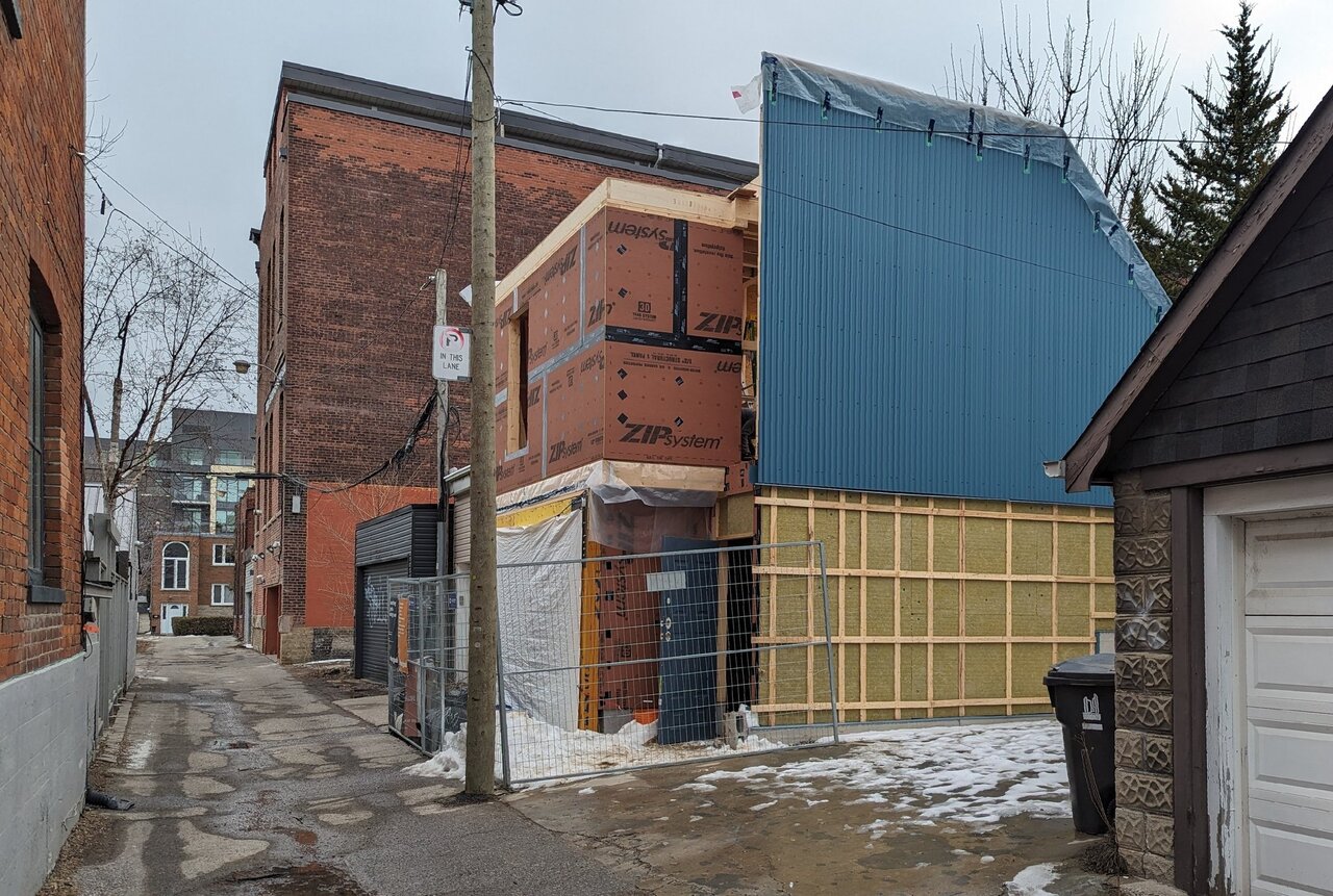

567 EUCLID AVE
To construct a new two-storey ancillary building (laneway suite with a second storey balcony on the southeast corner), in the rear yard of the property, abutting the laneway (Jewish Folk Choir Lane). The existing two-and-one-half-storey semi-detached dwelling will remain unaltered on the site and the existing rear detached garage will be demolished.
