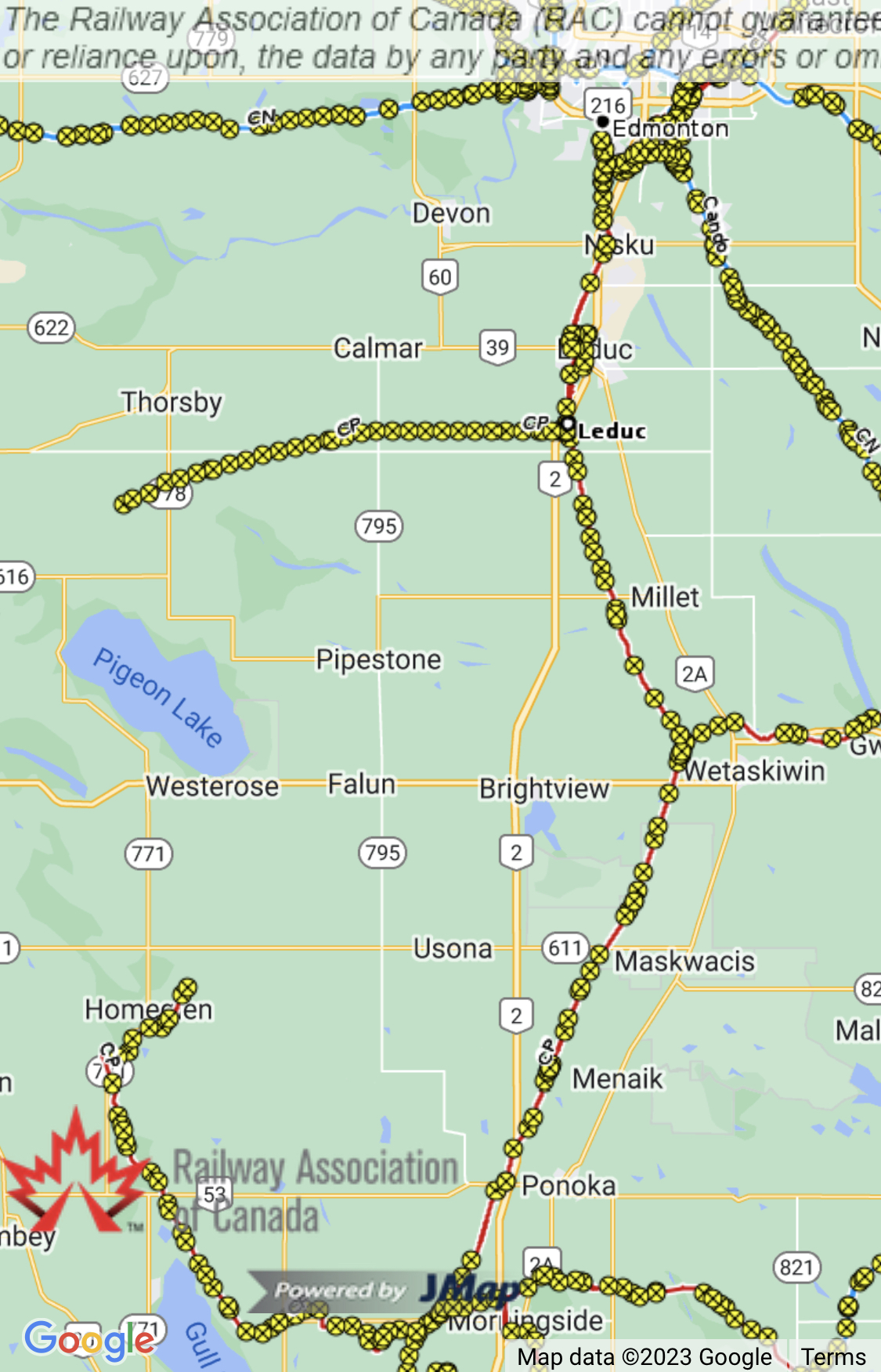

I would like to know if there is any indications that any of those crossings have been improved. If that is all that is needed, it wouldn't be the most horrible thing to spend money on.
Crossings upgrades are only one factor (albeit a major one). Track upgrades are another, as are new stations.

For those who want to count how many level crossings there are between Edmonton and Calgary (and compare that number to Washago-Timmins, where speeds will be much slower), you can count them here:
a lot of these crossings are either a) private driveway or b gravel roads to service the farms, and is also mostly flat flat flat with fairly straight track.. Its not an apple to apple comparison to northern ontario, where the grade crossings are highway 11, local roads within towns, or logging roads while goes through the canadian shield with many curves and grade changes.
