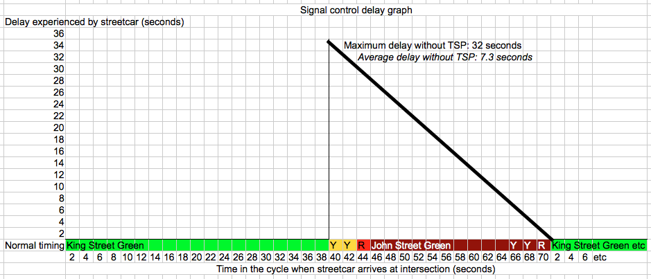

But it's actually not a big deal that truncation is not possible here, because you can get very good results just with 'rudimentary' extended greens.
Assuming a 70-sec cycle length (standard for downtown), here is the chart of streetcar delay throughout the cycle with no TSP:
The worst case scenario is if the streetcar arrives just at the end of the green, in which case it sits through all the clearance and red time*. Each second later that the streetcar arrives, it would have to wait one second less until the next green, until eventually the streetcar arriving just at the start of green has a delay of zero.
The average delay over the 70-second cycle is the total delay (area under the graph, [Max Delay]² /2) divided by the cycle length, which here works out to 7.3 seconds.

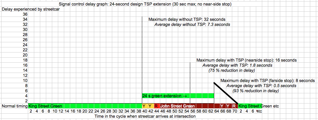

With TSP
The City allows up to 30 seconds of green extension at minor intersections. So before the light changes to yellow, it checks whether there is a streetcar estimated to be less than 30 seconds away and if there is, it will hold the light green until it passes through. The problem is that if the streetcar actually ends up taking longer than 30 seconds, the light would extend to the max and then change to yellow before the streetcar made it through. In that case, TSP has actually increased the delay to the streetcar by 30 seconds because if the green hadn't been extended the light would have been about to turn back to green by then, and instead the streetcar needs to sit through the entire red (this is called a "failed extension").
So to accommodate variability, you need to leave a margin of error. With a near-side stop, there is a huge amount of variability from one streetcar to another, so you may for example leave a 14-second margin of error to minimize failed extensions. So instead of extending for vehicles that are estimated to be less than 30 seconds from the intersection, you would only extend for vehicles estimated to be less than 16 seconds away (in case they actually take longer):
Moving the stops to far-side as has been done with the King Pilot can bring a big improvement by removing the variability of the stop, allowing you to use a much smaller margin of error, and therefore a longer horizon for approaching vehicles. Within the same 30-second maximum, one might now use a 6-second margin of error, allowing the signal to extend for vehicles estimated to be within 24 seconds of the intersection.
THE BOTTOM LINE:
Just using the City's current standard of 30-second maximum green extension along with the new stop layouts, TSP could reduce signal delays by a whopping 93% at John St to an average delay of only 0.5 seconds. I seriously challenge anyone to come up with a different way of prioritizing streetcars that can achieve those kinds of savings without massively screwing over everyone else at the intersection.
With TSP
THE BOTTOM LINE:
