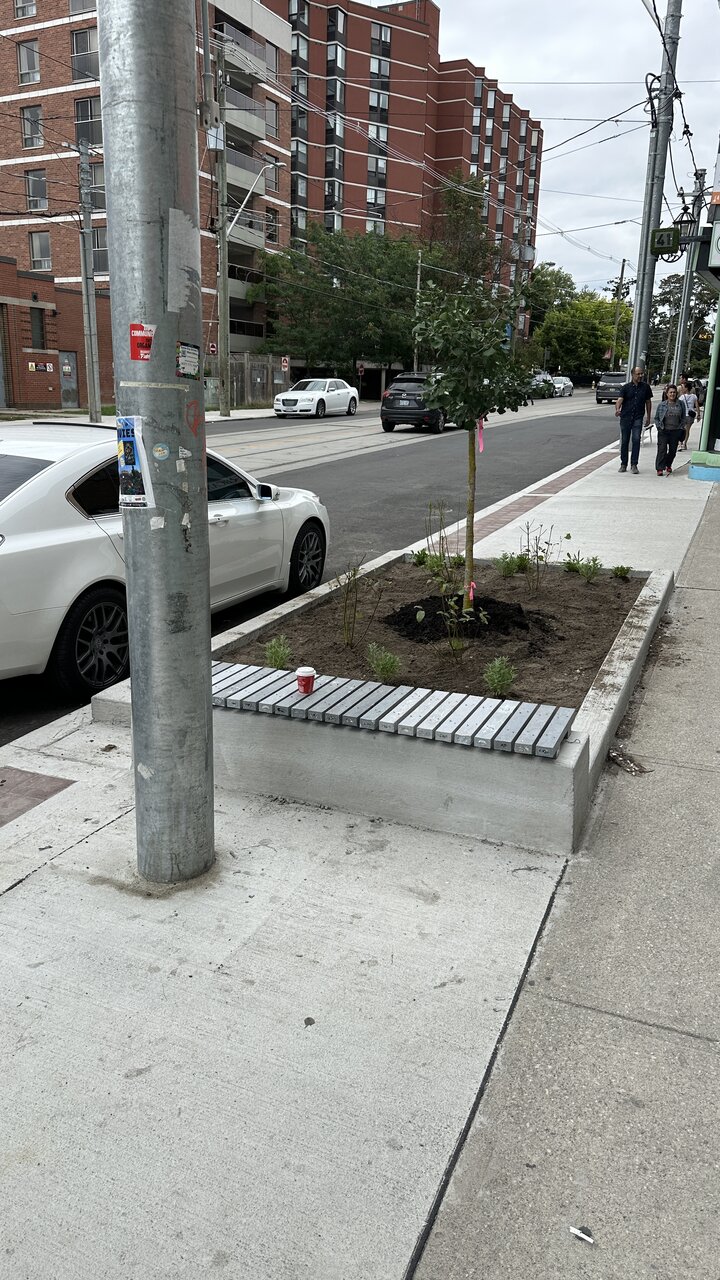

Soil and plants have been added to the planters on Roncesvalles. Benches have been installed as well-- the quality of the work is disappointing to say the least.
The ends are all cut unevenly and the screws are jutting up above the seating surface. The recycled plastic material kind of make it seem like it's covered in bird poop at first glance. And I'm sure people will be clamouring to sit right next to the garbage can. What a joke.

Is that car parked in the bike lane?

@#$!#$@ This makes me mad. They deliver a project more than 12 months late and still make a hash of the details.
On the Garbage Can; please message Councillor Perks and attach the photo and ask for the can to be relocated to a better spot close by. Maybe, you should pick that spot for them and send the photo, lest we end up having to move it twice.
You need to clearly spell out the error here, its not merely that smell, though that too for sure, its that the bench is almost inaccessible for the closeness of the waste receptacle.
Pfft.
On the bench.....the polite word is sloppy...................but I don't understand screwing it from the top, unless the bench came to site fully assembled except for the bracing.
But if it was pre-fab, it should been attached to the bracing in advance anyway........that's not how to do this.
When putting down slats, for a bench, as with decking, if you have a choice, you hide the screws. There are a few ways to do this, depending on the design/assembly.
1) Screw the slats to the bracing on an angle, between the slats.
2) Screw the bracing to the slats from underneath, if you do this, you still need to attach the bracing/last slats to the concrete and those screws will be visible.
Even then, you can hide them by recessing them slightly and using a matching woodgrain covering piece, or contrast them with a small button.
Gah, there are videos all over the internet that show how to do this...........what is this, 1980?
On the plants, hopefully they'll be ok, they're very small at this point, likely late-season, first-year plants that didn't sell in the spring.
I'm not sure that fulfills the obligation in the contract; put simply, If that were my project, I wouldn't have accepted delivery of that. If you can't get full sized plants til spring, that's fine, just cover the soil with a coat of heavy pine bark mulch and water it down, it will actually improve the soil by the time you're ready to plant.
