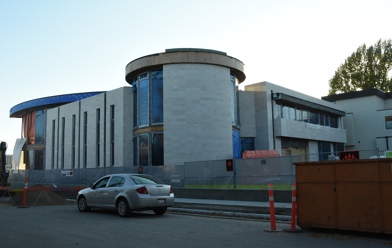

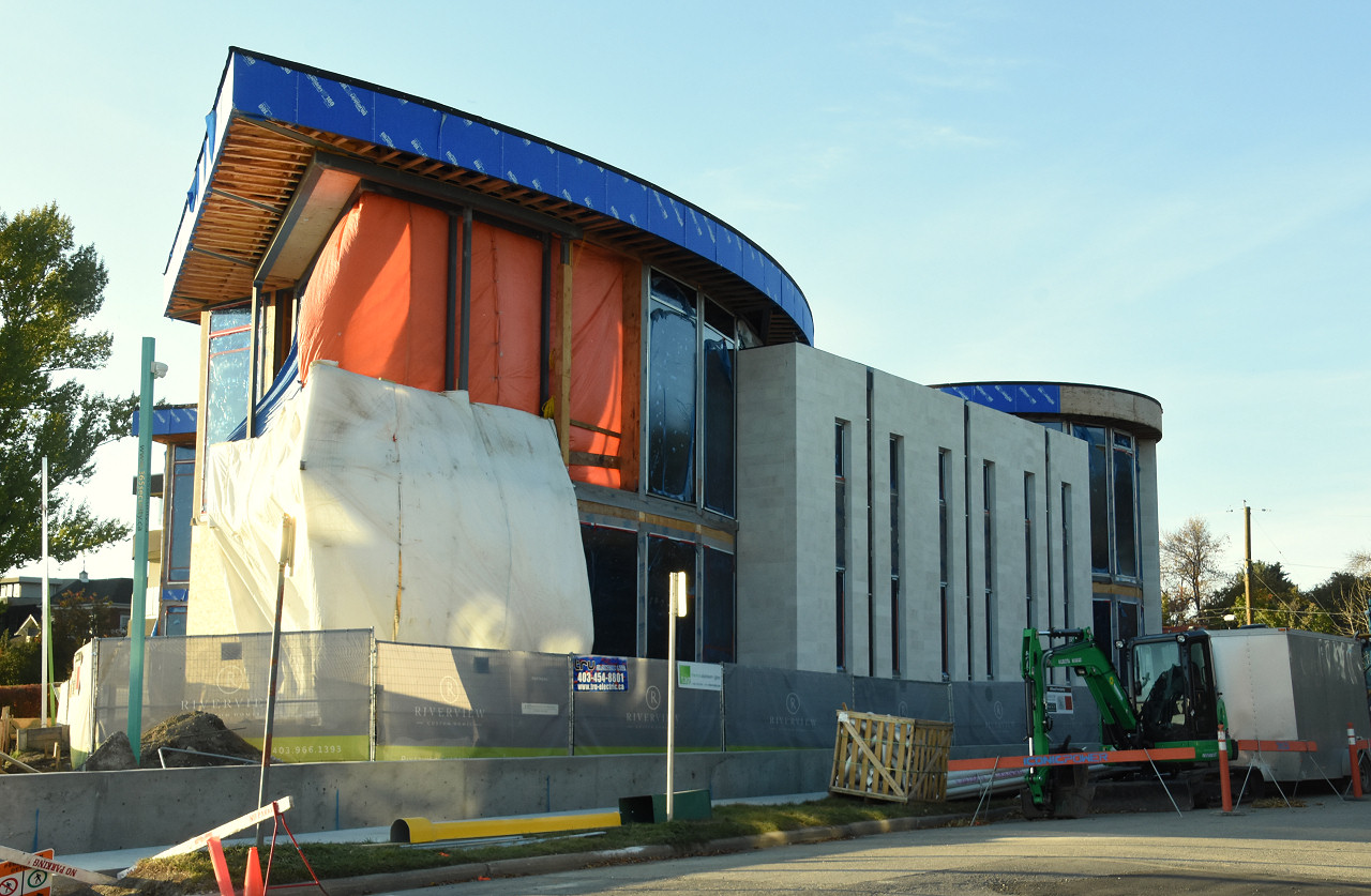

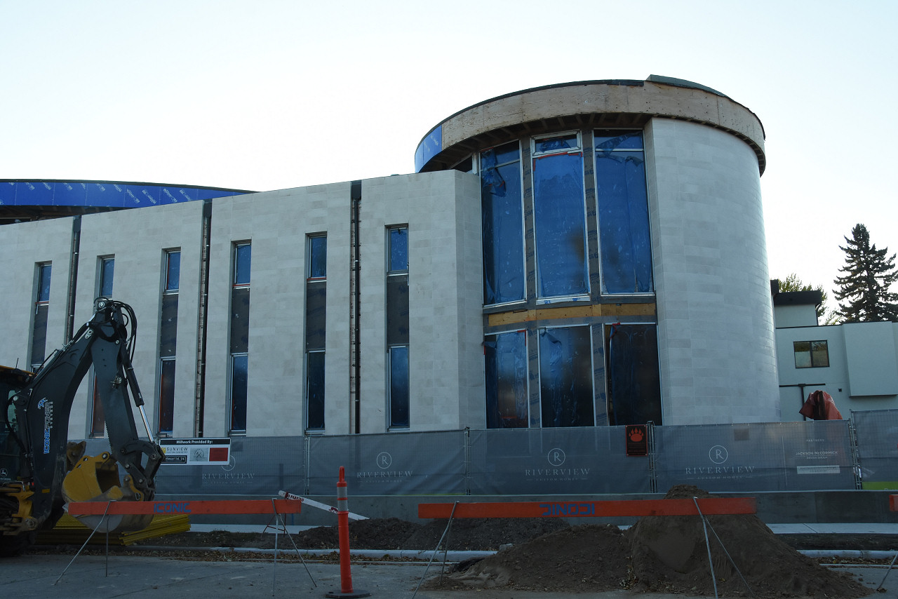

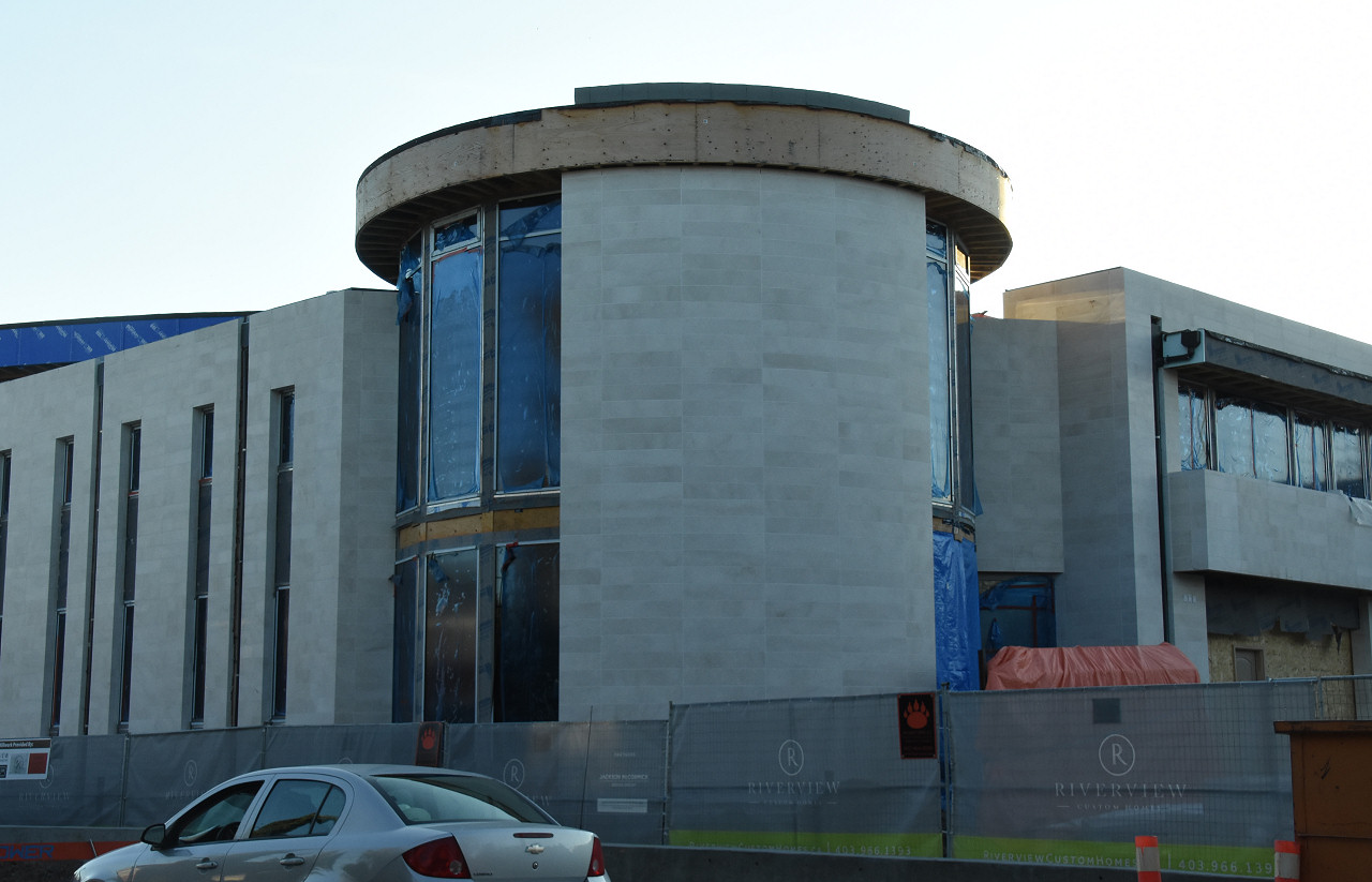

I don't know if this is the right thread for this. A huge house going up on Crescent Road. I usually don't post pics of houses, but it is different than the norm, a house looks like a Mormon temple.........that and it's all the rage at SSP so I figured I should get some pics of it.
