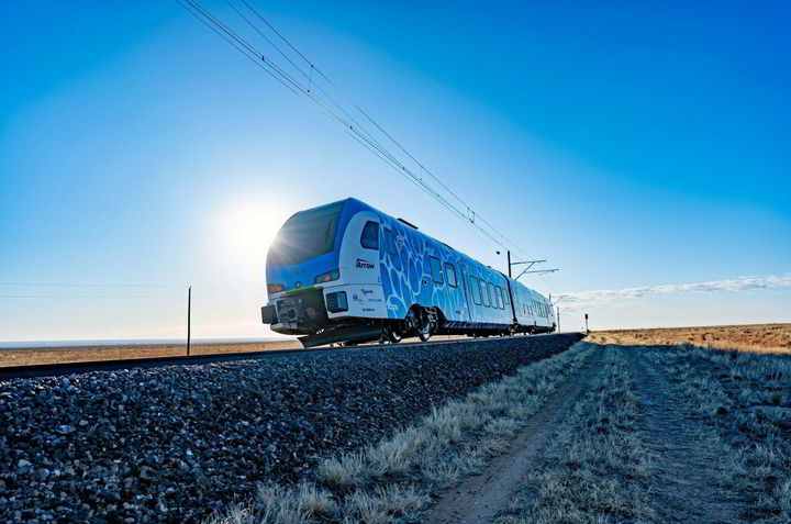

The Flirt H2 model, made by Swiss trainmaker Stadler, travelled 1,741 miles (2,803km) on a test track in Colorado, over the course of 46 hours on the evening of 20 March and throughout the night and following day.s
The train started the test with a full tank and did not refuel, with drivers from Stadler and Ensco taking it in turns to operate the machine throughout the world record attempt.
Stadler did not reveal any details of the size of the fuel cells fitted to the record-breaking train, however the Flirt H2 model supplied to the San Bernadino County Transportation Authority (SBCTA) in California this year — set to be the US’s first hydrogen train — is fitted with 12 fuel cells of 100kW each, implying an overall hydrogen powertrain of 1.2MW.
