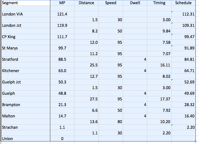

Here I go creating fantasy timings again.
I took the basic KW line, upgraded to 95 mph operation, and sacrificed the Georgetown and St Marys stops (which I would argue are generating very little business for VIA), and applied a slightly more conservative dwell factor than Urban Sky. I took some of the railway "unavoidables" into account - the approaches to both London and Union require some slow running for the first mile or two, the segment shared with RER may have some crossover activity, and Guelph may be insolvable. This gives one a baseline for a HFR operation with a very low capital investment required (well, it assumes the Bypass solves the Halton conflicts). The end-to-end running time is 112 minutes, even with stops - better than the southern route.
Now take the same route, upgrade the easy bits to 110 mph.... the shortest segments aren't worth upgrading because the train will decelerate so soon after exceeding 95 mph, so the time savings is small. Drop Brampton as a stop to gain a few minutes at higher speed and save one station's worth of dwell time. The best performance is now 98 minutes.
Those times are hugely competitive with driving. The Malton-London time is very appealing to air travel connections, provided a good shuttle bus is implemented.
The things I would point out are:
- this is a hugely low capital cost proposition overall. Why anyone - VIA, GO, PPP, whomever - would wait til after the Toronto-Quebec HFR is done to start work on this, I don't understand.
- if you look at how dwell time and stop spacing add minutes, you can see why this shouldn't be thought of as a GO line extension. You need limited stops to keep the end to end time attractive. The more stops you add, the less bang you get out of a higher top speed, because trains spend more of the distance at accelerating/decelerating speed. I like the ideal of GO running it at lower overhead (VIA, for instance, supports a complex reservation/ticketing system that isn't needed if you are running hourly trains with assured empty seats) but it is not a 12-car bilevel proposition.
- if you want to improve on this further, to a 120 mph or higher service, knock yourself out. You will spend a whole pile more money than this scenario. And you will have to answer to whatever additional towns you blow through without stopping.

You are confusing average and maximum speed: Even Ontario's HSR proposal only targeted a travel time of 71 minutes between Toronto and London, despite a design speed of 320 km/h. Even if using Euclidean distance (i.e. "as the crow flies"), the rail stations of London and Toronto are 169 km apart. In the case of Toronto and Windsor, it's 330 km, for which your projected travel time would equal to an average speed of 220 km/h or 110% of your design speed...

This time, you are confusing the maximum speed ever reached ("maximum speed") with the maximum operating speed ("cruising speed"): Before the latter is approved, the authorities demand overspeed journeys during which the targeted maximum speed is exceeded by at least 10%. The French started a tradition of modifying their trainsets for record trials, but both types of overspeed journeys are irrelevant when calculating travel times (e.g. the TGV may have reached 575 km/h in one such test, but its maximum operating speed is 320 km/h).
Even if I misread your quoted travel time for Toronto-Windsor as 90 instead of 120 minutes, the travel times you provided represent 90%-93% of the maximum operating speed (180-185 vs 200 km/h) if assuming the length of the current routes used by VIA (all routed via Brantford, not Kitchener) and still 83-85% of the maximum operating speed (165-171 km/h vs. 200 km/h) if assuming Euclidean distance. Have a look at fast rail services in Europe and you will see that their average speed rarely exceeds 75% of their maximum speed between any two stations, even when they have a dedicated HSR line the entire route.
That would get someone from London to Union in 70 minutes at max cruising speed allowing for slow downs near stations. GO rail may be more frequent than VIA but it would be significantly slower, they might as well stay with what they have got now. If the HSR is going to be successful and actually make a dent in traffic along the 401 then it must be significantly faster than driving.
The point you forget when making your travel time assumptions is that the maximum reachable speed is also determined by the infrastructure and especially the presence of curves and level crossings. In order to travel "at max cruising speed [while] allowing for slow downs near stations", you would need to build an entirely new greenfield alignment (point 10/10 on my list of the most cost-effective measures for improving average speeds), which is usually the point where you should go for significantly higher speeds as the incremental cost of doing so is not that high (at least not until you reach 250 km/h). In any case, diesel trains get incredibly inefficient in their energy use at high speeds and that is the reason why they (to the best of my knowledge) don't operate anywhere in the world beyond 200 km/h (125 mph).
If you want to know how to do better travel time estimates, have a look at Paul, who divides the line into different segments before allocating THOSE SEGMENTS with average speeds, while having no problem with admitting that his timings are still more theoretically than realistic:
Your timings are actually not far off my own model which yields 110 minutes for 95 mph and 104 minutes for 110 mph. I'm actually quite impressed given its "rule of thumbs" character...

Here's the point: (And this does overlap the VIA forum at this site) This debate is no longer about HSR in Ontario, it ain't gonna happen, but what has a very high likelihood of happening is HFR, and with it, The Missing Link. The Link is common to almost anything to do with passenger rail in Southern Ontario. It even has national implications...
And Ontario retirement funds have massive amounts of capital looking to 'come home' and grow at a steady albeit stable rate. And the future of rail infrastructure beyond the glacial pace it's happening now in this province lies with them. At $45 a shot one way for "commuters" to use HSR is a dream. Let them fly. The future is HFR, and the money is there to finance it, which is what D-S is hinting about as per (gist) "watch for developments in 2017".
I can only hope, trust and pray that Morneau, Garneau et al are in deep discussions right now on The Missing Link. Without The Link and HFR, there's virtually nothing of major consequence that I can see happening save for Metrolinx building more skyscraping monuments to the parking of the Almighty Automobile sucking good money out of real transit options to do it.
