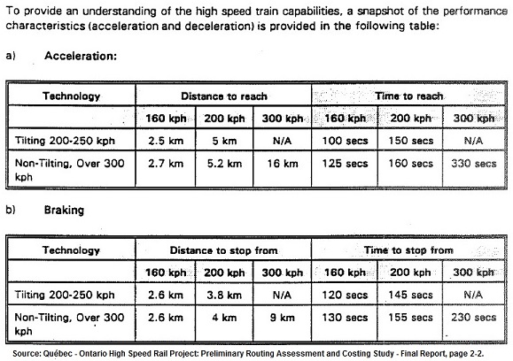

I always struggled to calculate realistic travel times until I found this table in the 1995 Quebec-Ontario High-Speed Rail Project Study (QOHSRPS):
Thanks to this table I could finally approximate realistic acceleration and deceleration values (derived from the acceleration and braking distances and times for the "Non-tilting" train) to use in my Bachelor thesis (and in all timetable calculations I post in this forum). However, for reasons of simplicity, I will just take the values provided in the table above and use these values in the table below (values used from the table above are highlighted in gray, all other values are either set [i.e. "Max speed" and "distance"] or calculated):
Therefore, I admit that 23 (71-48) minutes are possible, but only if you assume that the line is built as an 80.3 km long straight line between London and Kitchener rail stations. You don't even need to add timetable buffers and a standing time of 60 seconds in Kitchener to get an idea of Liberal best-case scenario planning.
However, in case you want a more realistic estimate, I tried to simulate the travel time for the route dunkalunk posted in Post 157 and got a travel time of almost 28 minutes (equaling an average speed of 187.2 km/h over a distance of 85.8 km):
Those braking distances seem really conservative, especially the 160-0 distance. I can tell you as a matter of fact a GO train can stop from 93mph(150kph - top speed) in approx. 0.75 miles(1.20 km). That is however using a very heavy brake application, something the chart referenced doesn't define. But even with a more typical/normal level of braking, 150kph to 0 is can easily be accomplished in 1.0-1.1 miles(1.61-1.77 km). Of course GO trains are specifically tuned to have superior braking capabilities, at least vs current inter-city VIA trains due to the need for frequent stopping. I can't say how exactly high speed trains would compare since I don't have any experience operated them, though hopefully one day I will! :) They of course employe a different kind of braking system, one that relys far less on friction braking if at all. The charts 160kph to 0 braking distance/time seems almost accurate for a VIA train. But I'm certain that any future high speed trains the province purchases will have better braking abilities then the current VIA trains, some of which are absolutely atrocious, especially those "tin cans" :eek:!
So what would be the correct braking and acceleration times for a high speed train? Wish I could be of more help but all I can say is that as a train operator myself I find the 160-0 distance seems very long. The only other information I can provided is that which you've probably already found yourself or can easily find on the internet. The following link for example indicates a braking distance of 7.2km and 170 seconds from 300kph for the typical French, German and Japanese trains. http://www.railway-technical.com/Infopaper 3 High Speed Line Capacity v3.pdf
While in the end it doesn't make a significant difference time wise considering the limited number of stops, its still something to perhaps consider.
