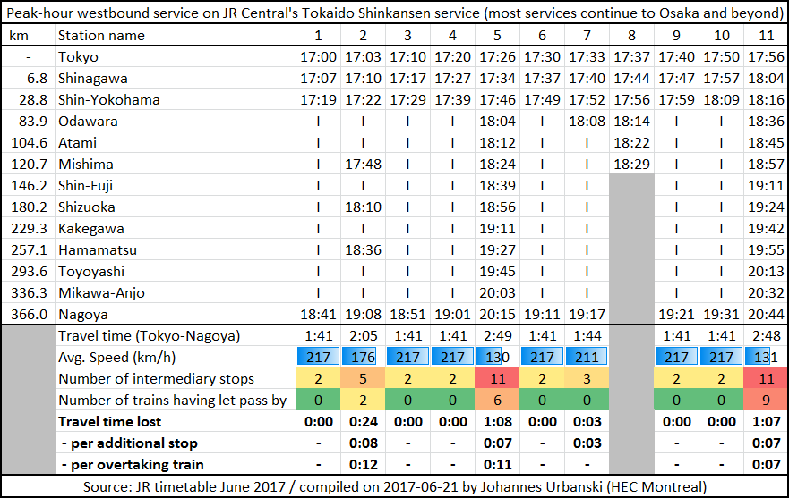

In case you suddenly decide to adopt the informed and fact-based (or at least: -acknowledging) discussion style normally cultivated in this forum: In countries like Japan, trains loose only 3-8 minutes per additional stop, despite being frequently overtaken by faster trains at these intermediate stations. Note that even the Kodama milkrun service (trains 5 and 11 in the table below) offers Tokyo-Shizuoka (same distance as Toronto-London) in 88 minutes and Tokyo-Nagoya in 168 minutes (same distance as Toronto-Windsor) - still a travel saving of 40 and 68 minutes (or 31-32%), respectively, compared with the fastest VIA timings today...
Source: JR Central westbound Shinkansen timetable

Yes, sure, and (once we are at it) why not extend your HSR proposal to Chicago while skipping Detroit (stops in Windsor and Ann Arbor will do), since population figures apparently don't matter when planning HSR lines and services? I have already provided a detailed analysis of the two different corridors (including a variant with the Brantford cutoff you are referring to) almost 3 years ago, while I am still waiting for anything from your side beyond uninformed and fact-ignoring speculation...
Once a route is electrified, the rate of expected acceleration and deceleration is pretty much doubled, sometimes more, over diesel. The 'time penalty' for in-between stops is still a concern, but much less of one than before. The advantage will be enjoyed by HFR, RER and even some freight services if hauled by electric locos over some electrified routes.

Nice layering - nearly subway-style frequency on express Shinkansens, hourly on semiexpress Shinkansens, and half-hourly milk run Shinkansens.
thats a gold standard of commuter and express rail. There really is no equal in the world when it comes to rail travel
