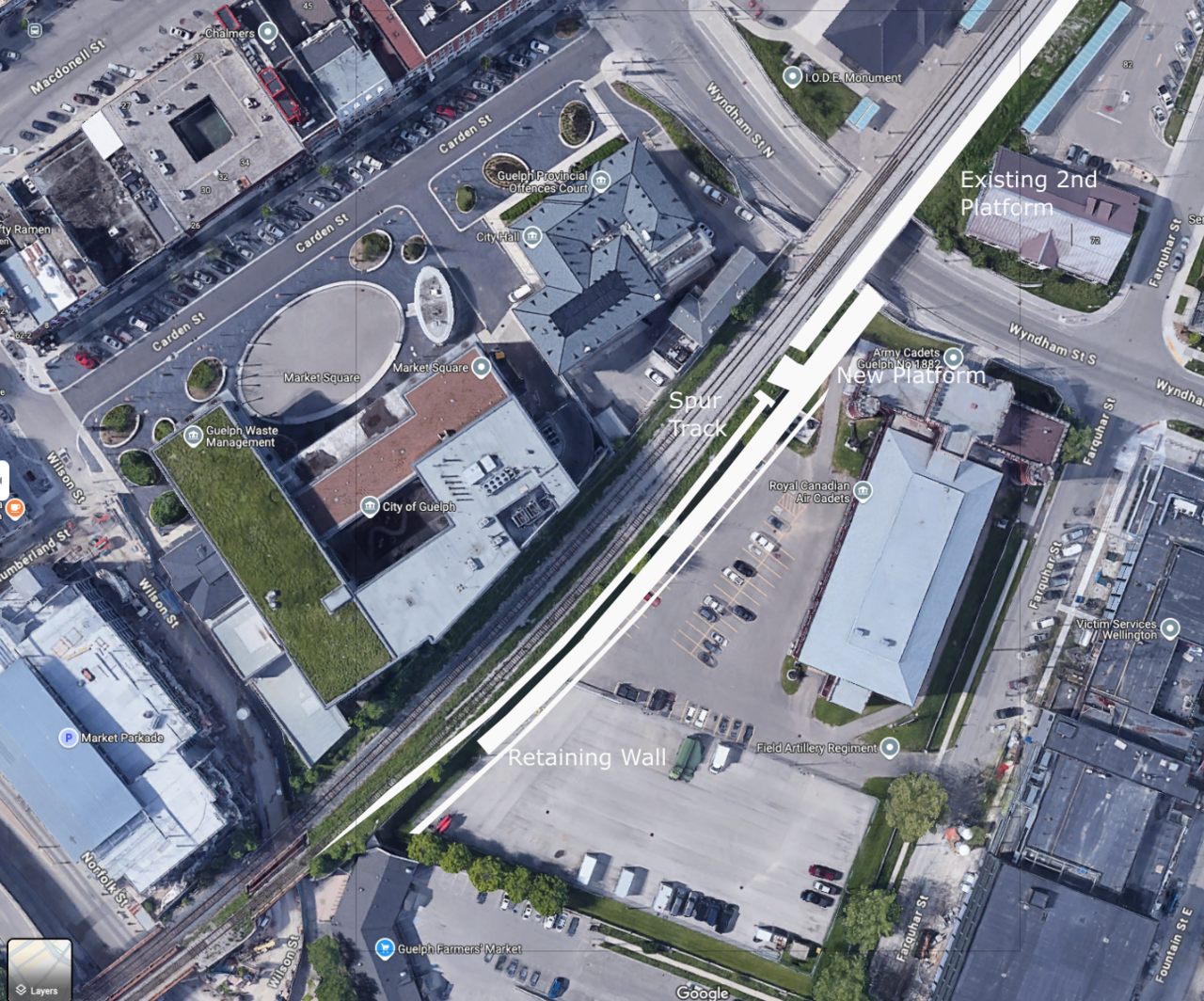

Would it not be possible to have a small siding, capable of holding one 2 or 3 car DMU? A retaining wall would be needed and a connection to the new (currently unused) southside platform. The Wynham bridge (nor any other bridge) would not need to be widened. Also a storage siding could be easily accomodated between Alma and Edinburgh, furher West in case a train needed to be stored for whatever reason.... The only downside is if the service wanted to ever use larger trains, this scenario would not work...
It looks like that might be feasible but it looks like it would be less convenient and more expensive than building a tailtrack east of the station.

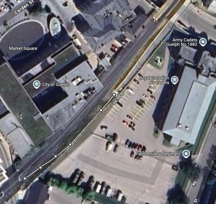

The main issue with the design is the transfer distance between the westbound train and the DMU. If you get off the east end of a westbound train, you need to walk up to 400 metres, including an elevator and a long ramp. And the distance from the east end of the bus terminal is even more.
Such a long transfer distance means that there needs to be a long transfer time from westbound GO trains to the DMU that is always provided even if the GO train is late, to accommodate people with limited mobility. Longer transfer times make the connecting service less time-competitive, and the long transfer distance is physically exhausting, especially for more elderly passengers, which also makes the service far less attractive than a same-platform transfer.
So while it may be technically possible, it would provide a significantly worse passenger experience and would be more expensive than building a trailtrack east of the station.
The construction cost would be much greater than the tailtrack option due to the significant regrading and retaining wall required. The existing eastbound platform actually extends much further west than you've shown, which precludes the illustrated design due to the short distance to the Wilson St bridge.
