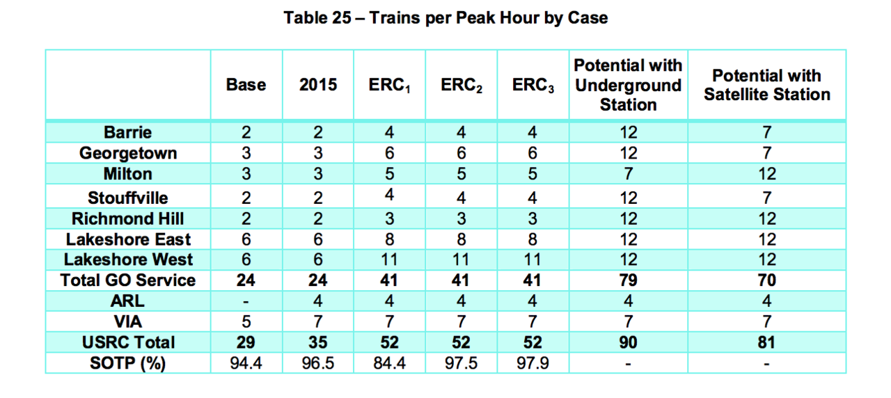

do you or does anyone else know what the theoretically maximum number of GO trains and/or commuters Union station could handle per hour if fully optimized?
that's with wider platforms, through running, a new signal system and a new fleet for GO etc...
I've read a couple of different yet conflicting reports on this topic, so if someone more knowledgable than me could chime in I would appreciated it.

I guess I'm answering my own question here, but here's a table with various scenarios from a study.
Barrie + Richmond Hill (through service) = 12 trains per hour per direction
Kitchener + Stouffville (through service) = 12 trains per hour per direction
Lakeshore East + West (tunnelled through service) = 12 trains per hour per direction
Milton = 7 trains per hour per direction
UPX = 4 trains per hour per direction
VIA = 7 trains per hour
I don't know these estimates seem low to me, especially considering the Lakeshores Lines would be underground in this model. I guess this is the best case scenario though as far as I can tell.
