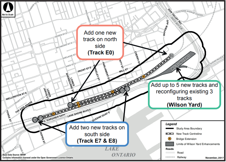

What is Metrolinx referring to as Wilson Yard? It's somewhere near Don Yard, east of Union from context. But I'm scratching my head. Is it just a reference to the 3 old tracks south of the Don Yard?
South of the Don Yard
Hopefully the yard gets renamed afterwards! Not very well known under that name.
Gosh, I wasn't aware of that plan ... with all that extra storage, it does make the controversial one additional storage space up the Don Valley near Bloor seem unnecessary. You'd think it simpler to squeeze one extra spot in this very uncontroversial area.
^ I think part of the issue is where the Wilson Yard is located vs the Richmond Hill Layover in the Don Valley. Wilson's on the south side of the existing tracks and Richmond Hill is on the north side. If you look through the material for the Union Station Rail Corridor East Project, the location difference matters. They want to reduce crossover movements and have certain needs for cycling certain lines. See slide 13 here from this site.
In other words, the Richmond Hill Layover being located on the north side may strategically benefit the Richmond Hill and Barrie Lines since they branch out from the north sides.
The Richmond Hill Layover also might be needed now because they aren't going to extend track E0 after hearing concerns from local residents who live along the track. This is speculation on my part. @smallspy or @crs1026 may have a view.
The land used for these layovers is prime land. It may not be that valuable now but in 20 years it will be. It might be a good idea to build over these layovers like Hudson Yards. I am sure no one will spend money to build a park over them so I am fine with buildings.
