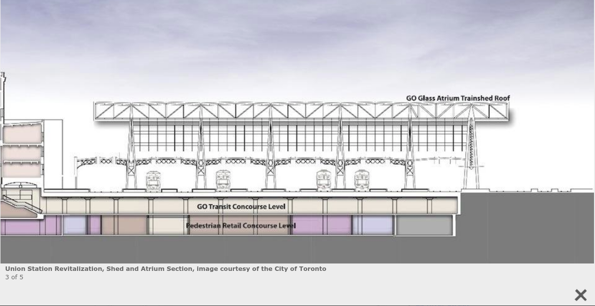

This drawing corresponds to what I remember the engineering drawings being as per track support columns:
http://urbantoronto.ca/news/2012/08/cityrail-depth-union-station
I have access to some of the engineering drawings of the property. While that diagram gives a decent representation of what the arrangement is underneath the trainshed, the reality is that it is a very, very busy space in terms of structure.
If you are walking around underneath in the concourses the quick summary is - round columns hold up the track, square columns hold up the trainshed. And you'll notice that the round ones are far denser and more common.
Dan
It is just a representative drawing, agreed. But I have seen an engineering discussion somewhere that detailed the pillars as being directly under each track, and what was involved in 'underpinning' them...the inference being that they didn't go down to bedrock. If that latter point was in fact the case (and this is all built on fill south of Esplanade) I'd have to question the engineering, or the written history of what actually was/is the case, as the continental steam locos especially would have pounded those pillars into soft ground.

What I can state with just the 'working diagrams' I've come across is that moving tracks isn't an option without massive infrastructure trussing. Leaving the wanted tracks in place and platform decking over where the unwanted ones are is a simple and effective option.

Also visible in this drawing is a stair up to the moat level from the mezzanine level of the station. This design predates the “dig down” plans for the GO concourse. The new lower concourse will be on the same level as the subway mezzanine with a straight access through a lowered moat between the two areas.
Note also that there is a sewer under the moat. This must be lowered to permit the direct access across the moat.

The reason the columns are lager for the round ones was due to the fact that the existing ones were off set from each one that were out of sight. To give a clean row alignment, each column increased in size. Some columns weren't plum as well.
Now this is interesting info! That some weren't plumb might only be part of a much larger story. lol..now I'm really intrigued. 'Encasement' is usually to increase the 'footprint', which is what I assumed was the case for this reno. Vertical stability and alignment hadn't occurred to me. Some engineering mag must have a write-up on this...
I'd also be interested to know if the tracks are 'floated' on those pillars, or if the building superstructure is bound into them too? As well as mechanical consequences, it would also affect the degree of 'pounding' transmitted to the building proper. Think subway stations with a track level above you. It can be deafening with a train rolling above you, let alone put massive stress on rigid structures.
No, the round ones are larger because they need to deal with far greater loading than the ones holding the trainshed do. It has nothing to do with aesthetics.
A train is a far bigger point load - especially once you factor in the live load of a steam locomotive - than a simple steel truss and a wooden structure above it.
