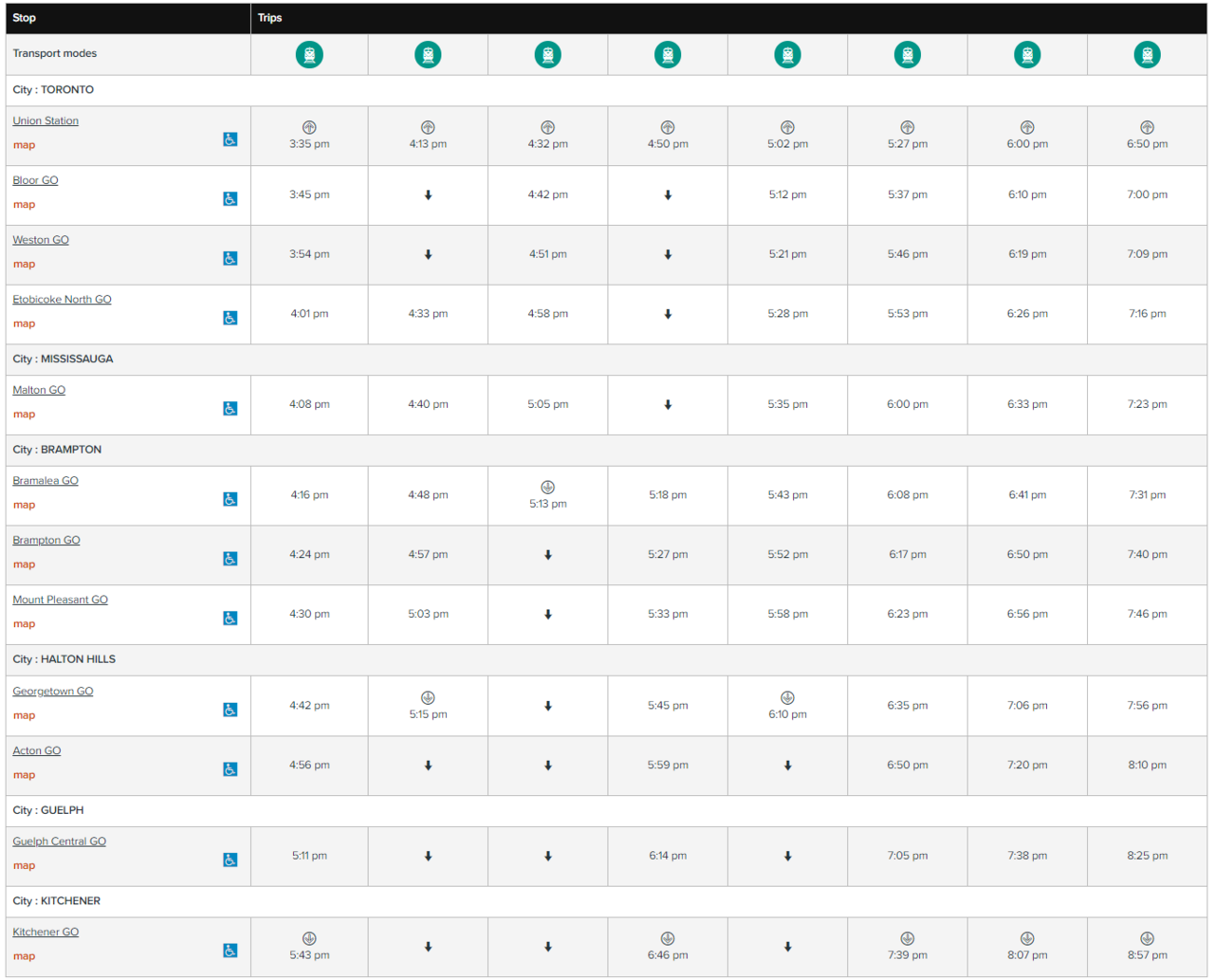

Not surprisingly, the 4:35 pm ,moves to 4:32 and terminates at Bramalea. In other changes, the 4:04 pm will leave at 4:13 but run express to Etobicoke North and the 5:02 will (not surprisingly) be shortened to Georgetown.
Unfortunately, there doesn't seem to be any extra run of that Bramalea terminating train after 5:13 - it would have been a useful return back to Union replacing some bus services.

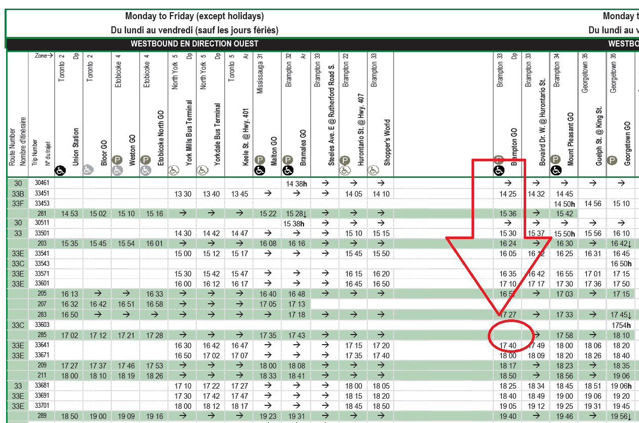

Amazingly, there's a big typo on it, showing that the 17:02 train no longer stops in Brampton. Hard to believe that they didn't even bother to proof the Brampton afternoon stops on this.
(the online schedules show the stop, so just a typo ... but good grief - this is surely the first place any Brampton rider, who caused the uproar - will look)
I'm still waiting for the Barrie PDF to be updated from January's changes.
I tweeted @GOTransit for correction to both the Barrie and RH schedules. RH is updated, but Barrie still shows a weekday 65C (introduced as "weekend only") 1 minute after a southbound train departs. (The schedule shows it arriving 8 minutes before the train...maybe a new express service if you don't mind gambling on the DVP???) The new Friday-only 68C aren't properly represented on the schedule either.
Your sentence structure makes it appear like you are saying only people who use the Brampton stop were in an uproar. I think the uproar was from people throughout Brampton whichever of the 3 stations they use ?
But, yes, it seems they don’t proofread much before they put it out!

Another interesting piece is that the truncated 16:32 trip will now use the long-disused south platform at Bramalea:
https://www.gotransit.com/en/trip-planning/go-service-updates/train-schedule-changes
The 4:32 p.m. trip to Bramalea GO will arrive on a temporary platform on the south side of the station, which has no elevator access to the north side of the station. If you need to use an elevator, do not take this train to Bramalea.
There will be door restrictions at Bramalea station due to construction. Please listen to announcements on your train.
It's the only train all day to use this platform, so it has all the time in the world to sit and wait for an appropriate gap in train traffic to head east. It seems like a missed opportunity to have it run as a deadhead rather than a counter-peak express - it would be super helpful for people making connections at Bramalea, such as people coming in on Route 30 from Kitchener.

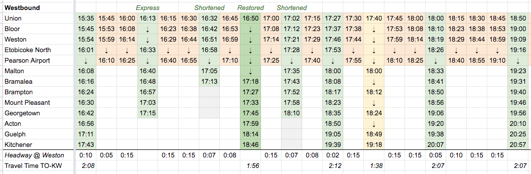

Here's my consolidation of the new GO, UP and VIA schedules for the PM Peak, highlighting the changes:
