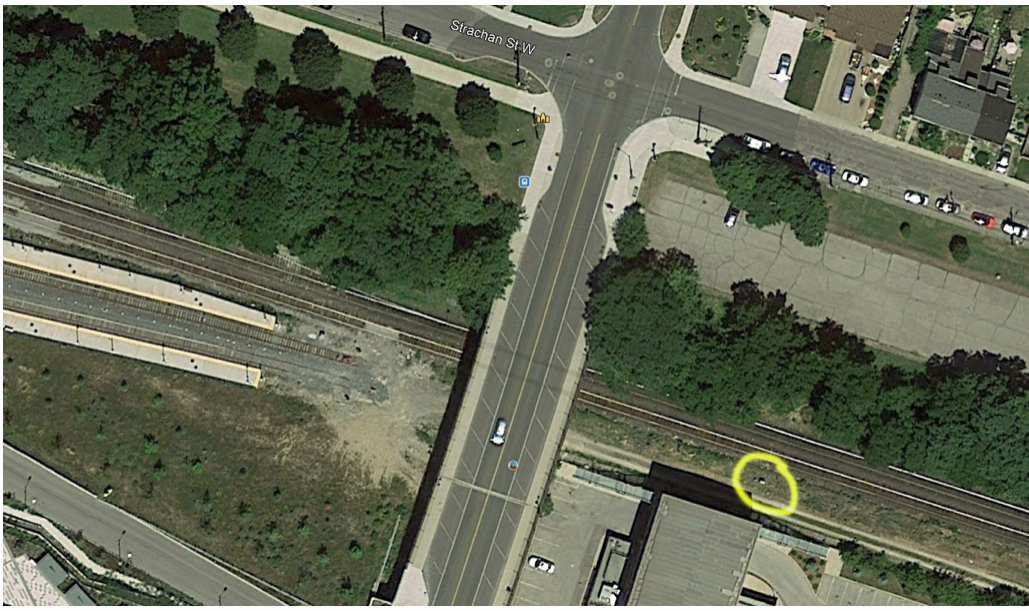

Well, for starters, there's buried utilities that have to be moved (note yellow circle)....

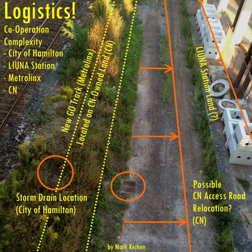

To refamiliarize, I've written a fairly large article about this in year 2015.
See my writings at www.raisethehammer.org/article/2720
Also, in my most recent visit to a GO Niagara public information centre, I learned that the ground in this area is about 2 meters higher than the track at West Harbour GO, so a lot of regrading needs to be done. So it's an expensive endeavour even to just add a spur.
It has to be done, in order to connect West Harbour to Confederation -- although Metrolinx has been wanting to install continuous track all the way between West Harbour and Confederation, including new rail overpass (Birch Ave...). But there should be a switch near West Harbour regardless.

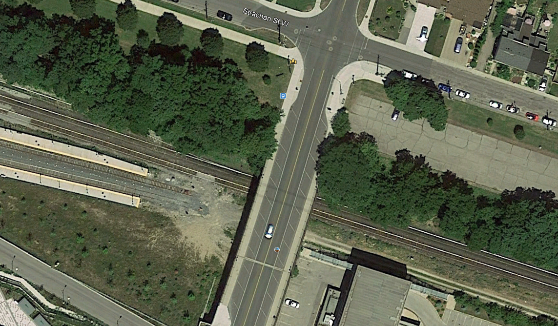

See that thing labelled "Signal Mast"? It's the western limit of a second interlocking - CN Hamilton (that's why the station name sign is there). Very unlikely that CN would build one interlocking so close to the next. More likely that CN would want the whole interlocking rebuilt as a single piece of plant. And, if a new track for GO is in the works, then the trackwork would have to leave room for a switch merging the two platform tracks, and then a crossover from the new track over to the existing mainline track. Etc, etc. More like 200m of track.
Quite doable, but a little more complicated to design and build.
PS: The thing marked "Equipment" is tied to underground utilities, with buried cables or ducts - as the vertical red marker signs also indicate. Those would likely have to be dug up and moved.
