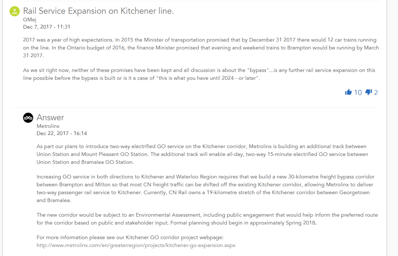

Freight bypass (Missing Link).
CN has plenty of capacity between Bramalea and Mount Pleasant to accommodate hourly GO service at all times as well as their existing freights.
Ten years ago, Brampton Station had one platform, and there was a single-track section between Union Street (east of Brampton GO) and Kennedy Road. That suited CN's needs just fine. Now that has been widened to two tracks, with a third track laid between McMurchy Avenue (west of Brampton GO) and Mount Pleasant, and between Kennedy Road and Bramalea, giving CN the same capacity as before if GO takes the southern track, suitable for hourly service, and CN is being difficult here.
While the missing link is needed for anything beyond hourly service, and the province's plans for high speed rail to Kitchener and London, it's not needed for simple evening and weekend service.
yet, strangely, the answer to what will bring any additional service to the line is an additional track from Union all the way to Mt. Pleasant....that, it seems, gets more service to Bramalea.....
And since CN don't seem willing to let anything happen between (just east of ) Bramalea and Georgetown until the bypass is built....have they just acknowledged there will be no service additions until the bypass is built....or have I mis-read Metrolinx speak?

^ From CN's perspective, even if there is technically capacity, maybe they aren't interested in a disruption to their flexibility and ability to handle spikes in demand? Capacity could be a moving target? Ironically, on the same day they responded to your question, this article appeared. They've never publicly commented (or the media hasn't directly asked them) as far as I can tell specifically what they want, need, capacity, or approach. I'm trying to think of a parallel in another industry/sector where there's a public interest in a private thing/site/etc.
Metrolinx speak or not, that's likely the conclusion and answer: the chances are low. As has been pointed out, now that a permanent bigger solution is on the table, the incentive may be lower for interm options. Not saying I agree with that or aren't disappointed, but just trying to be realistic. Unless a different government after June 2018 can do something different/get a different result/negotiate something that hasn't happened yet.
