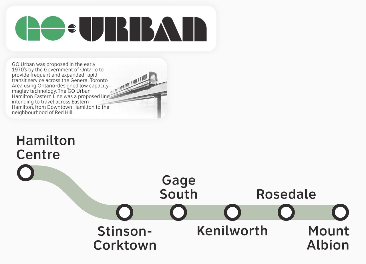

Not sure if this is truly the right thread for this, but I went down to the Reference Library to get some materials on GO ALRT and thought you guys might like to see some of it (I took the photos with my phone so the quality may not be super good on some images). I'll start with photos from outside of Hamilton (there's a lot of Hamilton related things). Part 1:
