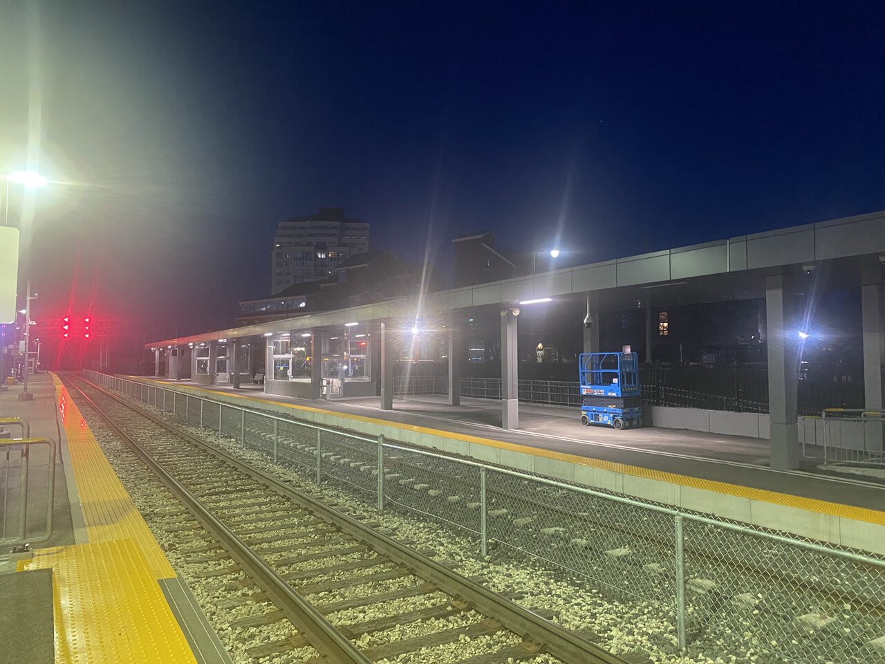

Guelph Central Station. Would be nice to use that new platform, any day now.....
