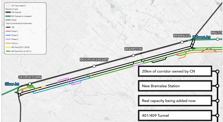

And, mentioned here months ago, the design for a third platform at the Brampton Station was been awarded to HDR. Apparently, CN is designing the track. This is definitely a pinch point.
The City of Brampton did some high-level visuals of what the third track would look like. I'll post them in a separate post.

Looking at this image, I see a lot of phase work that sort of adds track all the way to Silver Junction. Is it fair to say that this track would be in the hands of Metrolinx to run as many trains as they like? I say this as I see green, pink and blue track nearly all the way to Silver. It's probably not that simple, and I'm sure CN will still have a lot of control of this part of the sub.
