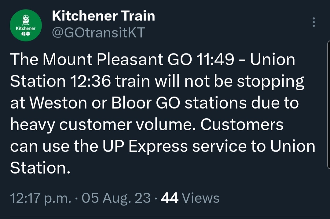

How much do you wanna bet 80% of this "customer volume" are really just bikes stacked one against another in the way of each car door. This is getting ridiculous and there's an obvious fix but they don't want to engage in improving the service.
